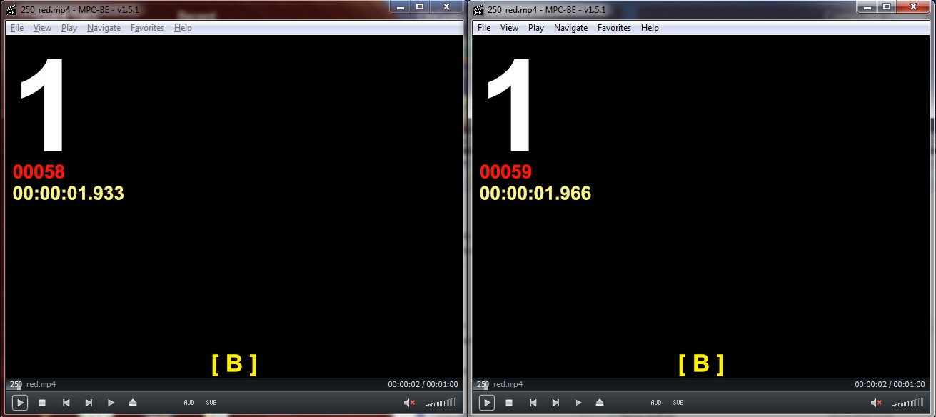

    I use FFMpeg and re-encode segment from B or P frame up to the next Key Frame (I) E.G.
    Frame 0-49 IBBBPBBBP- GLITCH - PBBBPBBBPIBBBPBBBPBBBPBBBPI <--Bad Copy
    Frame 0-49 IBBBPBBBPBBBPBBBPBBBPBBBPBBBPIBBBPBBBPBBBPBBBPI <--Good Copy
    Frame 0-49 IBBBPBBBP<-Re-encode------------->IBBBPBBBPBBBPBBBPI < Cut Sections 1, 2, 3
    Frame 0-49 I-CopiedBP|I-yyyyyyyyyyyyyyyyyyy-|I-CopiedBPBBBPBBBP-I < merged segments.
    I know this is time consuming but it works and I do it a lot since I am not in a hurry most times and can watch an hour movie with 2 shuttles to move frames back and forth with multiple players.

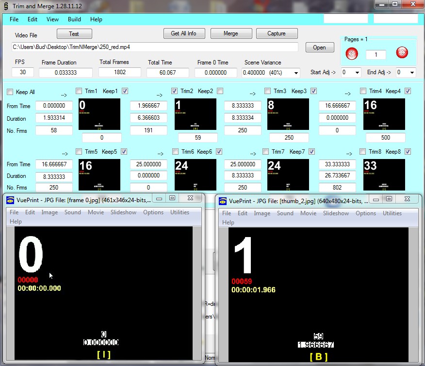

    [Attachment 49819 - Click to enlarge]

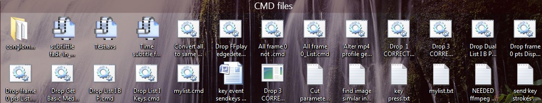

    I use script for most everything. (Also am in middle of Creating A utility for this.) The below example, a GOP 250 (I-Frame every 250 frames) shows 'KEEP' checked for frames 0-58 (copied), 'TRIM check for Frames 59-249 (Re-encoded), All segments after that are consecutive 'KEEP' checks they they will all be copied as 1 segment. Then the 3 segments will be merged.
    I hope this example is useful, but bear in mind Most editors will not cut at frame accurate so there may still be glitches or replays of a quick segment. This can be eliminated Easily with AVC and FFMpeg but FLV use a slightly different algorithm to cut precisely with FFMpeg.
    [Attachment 49820 - Click to enlarge]

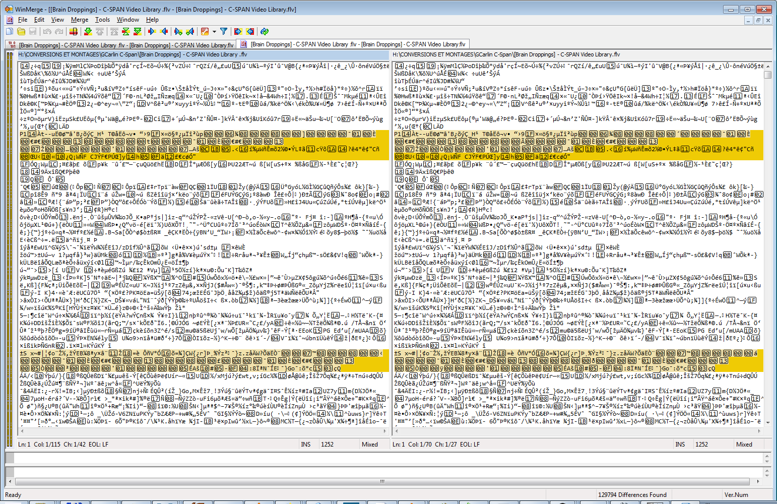

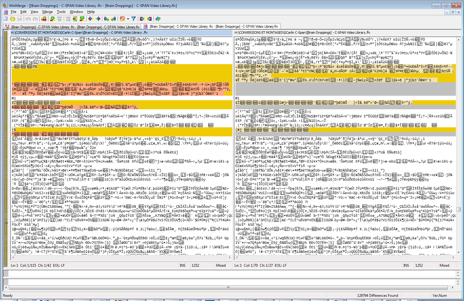

    In WinMerge it looks... more complicated (see below).

    I'm not sure if / how it can be done that way, because (other than being quite resource-intensive – with this recent computer based on an Intel i7 6700K with 16GB of RAM WinMerge can go through with the analysis, by maxing out one CPU core and allocating 2-3GB of RAM, but with my former machine based on a Dual Core E5200 with 4GB of total RAM it failed miserably, hence why this task was stalled for so long) the output looks seriously messy : there are identical sections, missing sections, but also many sections which are slightly or vastly different – this may correspond to what Budman1 described as “minute changes in stream, hesitation points”. And there are a lot of different sections, as evidenced by the amount of orange in the left column. Wouldn't it cause inconsistencies, resulting in playback issues, if I simply copied everything that is either different or missing from one file to another ? And there are five of them, all with differences at different spots... And in accordance with Murphy's Law, there are most likely many such chunks which are found in neither of them.

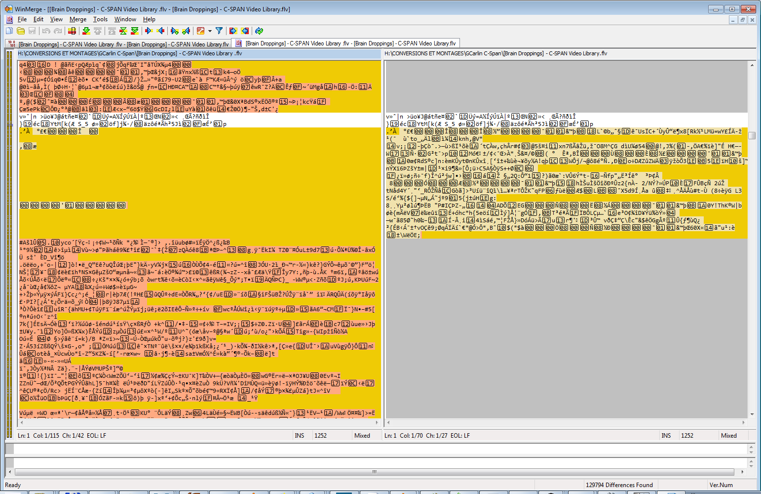

    Here are three screencaps :
Name:	[Brain Droppings] - C-SPAN Video Library WinMerge 1.png
Name:	[Brain Droppings] - C-SPAN Video Library WinMerge 2.png
Name:	[Brain Droppings] - C-SPAN Video Library WinMerge 3.png

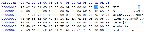

    BTW... FLV always start the same way FLV.........0x12 for Script data, 0x09 for video and 0x08 for audio. Youcan remove bytes 0x12 up x09 or 09 to 09 and video will still play although you lose data toSee Below

    Okay the only way to be sure to get all the video is to have a video with, say Carlin face from frame 0->70, zoom out Frame 71-199, Front face again 200-500.
    Now assuming each scene change starts with a Key Frame 'I' type. If you were missing frames 71-199, then you would just find a copy of the video with a good frame sequence 71-199 and copy it to the first video.
    The more likely scenario is that your streaming glitched between Frames 58 and 75. That means you need to have good frames 58-75 in another copy of the video. And since Frame 58 is not a Key frame it will have to be encoded up to Frame 70 and then copy and add frames 71-199. Now you would have key frames at 0 (Original start) and 58 (because of the encode) and 71 (original Scene change Key frame and 200 (Original 3rd segment Key frame) This is where the 'Shuttle' comes in.
    [Attachment 49833 - Click to enlarge]

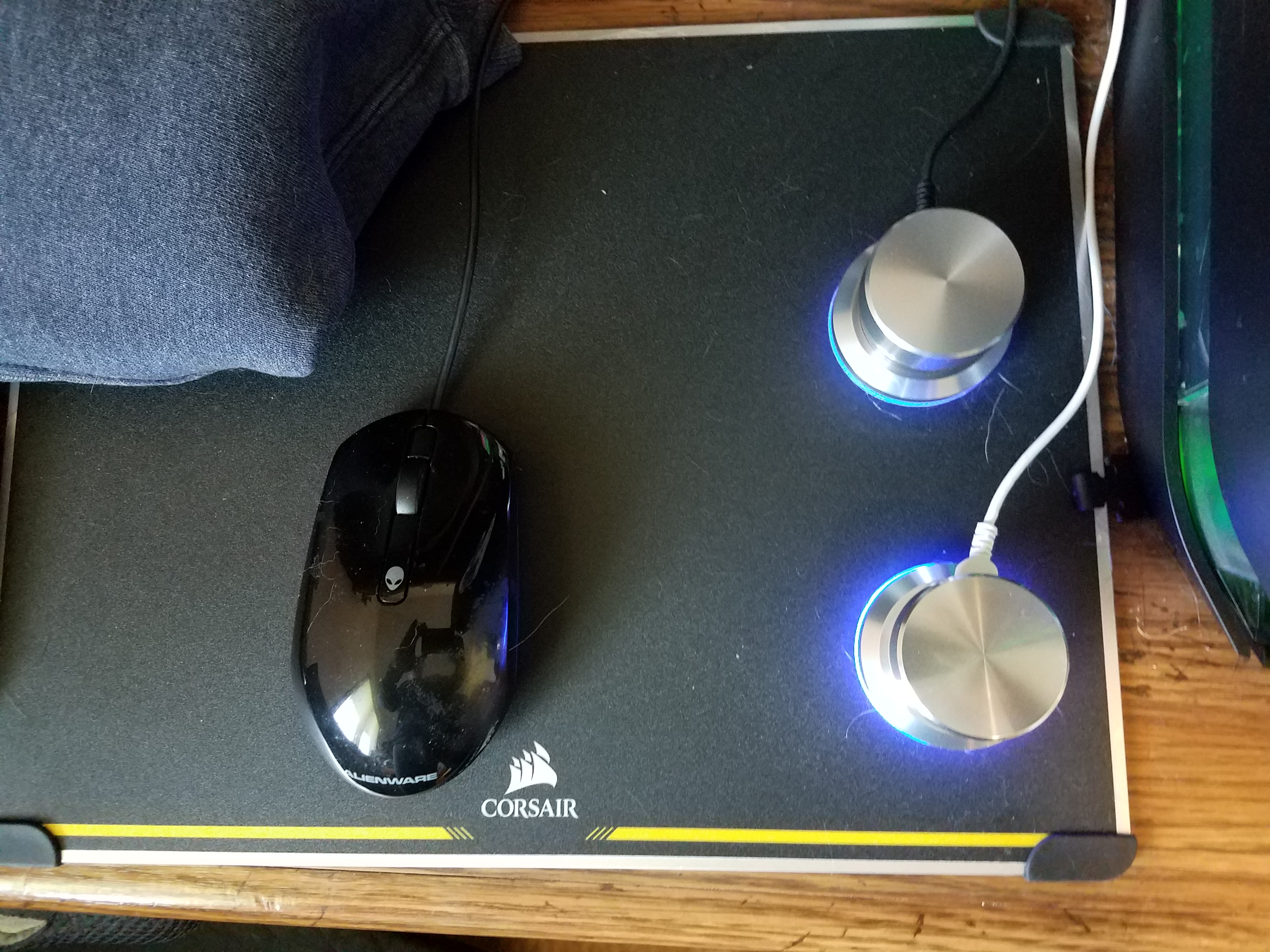

    It is a device to basically step forward and back or whatever you program it for for many programs. I have the 2 because they have left, right, Depress, Depress+left, Depress+right, and Long Depress. There are others with more function but with only 6 functions, one shuttle eats up Short jump, medium jump, and long jump both forward and back for 6 functions all by itself. I bought 2, Mainly because if I bought another with more functions, the original one would be wasted and my wife wouldn't go for that. (I did make her believe I needed 2 though, LOL)

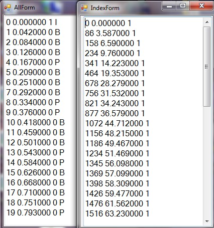

    [Attachment 49834 - Click to enlarge]
    2. Play one video with shuttle and find glitch. (We'll assume frame 58)
    3. Checking list I find 55 2.294000 0 P
    53 2.211000 0 B
    54 2.253000 0 B
    55 2.294000 0 P
    56 2.336000 0 B
    57 2.378000 0 B
    58 2.420000 0 B
    59 2.461000 0 P
    60 2.503000 0 B
    61 2.545000 0 B
    62 2.586000 0 B
    B frames can not be left at the end of a segment because they are the difference between frame before and frame after (B as in both directions). Frame 55 must be at the end of the first segment because it is still ok in the original and it is the last good 'P' frame (P as in Preceding) before the glitch, comparing its difference with the preceding frame.

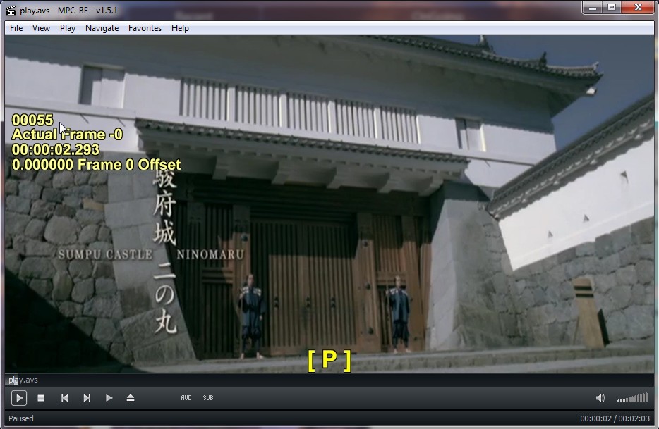

    4. Find that frame 55 in original video using a script and avisynth FFMS2 filter.
    ffmpegsource2("C:\Users\Bud\Desktop\[dp]Manjandani-1.mp4", atrack=-1)
    x = float(Width) / float(Height)
    last.LanczosResize(round(x * 480.0 / 4.0) * 4, 480)
    ShowFrameNumber(scroll=true, x=10, y=127, font="Arial", size=24, text_color=$ffff80)
    Subtitle("Actual Frame -0", x=10, y=128, font="Arial", size=24, text_color=$ffff80)
    ShowTime(offset_f=0,x=72, y=169, font="Arial", size=24, text_color=$ffff80)
    Subtitle("0.000000 Frame 0 Offset", x=10, y=171, font="Arial", size=24, text_color=$ffff80)
    ScriptClip(Last, """Subtitle("[ "+Chr(FFPICT_TYPE)+" ]", size=(Height*56.0/720), align=2)""", after_frame=true)
    [Attachment 49835 - Click to enlarge]

    It seems complicated and I hope this helps but it is not that hard and can be done with CMD drag and drop or batch mode
    [Attachment 49838 - Click to enlarge]

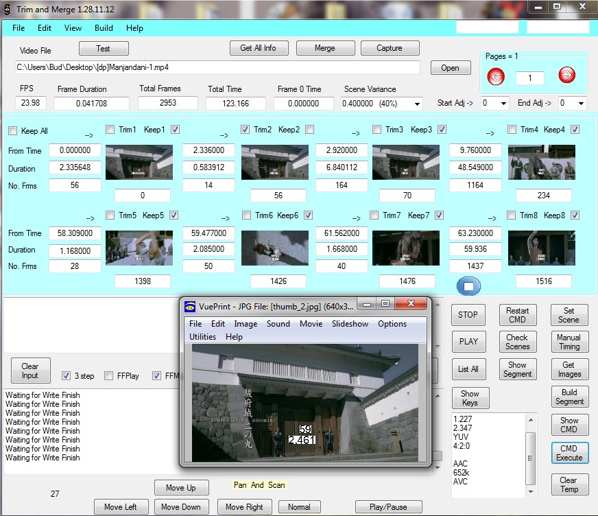

    I cheat with my program. It gives an idea of the above scenario. Trim means re-encode, keep means copy. So 0-55 copied, 56-70 is Encoded, 71-end of file is copied.
    Then just merge or join the 3 segments by any of many programs. I use ffmpeg to merge.
    [Attachment 49840 - Click to enlarge]

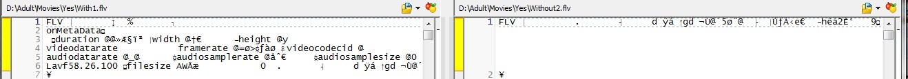

    Comparing gives the example above of Exam Diff, which says nothing of what frame, time or anything and as I pointed out, just trying to copy data would not work unless you had a program that copied on a byte basis and if the glitch happens to be in the middle of a byte, you would never know just looking a the last good 'byte/half byte'.
    Example... last 'good' byte of glitched video shows 81, 9F B0. The good video shows 81, 9F, B8. Do you replace B0 with BF? And I know of no programs (Free anyway) that will copy videos on a byte basis. Most are based on a frame or time point and copying from a time not a key frame gives many results that are nasty to play. Everyone knows you have to cut on a key frame or re-encode but there are virtually none that explain how to cut exactly at the key frame and result in a PTS-DTS time of 0.00000. It can be done fairly easily (at least from my point of view) and byte by byte could be done but would take a specially written program that took a list of cut point and copied byte by byte, IF you know the points.
