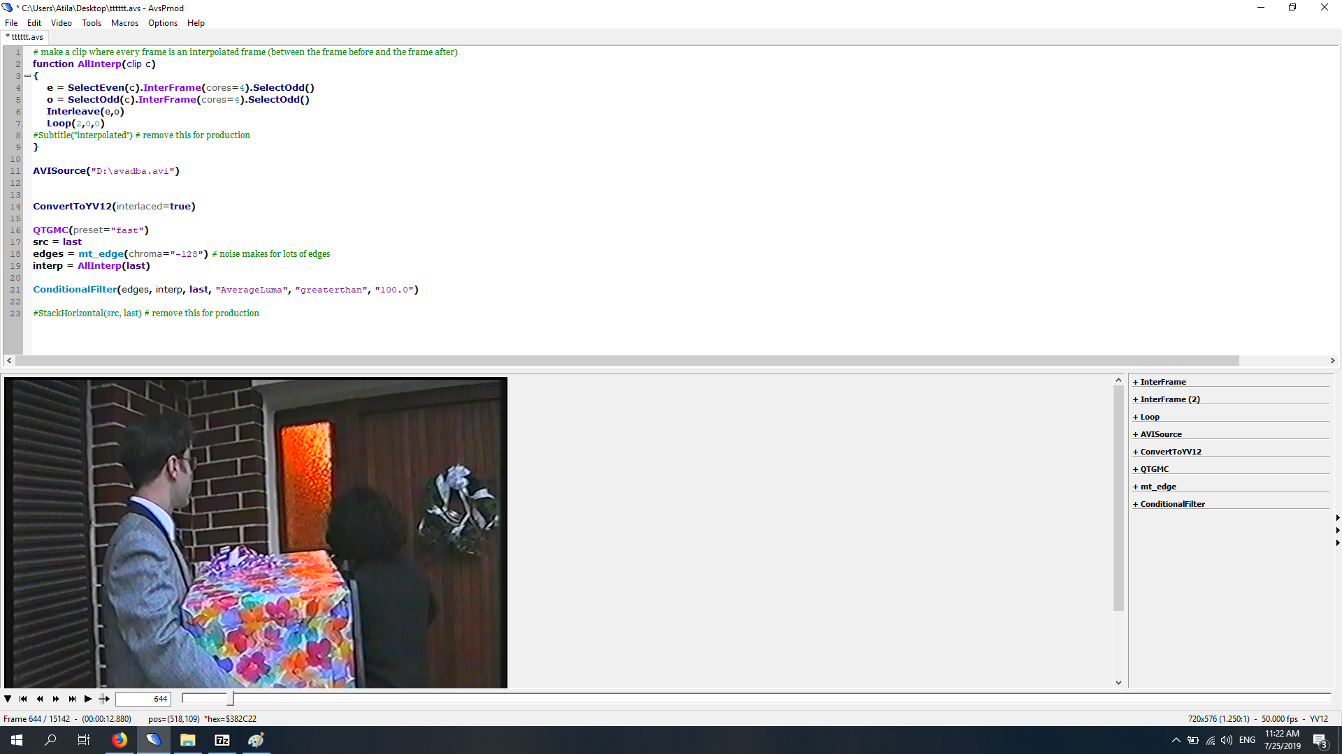

  6. Wow and this was the "most severe part" (its a little bit longer in original)but because of the size limitations I uploaded just seconds
    Jagabo you are always great I tried couple of filters and scripts (one with interpolation) but my main drawback is that I don't understand programing (to figure it out) so I usually use yours or other members solutions. As I understand the script is automatic I don't have to change parameters or change loop for the duration it will always pick the frames ? right ?

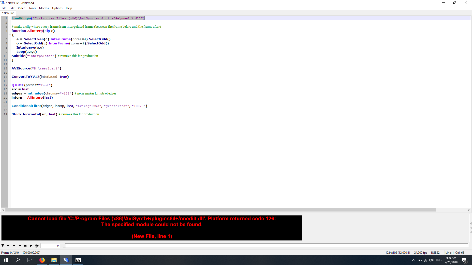

    Oh my that QTGMC again there is no function Dither_Luma_Rebuild QTGMC Line 494 wich is :
    srchClip = tv_range && !srchcheck ? srchClip.Dither_Luma_Rebuild(S0=Str,c=Amp,slice=fa lse,lsb=lsb,uv=CMmt) : srchClip
    and I have Dither tools if that is what it ask for
    I tried million combination and always some error Avs ver not know then another and another
    Is there any download of correct plugins and dependencies? why the hell the author of new qtgmc doesn't include them anymore like VIT did

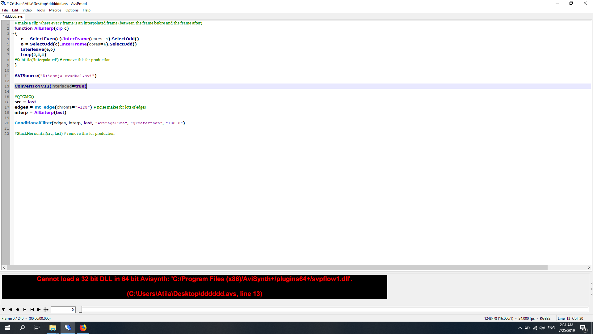

  7. It seems simple but i cannot get it to work I put 3.3.2 (3362 newest plugins masktools and rgtools error 3358 newest plugins error )version of qtgmc and old plugins now new problem Image
    [Attachment 49627 - Click to enlarge]
    can someone upload plugins from their pc that works

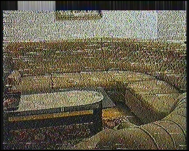

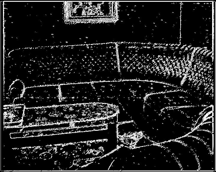

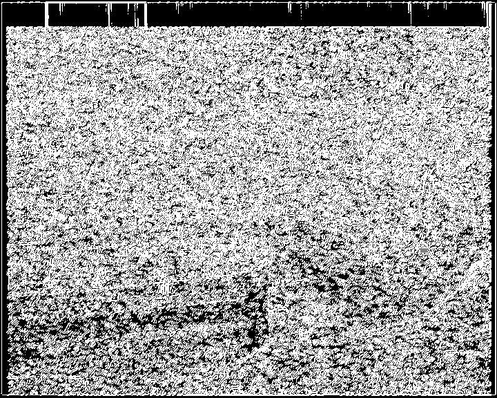

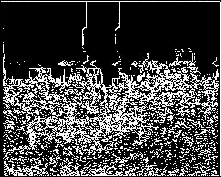

  9. You can't use SelectEven() with test1 because the good fields alternate between the even fields in some parts, the odd fields in other parts. The bad fields have "snow" type noise which make them easy to detect with mt_edge(). A typical bad field (after qtgmc):
    [Attachment 49628 - Click to enlarge]
    result of mt_edge():
    [Attachment 49629 - Click to enlarge]
    mt_edge() of a good field:
    [Attachment 49630 - Click to enlarge]
    So it's very easy to detect bad fields by looking at the average brightness of mt_edge().
    Test2 has less noise in the bad frames so the noise threshold needs to be lowered to about 60:

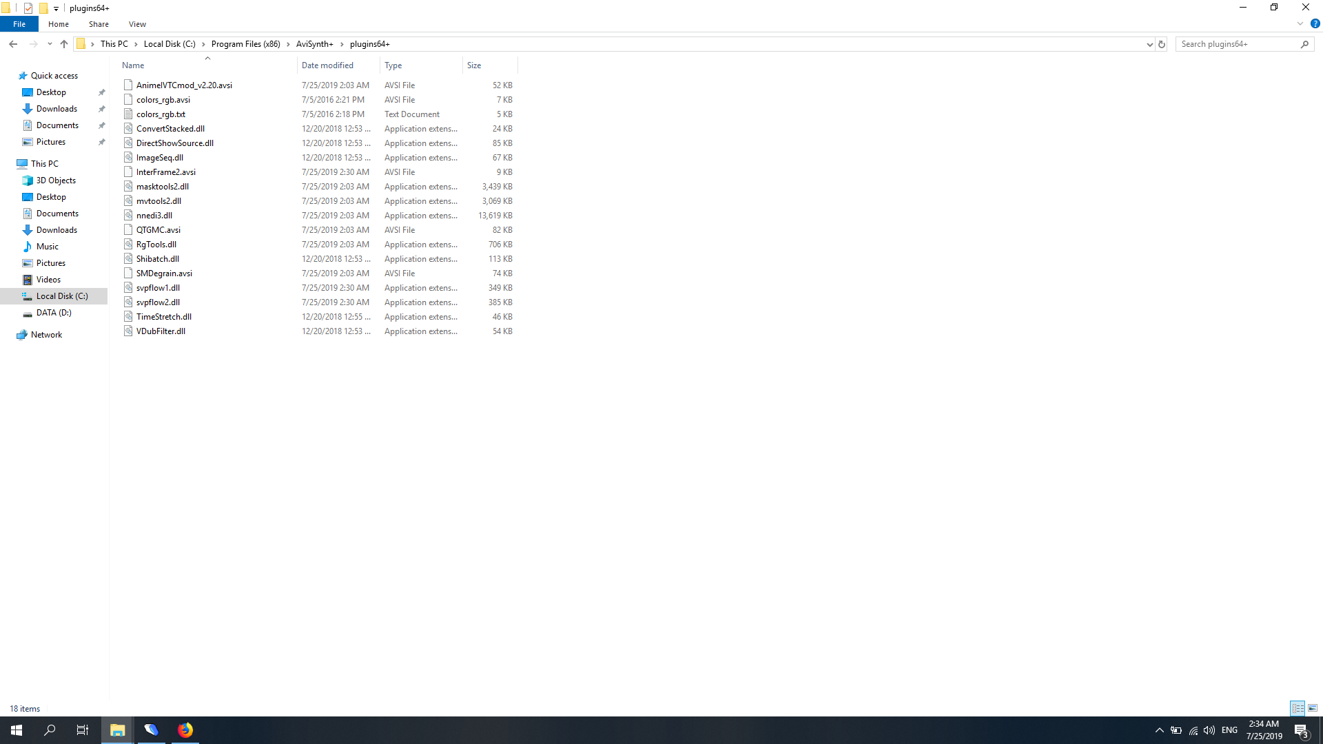

  10. I will be very grateful If someone upload their working plugins folder of avysinth /+ After almost 2 hours I still struggle with making to work.
    I use another pc now i7 6700HQ (which nnedi3 do I use I tried all of them started avx2 even SEE4 one )16gb ram gfx 1070 windows 10 everything in place rgtools nnedi smdegrain mvtols and masktols (tried couple of ver for both and yes I know that 32bit is for 32bit and 64 bit for 64 bit ) always different errors now it says no nnedi3 ?! I put the yours 2 avs scripts in different folder and call them from there (even in the plugins folder )
    All VC 2008-2017 installed Avysinth+ installed
    What "fascinates" me about Avisynth is that combination that worked earlier can start not working this is really tiring
  11. Keep in mind that you need a 32 bit editor, 32 AviSynth, and 32 bit filters. Or you need a 64 bit editor, 64 bit AviSynth, and 64 bit filters. You can't mix and match "bitness".
    I packaged a working combination of AviSynth filters for 64 bit AviSynth+ for QTGMC in this post:
    https://forum.videohelp.com/threads/393795-Deinterlacing-with-VirtualDub-s-Yadif-filte...e2#post2555738
    Those worked on my old Intel i5 2500K (Sandy Bridge) system. In addition to those you might need MSVC runtime and Intel's math libraries:
    https://forum.videohelp.com/threads/393820-Problems-With-QTGMC-Need-Help#post2555759
    https://forum.videohelp.com/threads/393795-Deinterlacing-with-VirtualDub-s-Yadif-filte...e2#post2555758
    Once you have it working you can look into using SSE4 or AVX2 versions of some of those filters for faster performance.

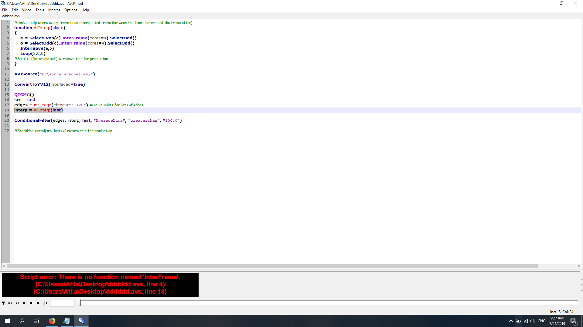

    What error message do you get? Do you have Interframe()?
    https://www.spirton.com/uploads/InterFrame/InterFrame2.html
  14. No luck

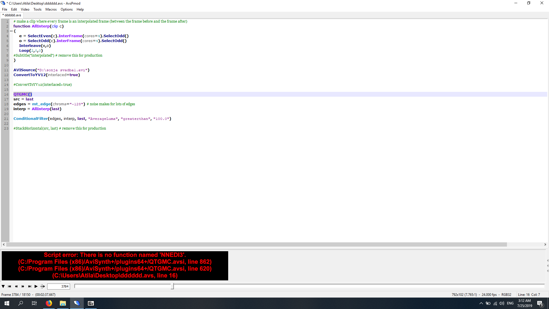

    No nnedi3 (if using qtgmc and plugins from your package) I found new ver avspmod https://github.com/gispos/AvsPmod/releases
    Yes exactly no interframe but link is broken or I cannot see the download link and it just redirect to some other site but no interframe edit I found it in older posts Ahhh
    edit still no luck Image
    [Attachment 49650 - Click to enlarge]
    [Attachment 49651 - Click to enlarge]
    Can you zip your plugins folder and upload it here thanks

  15. Interframe 2.8.2 is available here (click on the InterFrame tag at the left on the Spiriton page):
    https://www.spirton.com/category/interframe/
    Those archive I linked to had all the filters needed to run QTGMC in 64 bit AviSyth+. I removed all other filters from my plugins64+ folder and was still able to run QTGMC. It doesn't include any MSVC runtimes or the Intel math library which might be needed. The point isn't necessarily to get the most updated versions of each -- it's to get versions that are known to work together as a starting point.
  16. Yes i downloaded but new error i posted pictures
    I installed aio vc ( i tried even one by one manually ) I cannot make it to work
  17. The error is telling you svpflow1.dll is a 32 bit plugin, not the required 64 bit plugin.
  18. well I just downloaded from the link you gave me is there 64 bit svpflow how do you use 64 bit ?

  19. This site has a lot of 64 bit plugins for AviSynth+, including SVPFlow:
    http://avisynth.nl/index.php/AviSynth%2B_x64_plugins

    I found them I was here half hour before but is late and tired missed them It seems that even without QTGMC the script (first one ) is cleaning the clip
    Still no luck with qtgmc ( no nnedi3 ) but it is there in folder I dont know what to do
    I downloaded again from the site but still no luck Image
    [Attachment 49652 - Click to enlarge]
  21. Originally Posted by mammo1789 View Post
    If they don't autoload for one reason or another, then load them in your script using LoadPlugin and Import lines at the top of your scripts. An example:
    LoadPlugin("C:\Path\To\Nnedi3.dll")
    I don't know anything about 64-bit AviSynth+, though.
  22. If they don't autoload for one reason or another, then load them in your script using LoadPlugin and Import lines at the top of your scripts. An example:
    I tried that before now again still no nnedi3 the error Image
    [Attachment 49653 - Click to enlarge]
    edit finally I made it Its strange that only w7(not intel w7 ) is working any other error I mean I7 6 series is newer avx2 is definitely preset in chip I will make run with this to see if it is stable
    thanks Jagabo
  23. What version of AviSynth+ are you using? I noticed from the nnedi3 page at http://avisynth.nl/index.php/Nnedi3 it says:
    x64 version requires AviSynth+ r1576 or greater
    So you have QTGMC working now with the full script I gave?
  24. What version of AviSynth+ are you using? I noticed from the nnedi3 page at http://avisynth.nl/index.php/Nnedi3 it says:
    So in short I have installed Avisynth+ r2772-MT (it has 32 and 64 bit I use 32 bit )
    yes Jagabo is working now even QTGMC ( at least it rended the test file) it was probably my fault (for nnedi) because I selected the Core2 versions (and I have i7 Skylake), now with only w7 all good (at least I hope because still didn't do the render of the whole file it was late yesterday) thanks a lot Image

    The resulting file is deinterlaced file (original TFF) , Can I make multiple calls of the script for example first time I render, then open the resulting file in the script again add separate fields> interframe then qtgmc again second time because in preview (the original clip is 2h:53m) there some parts where noisy part "slipped" on more than one frame.
    Then I plan to use (on top of the multiple file) DeVCR or RemovedirtMC to "smooth" the "classical" drop outs then use Despot/NeatVideo for spots and general chroma noise and grain and encode it to mp4 h265 file to be watched on lcd tv or pc ( my friend doesn't have dvd ). When I show him this morning ( he is adobe "fan" and to young for analog signals like VHS its his parents wedding video which are my friends )the results from your script he was like wtf woow can I learn this
  25. The scripts from post#9 trows a error on this line interp = AllInterp(last) there is no function named Allinterp and even Google cant find it
  26. Originally Posted by mammo1789 View Post
    Sorry, I was cutting and pasting. I changed the name to of AllInterp() to InterpolateAll(). So the line should read "interp = InterpolateAll(last)", hence the inclusion of the InterpolateAll function in that post. Or you can leave the line as it is and use AllInterp() from the earlier script.

  29. Another way to address the problem is to replace a bad frame with a copy of the frame before it. You can repeat this as many times as you want to fill in long strings of bad frames. Of course, this gives a jerky result since the picture "locks up" for the duration of the bad sequence. For example, this script will fill sequences of up to 10 bad frames in a row:
    AviSource("test1.avi")
    ConvertToYV12(interlaced=true)
    nnedi3(-2) # using nnedi3 to smart bob here, instead of QTGMC
    edges = mt_edge(chroma="-128")
    THRESHOLD = "70.0"
    ConditionalFilter(edges, last.Loop(2,0,0), last, "AverageLuma", "greaterthan", THRESHOLD)
