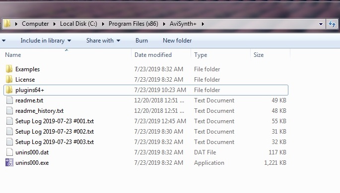

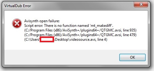

    I'm trying to learn how to de-interlace with QTGMC but so far it has been a nightmare for me. I have a Sony VAIO laptop with Win7 64bit Intel Core2 Duo T9800 @ 2.93Ghz each, 5GB RAM. Not the greatest but it should be okay.
    I installed Avisynth+ and loaded QTGMC and the required plugins, However I had some errors about certain plugins missing so I went ahead and loaded every plugin possible for QTGMC, The folder structure is as shown below:
    When I run Version() script it works fine with Vdub2, But when I try to run a QTGMC script such as:
    HTML Code:
    AviSource("C:\Users\dellsam\Desktop\myvideo.avi")
    QTGMC()
    I get this error message:
    HTML Code:
    Line 479: repair0 = (IsClip(srchClip) || Rep0 == 0) ? binomial0 : binomial0.QTGMC_KeepOnlyBobShimmerFixes( bobbed, Rep0, (RepChroma && ChromaMotion) )
    Line 935: diff = mt_makediff(Ref, Input, U=3,V=3 )
    Any clues ...????

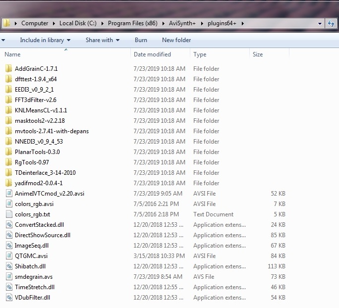

  2. mt_makediff is from masktools (masktools2.dll is the one you want)
    You need to load the actual plugins (.dll's) . They are in subfolders in your screenshot. Either go in the appropriate directory and copy the .dll into the avisynth plugins directory level, or use LoadPlugin("blah.dll") explicitly in the script
    Avisynth will only autoload plugins in the plugins directory level ; it won't go searching recursively into subfolders

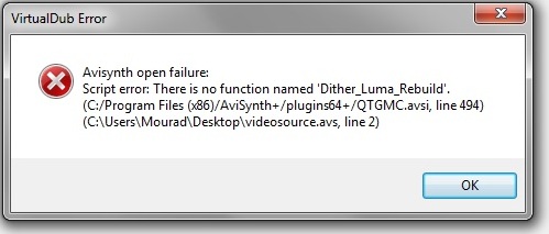

    That solved the line 437 problem but now it's complaining about line 494, This is the most ridicules piece of software that I've ever seen:
    Line 494:  srchClip    = tv_range && !srchcheck ? srchClip.Dither_Luma_Rebuild(S0=Str,c=Amp,slice=false,lsb=lsb,uv=CMmt) : srchClip
  21. You should post the actual full error messages, not just the line in question. It should tell you what exactly it's complaining about, and provide clues
    I'm guessing you are probably missing smdegrain , that is where Dither_Luma_Rebuild comes from
    If you follow the instructions, it tells you exactly what the dependencies are; what is required and what is optional
    http://avisynth.nl/index.php/QTGMC

    Here is the current Vdub error message:
    This is from QTGMC 3.358, by Vit, 2012, 2018 mod by A.SONY, This is the one installed on my system. I had copied lines from v3.357 by mistake.

  27. smdegrain. see post #21
  28. I told him before that he should convert to YV12. QTGMC requires AnimeIVTC if you use it with YUY2. In turn, AnimeIVTC has a huge list of dependencies:
    http://avisynth.nl/index.php/AnimeIVTC#Requirements
    It's much easier to ConvertToYV12(interlaced=true).
    Also his source is 720x486. ConvertToYV12(interlaced=true) requires mod4. So he needs to crop 2 or 6 scan lines off the frame, leaving 720x484 or 720x480.
