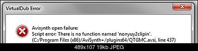

    I literally copied the newbie script from the QTGMC page and loaded it into vdub and I'm getting the exact same error:

    It's clearly something wrong with QTGMC file.

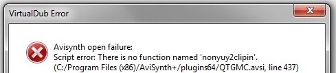

  3. nonyuy2clipin is part of the AnimeIVTC package. It's listed as one of the optional plugins for QTGMC -- " only required when working with a YUY2 source". If you added ConvertToYV12(interlaced=true) between AviSource and QTGMC in your script you should not have gotten that error. Always post your full script when having problems.

    This is why I warned that QTGMC is one of the hardest filters to get working. The various plugins it requires are changing all the time (they're written by different people) and getting the right version of each can be a problem.

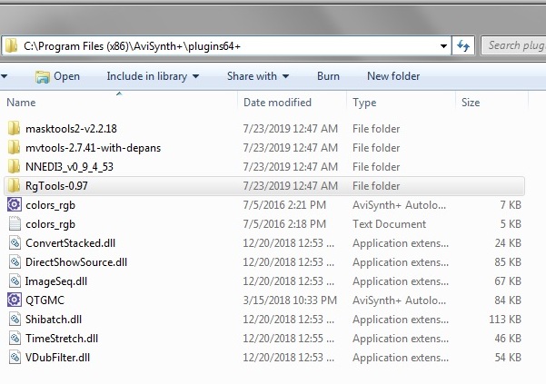

    My script is :
    AviSource("C:\Users\Dellsam\Desktop\myvideo.avi")
    QTGMC()
    By the way I did not install AnimeIVTC package, I only installed the required 4 plugins, masktools2-v2.2.18, mvtools-2.7.41-with-depans, NNEDI3_v0_9_4_53 and RgTools-0.97. The rest of the files below are installed automatically by Avisynth+

    I did some troubleshooting on my own and line 437 in the error refer to a plugin that I don't have so I went ahead and installed AnimeIVTCmod_v2.20 now I'm getting an error for lines 479 and 935 which obviously some other missing plugins, The QTGMC team in their webpage stating that only 3 plugins are required which obviously is a lie, this is retarded, I'm about to give up.
  6. You need to put the dll files from those sub-folders into the plugins folder. AviSynth will not search through the subfolders for them.

    I moved the plugins out of their folders and started getting plugin missing messages so had to put them back into their folders, I have 3 plugins folders, Plugins, Plugins+ and plugins64+ they are by default loaded into the Plugin64+ but I put copies of the same plugins on all 3 folders still getting the same error messages about certain lines of the QTGMC file. I did un-check "Hide ext for known file types" still having the same error messages.

  9. This is the minimum to use QTGMC with the default settings and yuy2.

  12. I was able to run the script with only those files in my AviSynth+ plugins64+ folder. In the plugins64 folder there is only SupCore.dll and SupTitle.dll, both of which came with AviSynth+ I beleive.
