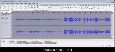

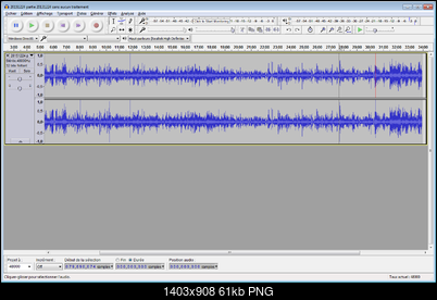

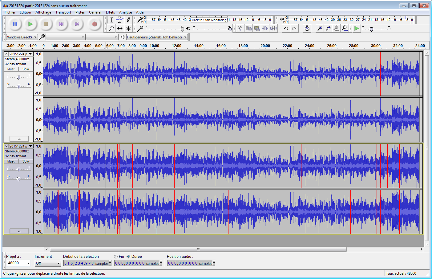

  1. I have a video recording of a conversation, with important variations in volume, depending on the distance each speaker was relative to the camera, including the sorry soul who was holding it. I would like to homogeneize the whole thing, but keep it lively, while avoiding any clipping, and if possible avoiding an increase of the noise/hiss (there's not much of it as it is, but it could become an issue if gain is applied globally).
Name:	20151224 20131224 sans aucun traitement.wav -- importé dans Audacity.png
    I've tried first within the Magix NLE, using the included compressor, but even with the highest setting it doesn't reduce the loud passages or reduce the discrepancies between loud and low passages as much as I'd like, and produces some clipping – in fact it seems to be increasing the volume of everything, even though loud passages are increased less in proportion.
    I tried processing that section with the accompanying standalone audio editor Magix Music Editor, which offers more control over the compression parameters, but the result is actually worse : even at medium settings it produces a lot of clipping. There's a limiter which can prevent the clipping, but it doesn't seem to be the cleanest way of processing audio.

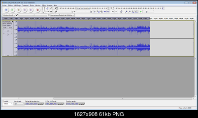

    I tried Audacity's internal compressor, which works well at reducing loud passages in “RMS” mode, but then applying gain will automatically increase the noise ; I also tried the “compression based on peaks” method, which seems to increase the volume of everything, not what I want. And according to this article that compressor is too rudimentary, the author recommends using the SC4 plugin instead. I tried SC4, but it doesn't seem satisfactory either : it reduces loud passages indeed, but leaves some very high peaks untouched (and it's quite tricky to set parameters as it doesn't have a curve representation like the internal compressor). The “leveler” effect seems excellent when looking at the curve – it does reduce the discrepancies, increasing the volume in low parts and reducing the volume in loud parts, and doesn't seem to touch the silent parts – but when listening to the result it's just ugly, with a lot of distorsion.

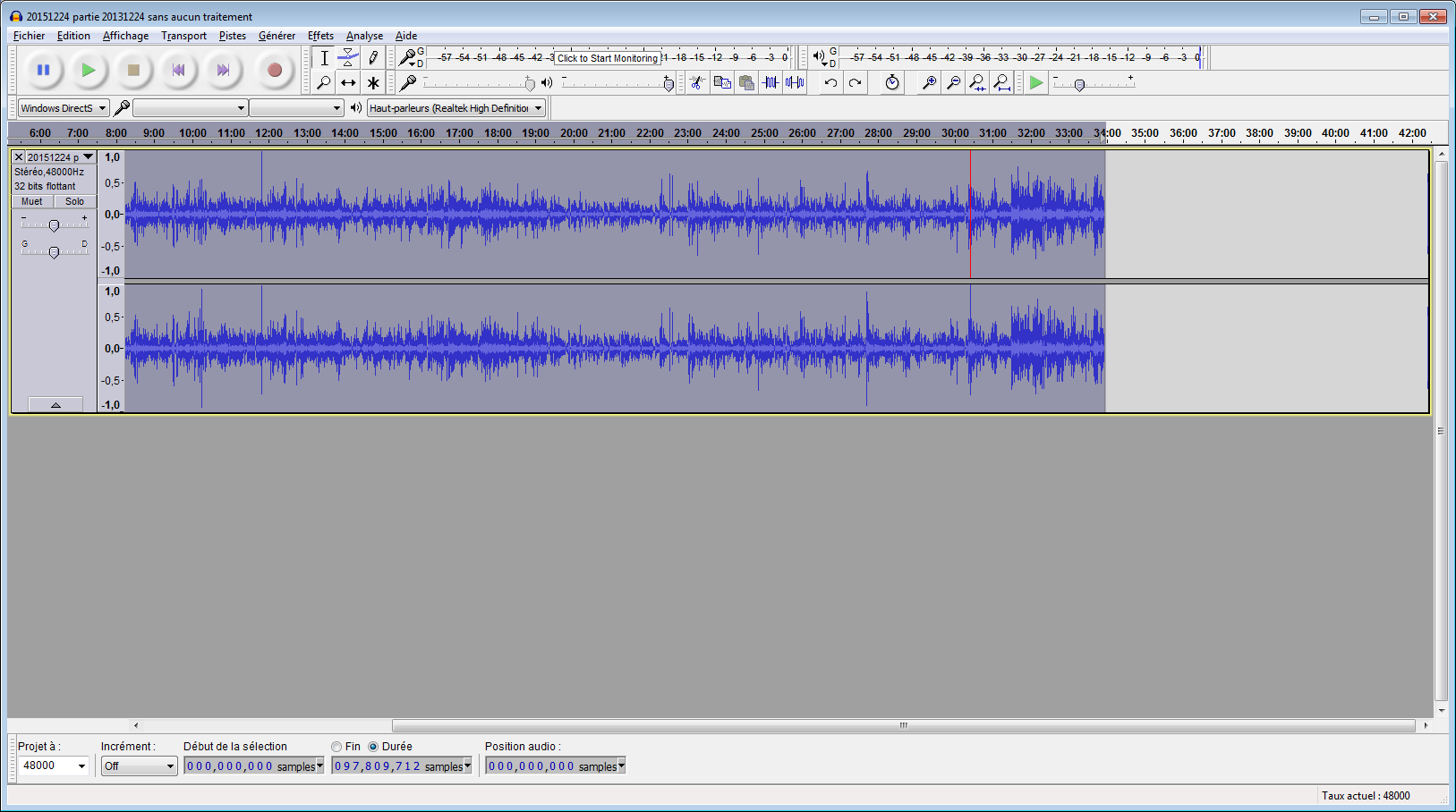

Name:	20151224 partie 20131224 test Audacity SC4, avant application.png
    detail of the waveform before applying SC4

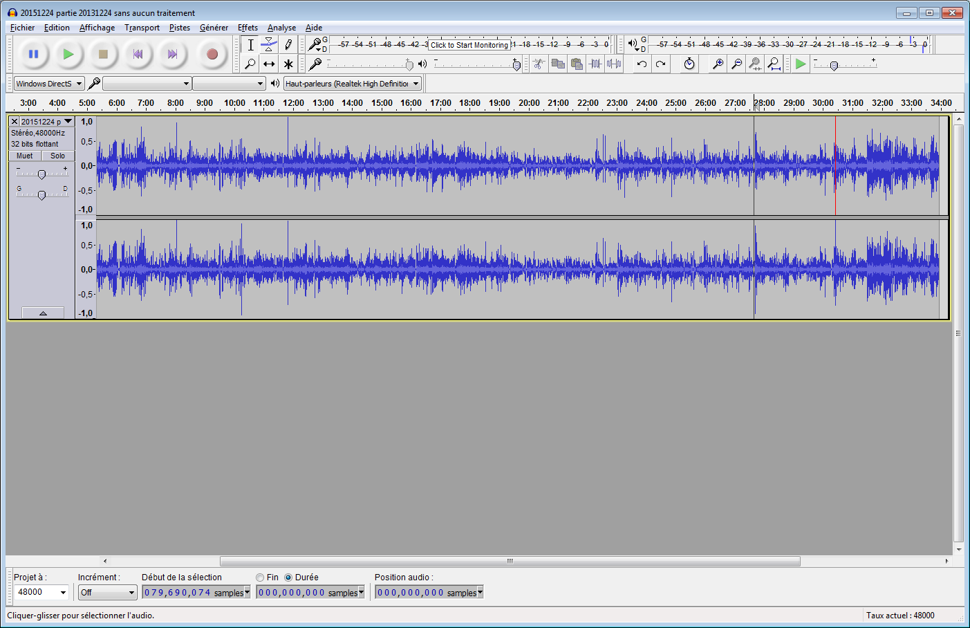

Name:	20151224 partie 20131224 test Audacity SC4, après application.png
    detail of the waveform before applying SC4 with :
    RMS/peak = 0, attack time = 5ms, release time = 120ms, threshold = -18dB, ratio = 4, knee radius = 3.5, makeup gain = 0
    What reliable method could I use to achieve the intended result ?

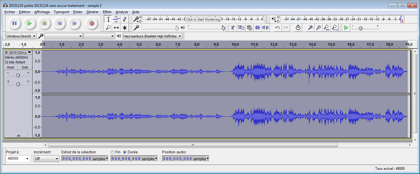

  3. Thanks for the quick reply. Here are two short samples :
    20151224 partie 20131224 sans aucun traitement - sample.flac
    20151224 partie 20131224 sans aucun traitement - sample 2.flac
    (The second one is cut around a transition between two sections of footage, all voices are distinctly louder in the second one, starting at 00m10s.)

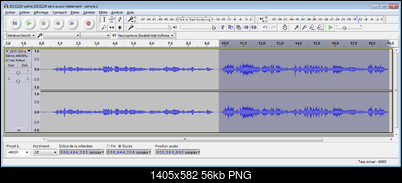

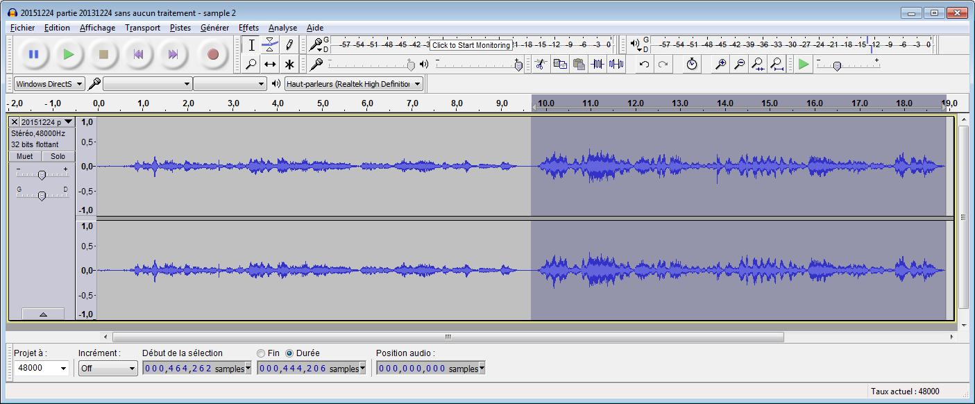

  5. It seems close to what I get with Audacity's compressor and similar settings of threshold = -15dB, ratio = 2:1, in RMS mode, attack and release both at 0.40ms, no post gain (settings are less accurate : granularity of 1 unit for threshold, 0.5 for ratio).
Name:	20151224 partie 20131224 sans aucun traitement - sample 2.flac - Audacity compressor RMS mode T .png
    The peaks are more reduced on your screenshot, but the general shape of the waveform is still distinctly “bulkier” on the second segment. If I apply a gain of -5dB to the second segment, the relative peaks are preserved, while the amplitude of the whole waveform is reduced.

    – At the end of the video the guy talks about further processing he intends on applying to that recording, to “sweeten up the audio” : what does he mean by that, and what specific effect could he be alluding to ?
  16. I've only skimmed over a few posts, but I did download the samples from post #3 (I think) and ran them through some volume normalising DSPs, courtesy of foobar2000. I make no claims about the results. They won't be perfect, as I just used my go-to settings (and the defaults for VLevel) and didn't listen to the output closely. In fact they may even suck, or you might find something you like.
    There's also a utility called Levelator that's designed specifically for speech. It should be in the VideoHelp software section.
    The DynamicAudioNormalizer command line. The other samples used a DSP in the conversion chain so there's no special command line as such.
    /d /c c:\progra~1\foobar2000\encoders\ffmpeg.exe -i - -ignore_length true -af dynaudnorm=f=150 -c:a pcm_f32le -f wav - | c:\progra~1\foobar2000\encoders\QAAC\qaac.exe --ignorelength -s --no-optimize --no-delay -V 64 -o %d -
    There's a thread here where "compressing" while converting with fb2k was discussed. There's links for the DSPs and some instructions for setting things up if you search through the thread, assuming one of the samples pleases you.
    None of the DSPs I used for the samples "compress" as such. They increase the volume of the quiet parts instead of squishing the loud parts (the DAN does have a compressor, I think, but it wasn't enabled). In theory the end result should be the same as compression, if not better, and it's easier to configure and tends to be more set and forget.
    "Compression" only. I didn't attempt anything else. They're AAC to save some bandwidth. The foo_r128norm samples will be quieter than the others as the DSP aims for EBU R128 volume. From what I heard it didn't compress the samples well anyway, and it has no options.
    Compressed Samples.zip (3.6MB)
  17. I've been meaning to enable the Dynamic Audio Normalizer's alternative boundary option for a fair while, as it can be slow to respond at the beginning of the audio. This thread finally prompted me to test it, and for the samples posted earlier it does improve the compression at the beginning.
    For ffmpeg the alternative boundary mode is enabled with b=1. ie
    -af dynaudnorm=f=150:b=1
  18. Member
    Mar 2008
    I took a look at your samples, the LoudMax files look good to me, good balance in the levels;
    now you can use Audacity noise reduction and perhaps lower the levels slightly -
    thanks for posting
  19. LoudMax comes as a VST plugin, a WinAmp plugin, an AU plugin, and a LADSPA plugin, so you can use any program that can load one of those types.
    For the record, I used the VST version, and for foobar2000 that requires the VST Adapter. There's only two knobs. Threshold was -18dB and Output was -3dB.
    Now I've looked I realised the version I'm using is dated May 2017. I think I should update it.
    https://loudmax.blogspot.com/
