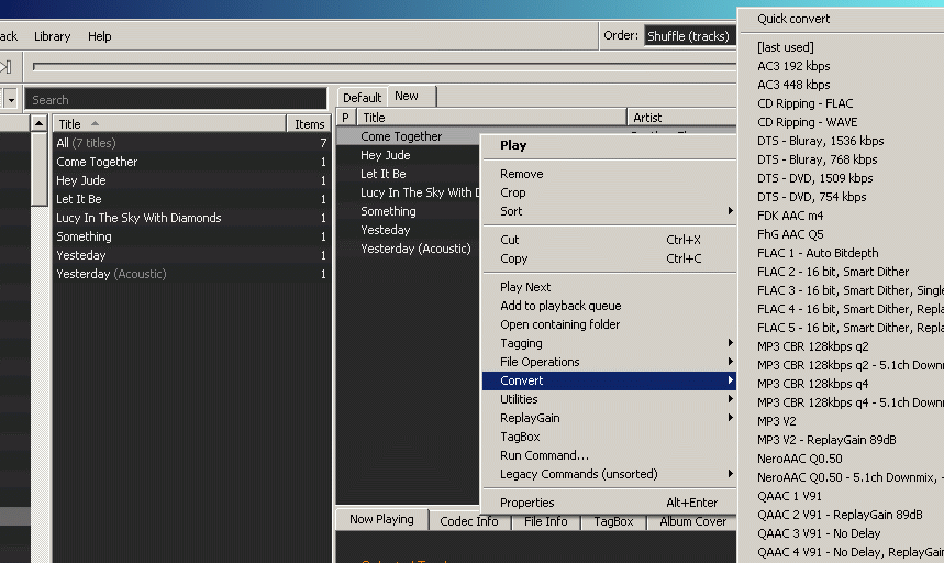

  5. circulationds,
    I've been using similar settings to yours for the Dynamic Audio Normalizer for quite a while. I use the version built into ffmpeg and mostly convert with foobar2000 as it can be done in a single step. Your process appears to convert to MP3 and then to AAC after normalizing.
    The command line for the converter preset I use with foobar2000 for converting to AAC is the one below. It normalizes with ffmpeg and the Dynamic Audio Normalizer, and then pipes the output to QAAC for conversion to AAC.
    /d /c c:\progra~1\foobar2000\encoders\ffmpeg.exe -i - -ignore_length true -c:a pcm_f32le -af dynaudnorm=f=150 -f wav - | c:\progra~1\foobar2000\encoders\QAAC\qaac.exe --ignorelength -s --no-optimize --no-delay -V 64 -o %d -
    Or for a little more compression I use the following in the command line
    -af dynaudnorm=f=75:g=11
    Like you, I think the default DAN settings respond too slowly.
    https://ffmpeg.org/ffmpeg-all.html#dynaudnorm
    There's also a matrix mixer DSP for fb2k you can add to the conversion chain for downmixing multichannel audio to stereo, and once again it can all be done in a single step. You can save multiple conversion presets. I've posted a few screenshots below. The Matrix Mixer settings I use for downmixing 5.1ch to stereo will drop the volume a fair bit so there's no need to reduce it further before normalizing. For stereo sources you might prefer to reduce the volume before it's normalized, although I don't find it necessary myself. Once again you could save a conversion preset that reduces the volume before it's piped to the encoder.
    Foobar2000 will decode the audio in MKV/MP3/AVI etc, so you can open video files and convert the audio, but if there's chapters they can get in the way so I usually extract the audio with gMKVExtractGUI, convert it with foobar2000 and then replace the old audio with MKVToolNix.
    A DSP for foobar2000 I'd also recommend is called the "ffmpeg Decoder Wrapper". It allows foobar2000 to decode anything ffmpeg can decode. I mostly use it for eac3 as there's no other third party decoder for eac3 I know of.
    Foobar2000 can take a bit of getting used to, and you have to download some encoders/decoders yourself, as fb2k only comes with the ones that can be freely distributed, but if you do a lot of converting I'd recommend you give it a try. It'll also convert multiple files simultaneously or even convert to different formats simultaneously. You just load the files for conversion into a playlist, select some or all of them, right click and choose the appropriate conversion preset.

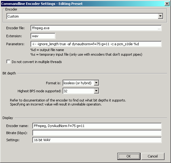

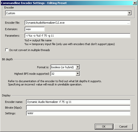

    Anyway, here's a foobar2000 command line for the DAN itself. "%s" creates a temporary wave file and the DAN would output a wave file. See the screenshot of the encoder configuration below.
    -i %s -o %d -f 75 -g 11
    You can do the same thing with ffmpeg, but there's no need for a temporary input file. This tells ffmpeg to output a 16 bit wave file:
    -i - -ignore_length true -af dynaudnorm=f=75:g=11 -c:a pcm_s16le %d
    Or you can encode with ffmpeg at the same time. It has the LAME mp3 encoder built in. This is the command line I use for converting to VBR MP3, with LAME's default V2 quality (and forcing ID3v2.3 for any tags instead of the default of ID3v2.4). Specify mp3 as the extension and "lossy" as the format in the encoder configuration.
    -i - -ignore_length true -af dynaudnorm=f=150 -c:a libmp3lame -q:a 2 -id3v2_version 3 %d
    Or to encode with ffmpeg's AAC encoder, something like this. Specify m4a or mp4 as the extension and "lossy" as the format in the encoder configuration.
    -i - -ignore_length true -af dynaudnorm=f=150 -c:a aac -vbr 5 %d
    If there's a sub-folder called "encoders" in the foobar2000 folder (it's created if you install the free encoder pack), when you create a custom encoder configuration and specify an exe, foobar2000 will look for it in that folder. You can specify the full path for the encoder if you wish, but if you don't and foobar2000 can't find it in the encoders folder, it'll ask where the exe is located the first time you use the encoder configuration.
    To create a new encoder configuration or converter preset, open at least one audio file, right click on it, select Convert, and in the sub-menu click on the 3 dots at the bottom of the preset list (assuming there's existing presets). That takes you to the converter configuration.

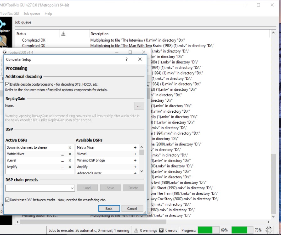

  8. hello_hello
    i see what you mean with getting used to foobar manged to get some movie audio converted but other ones are failing on me, i think i will just use the method i'm using just now but i will use the foobar to normalise them to 89db once box4 has completed, i tried the EBU R128 normalizer through foobar but to me it was like it was the same issue, audio was slightly fading at points but not as bad as the box4 default settings, i have used your settings as a guide with box4 f =75 and the gaussian filter set at 11 so far so good, so thank you for posting, only thing about my way is the conversion with the pazera takes a long time to do, but i do like the foobar2000 as it has some good tweaks i can use for my music library. i was using mp3gain to begin with a few years ago but i did not understand what clipping meant until i started reseasching converting video's and realised that on my dredd movie i heard the clipping sound through my tv so that's what made me look into something that was better for audio conversion. i have the dynaudnorm GUI but its asking me to create a logfile which i'm not entirely sure how to do. i have checked on youtube but i still can't figre it out lol, it's all new to me but enjoying the challenge
  9. If you're referring to the EBU R128 Compressor DSP.... it compresses way too much for me and the window size is a little too big (although it probably conforms to the spec) so sometimes it lets a brief loud peak through, or briefly increases the volume of a quiet section too much.
    For soundtrack audio, ReplayGain's 89dB is often too high (unless you do compress it) as soundtrack audio is more dynamic than CD tracks. I think the R128 standard is -23LUFS (-23dB), which is the same as 84dB for ReplayGain.
    And yeah.... I tried the dynaudnorm GUI at one stage but I remember having a similar issue and I didn't care enough to try to work out what the problem was.

    you're a legend m8 thank you so much for your help i'm using the mp3 format i think it sounds better -i - -ignore_length true -af dynaudnorm=f=150 -c:a libmp3lame -q:a 2 -id3v2_version 3 %d ripped about 100 files so far and they all sound the same, i have it set at 83 decibels through foobar i have like 1200 movies to work through and it was doing my head in having some that where fading in and out, it's mainly used for my plex that i stream onto my smart tv, again thank you so much for all the help
  25. Originally Posted by circulationds View Post
    I'm glad you're happy, but.....
    How have you set it to 83 dB?
    After the source is decoded, the volume is adjusted by the ReplayGain section under Processing (if it's enabled in the converter setup), processed by any DSPs in the chain, and then piped to the encoder.
    For the ReplayGain section to adjust the level to a target volume, the source files have to be scanned and the ReplayGain info saved. Normally you'd probably save TrackGain info, so to adjust to 83dB you'd select "Track" as the Source Mode in the ReplayGain section, "Apply Gain" as the Processing option, then adjust the "With RG Info" preamp to -6dB. That'd result in the volume being adjusted to 83 dB in ReplayGain-speak.
    The problem is though, if any DSPs effect the volume you'll no longer have 83 dB, and that would include downmixing multichannel audio to stereo. The same applies to an encoder adjusting the volume, which would happen when ffmpeg is normalising with the dynaudnorm. It can't work any other way because there's no way for fb2k to know what the final volume will be if it's adjusted by a DSP or encoder.
    If you want 83 dB you can do it two ways. One is to make it a 2 pass process. First encode to a lossless file while normalising, then scan the output files and save the ReplayGain data,. From there you can encode to the final format while adjusting the volume to 83dB.
    Alternatively, you can encode as MP3 or AAC and adjust the volume of the output files losslessly as you would with MP3Gain. You'd scan the normalised MP3 or AAC output files, save the ReplayGain data, then under the right click ReplayGain option, select "Apply track ReplayGain to file content".
    Personally I wouldn't bother adjusting the volume for movies after normalising as it's not really important that they're all the same volume as such. For related audio, such as episodes of a TV show it might be better to have them all the same volume, although after normalising they probably won't differ all that much.
    While I'm thinking of it, I'm pretty sure fb2k is set to adjust the volume of files containing ReplayGain data on playback by default. That was the idea of ReplayGain in the first place, but it means you're not always hearing audio at the "real" volume.
    There's options in Preferences under "Playback" where you can disable the ReplayGain adjustment while playing audio. Set the Source Mode and Processing options to "none".
    In case you haven't found them yet there's a few options under Tools/ReplayGain for configuring the ReplayGain scanner, and under "Alter File Content" you can set the target volume for adjusting MP3 and AAC losslessly. And one other little tweak as I think it's disabled by default...
    Under "Advanced/Tools/ReplayGain Scanner" there's an option labelled "Results Dialogue: Advanced formatting of peak values". Check it if it's not checked by default. Translated to meaningful English, it means the peak values displayed by fb2k after a ReplayGain scan will be shown as both decibels and a percentage. Without that option checked the peak values are show as a percentage only. I think it's done that way to conform to the original ReplayGain spec, but percentages don't translate to dB in an intuitive way.
    Anyway, I just thought I'd explain how the volume adjustment works in case you encode 100s of files thinking the volume was being adjusted when it wasn't.
    Have fun.

  27. I don't think you can save a preset as such with the RockSteady configuration. Just adjust the settings and click okay. Or maybe click "apply" first, but they should "stick".
    I'm not sure what's happening with the conversion to a lossy format. Which one? After a conversion fails, open the Console from View/Console and see what it says there. For converting to mp3, I often use ffmpeg instead of the LAME exe. FFmpeg accepts a 32 bit float input. LAME does also these days (from memory) but it converts the input to 24 bit integer before encoding which increases the potential for clipped peaks. I don't think ffmpeg does that.
    -i - -ignore_length true -c:a libmp3lame -q:a 2 -id3v2_version 3 %d
    The encoders should be installed to a sub-folder called "encoders" in the foobar2000 folder. Maybe post a screenshot of your encoder configuration to see if something's wrong there. Even though fb2k has AAC presets, I think they all require you to download certain files yourself. The other encoders should work with the free encoder pack installed though.
    Free_Encoder_Pack_2018-05-22.exe (or whatever the current version is) can be unzipped like a zip file with 7-zip. Then you could manually copy the encoders to the encoders folder if need be, but installing should work, unless they're being installed to the wrong location for some reason.
    I have a file called "plugin.ini" in the same folder as RockSteady. It's just a text file with an "ini" extension. Here's the contents. Use Notepad to create and save the ini file if it doesn't exist and put it in the folder where RockSteady is located. Normally "C:\Program Files\Winamp\Plugins" (for XP) even if WinAmp isn't installed. Hopefully that'll make the settings stick.
    [Piettro Pro's RockSteady]
    FullAmpTo=30
    MaxAmpDB=15
    AmpGainTime=10
    PresetNo=-1
    SmartLimit=1
    AmplifyTo=-1
    RelPos=100
    JointStereo=1
    For RockSteady, the help file says everything below the "Amplify up to a level of" value is amplified and anything above it is left alone. The "Maximum amplification" setting is the maximum amount anything below the "Full amplification up to" value can be amplified. Above the "Full amplification up to" value, the help file says "the amplification amount will be just linearly interpolated up to the maximum level".
    I've been using 30% for the "Full amplification up to" value lately, which is -10.45dB and 25% is -12.04dB, so there's not much difference. Just a chance for a slight increase in any "volume pumping" of fairly quiet sounds at 30% (I assume). Although that's -10.45dB or -12.04dB if the "Amplify up to a level of" value was set to 0dB, as it's a percentage of the "Amplify up to a level of" volume. I'd have to think about the math when it's a percentage of a lower volume.
    With the "Amplify up to a level of" setting at -1dB, pretty much everything is amplified to some degree, but there's a chance of mild clipping (nothing I've heard) even with the "smart limit" option enabled. If you're fussed about that, you might want to reduce the "Amplify up to a level of" value a bit, and/or tell fb2k to reduce the volume a little to allow for some more headroom. Rather than use the ReplayGain section for that, you can put the Amplify DSP ahead of RockSteady in the DSP chain and reduce the volume that way. It's probably easier. -2dB or -3dB should be plenty. https://foobar.hyv.fi/?view=foo_dsp_amp
    (Edited to correct a mistake in the way I explained the RockSteady settings above)

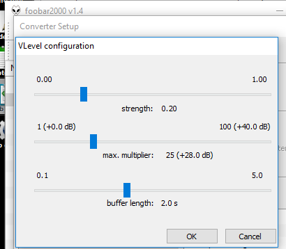

    Hi mate, read up on your reply, i have moved onto another option, i wasnt happy with the outcome of winamp dsp bridge, some movies sounded like they were compressed to much, i have used in my active dsp list whilst converting as follows and the outcome has been excellent! don't ask me how but this little dsp really works its called Vlevel, i'm using downmix to stereo then followed by your matrix mixer setings. I know that downmixing to stereo, then using the settings on the matrix mixer doesn't make any sense but it seems to be working then i used the vlevel dsp and then i use amplify +4db the results have been really good so far,, and the dynamics sound good as well. (Converting the files to AAC 192 constant bitrate) i have added some pictures, only issue is when i set up a list and after applying gain info i can only convert one file at a time as when i go to batch convert the end audio from the previous film starts in the next movie, its like a fade in fade out and the dialogue is out of sync due to the last few seconds of the previous movie audio is included in the next movie, i just select each file one at a time and convert them that way and do them in batches of 20, but all is working out good, best result i have found upto now
    [Attachment 47056 - Click to enlarge]
    [Attachment 47057 - Click to enlarge]
