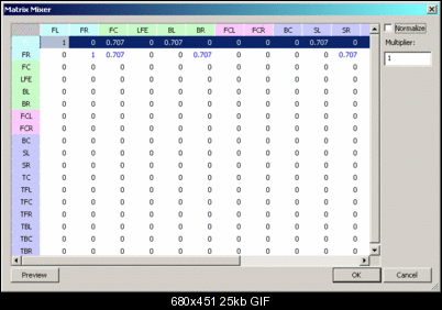

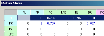

  17. If you want to try it out first, here's the method i use for applying compression on playback. You can load the same WinAMP DSPs directly with Potplayer.
    https://forum.videohelp.com/threads/380744-DTS-to-AAC-using-Nero-AAC-encoder-command-li...=1#post2462879
    Originally Posted by hokkom View Post
    I have broken down the audio to 2 channels stereo, but the dialogue is really low in sound while the music and explosions are really loud. I wanted to increase the gain of the soft passages while keeping the loud one the same.
    If the original audio is 5.1, going straight to 2.0 is not going to help(obviously). 5.1 to 6 waves is the only way that YOU can control the downmix.
    Well.... maybe with the exception of downmix methods that let you control the downmix. The Matrix Mixer DSP I use with foobar2000.
Name:	matrix mixer.gif
    hokkom,
    If I was going to compress when downmixing, which I do now and then when converting audio specifically for a video that'll be watched using the TV's media player once, then deleted, (I only keep the uncompressed original) I'd do it the same way I do it on playback on the PC. I've created a foobar2000 conversion preset to downmix to stereo, compress and then encode with QAAC, because QAAC has an option to normalise the over-all volume so the peaks are at maximum.
    It'll take a bit of setting up initially (although I can upload my foobar2000 configuration files if it helps) but when it's done, you can simply load a mutichannel file into a playlist, right click and select the conversion preset, and out comes a downmixed, compressed stereo file a few minutes later. Easy.... once it's set up.
    Here's some old sample files I uploaded previously. A stereo downmixed version and a few compressed versions, all normalised to the same volume. The idea is to listen to the difference in volume between the speech and the action (gunshots) that follow, or ideally, the lack of difference in volume.
    In the zip file:
    1. Downmixed to stereo, no compression.
    2. Compressed with RockSteady (Wimanp plugin loaded into foobar2000).
    3. Compressed with LoudMax (Wimanp plugin loaded into foobar2000). It's not as good as I expected but I just threw that one in. It's probably too compressed. I haven't played with LoudMax much and I'm sure it'll do better.
    4. Compressed with foobar2000's EBU R128 Normalizer DSP.
    https://forum.videohelp.com/attachments/38927-1476630905/Compression%20Samples.zip
    I'll try to add another sample using the Dynamic Audio Normaliser pandy mentioned later, once I get it working properly in foobar2000, and maybe a better LoudMax example.
    I guess the advantage of pandy's method is you can do everything in one go. For my foobar2000 method you need to extract the audio yourself, convert it and remux. The latter doesn't bother me though as much of the time I'm re-encoding the video via Avisynth and/or remuxing anyway. AnotherGUI is another GUI I'd recommend trying with ffmpeg too.

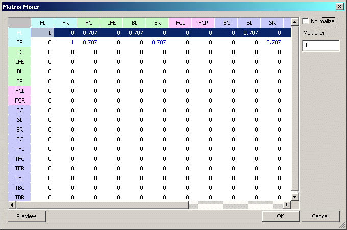

  29. I was bored so I created some new samples using different compression methods. They all compress reasonably well. First I downmixed to a stereo 32 bit float wave file like this, with Matrix Mixer's "Normalise Matrix" option enabled to also reduce the overall volume enough to prevent clipping when downmixing. I never include the LFE channel when downmixing, but doubly-so when compressing as it can interfere with the compression too much.
    From there I used the following steps:
    - Scanned the output file and converted it to flac while adjusting the volume to 83dB in ReplayGain speak (EBU R128 Scanning).
    - Used the flac file to convert to 32 bit wave files while applying the various compression methods.
    - Scanned the wave files and converted to AAC while adjusting the volume to 83dB in ReplayGain speak (EBU R128 Scanning).
    That all seemed to work fine except for using the LoudMax compressor. It seems to skew the ReplayGain result for some reason. I left it as it is, and the ReplaqyGain volume is 83dB like all the rest, but it sounds 3 or 4 dB quieter than the others to me. I'll have to investigate that further.
    1 - Source FLAC file at 83dB in ReplayGain speak (EBU R128 Scanning).
    2 - Compressed with the Dynamic Audio Normalizer with -f 150 in the command line, then adjusted to 83dB (ReplayGain).
    3 - Compressed with the foobar2000 EBU R128 Compressor DSP (R128Norm), then adjusted to 83dB (ReplayGain). It has no settings to configure.
    4 - Compressed with the VST Version of the LoudMax plugin, threshold set to -18dB, then adjusted to 83dB (ReplayGain).
    5 - Compressed with the WinAmp RockSteady plugin, settings in the screenshot here, then adjusted to 83dB (ReplayGain)
    Nothing exciting to report in the end, aside from what seems like a LoudMax/ReplayGain/R128 scanning anomaly. They all compress. Which you prefer might be personal preference and the settings used. I still think they improve the dialogue volume and none of them make the problem worse.
