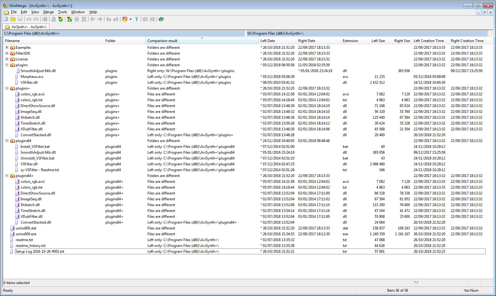

    But, examining the scripts I made a few months ago, I found out that the Morph() function (found on this thread, specifically that post) no longer works as expected : now if I use the command "Morph(137,139)" for instance, I get a blend of frame 137 and the last frame of the input movie, instead of a blend of 137 and 139. I tried copying the Morph function inside a script, changing its name to Morph2 and calling Morph2(x,y), same result. I checked that code was strictly identical to the code I copied initially. What could be the explanation ?

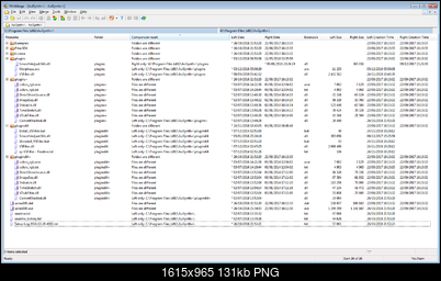

    I haven't voluntarily changed anything in my Avisynth configuration since then, but I noticed that the modified date of most subdirectories in my Avisynth+ directory, 2018/10/26 22:52, is very close to the date of StaxRip subdirectories, so apparently something was changed in Avisynth when I first ran StaxRip. I compared the current directory with the one from a Macrium Relect backup made on September 29th, using WinMerge, only the differences are displayed :
Name:	20181205 Avisynth+, comparaison répertoire actuel avec sauvegarde 20180929.png
    The "Setup Log 2018-10-26 #001.txt" file indicates that "AviSynthPlus-MT-r2728.exe" (included in StaxRip) has been installed on that date. Before that, I most likely had "AviSynthPlus-r1576.exe" installed.

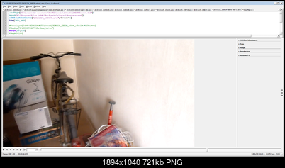

    Native frame :
Name:	138 native frame.png

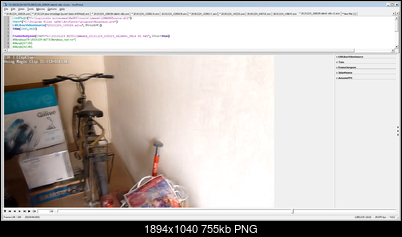

    FrameSurgeon :
Name:	138 FrameSurgeon.png

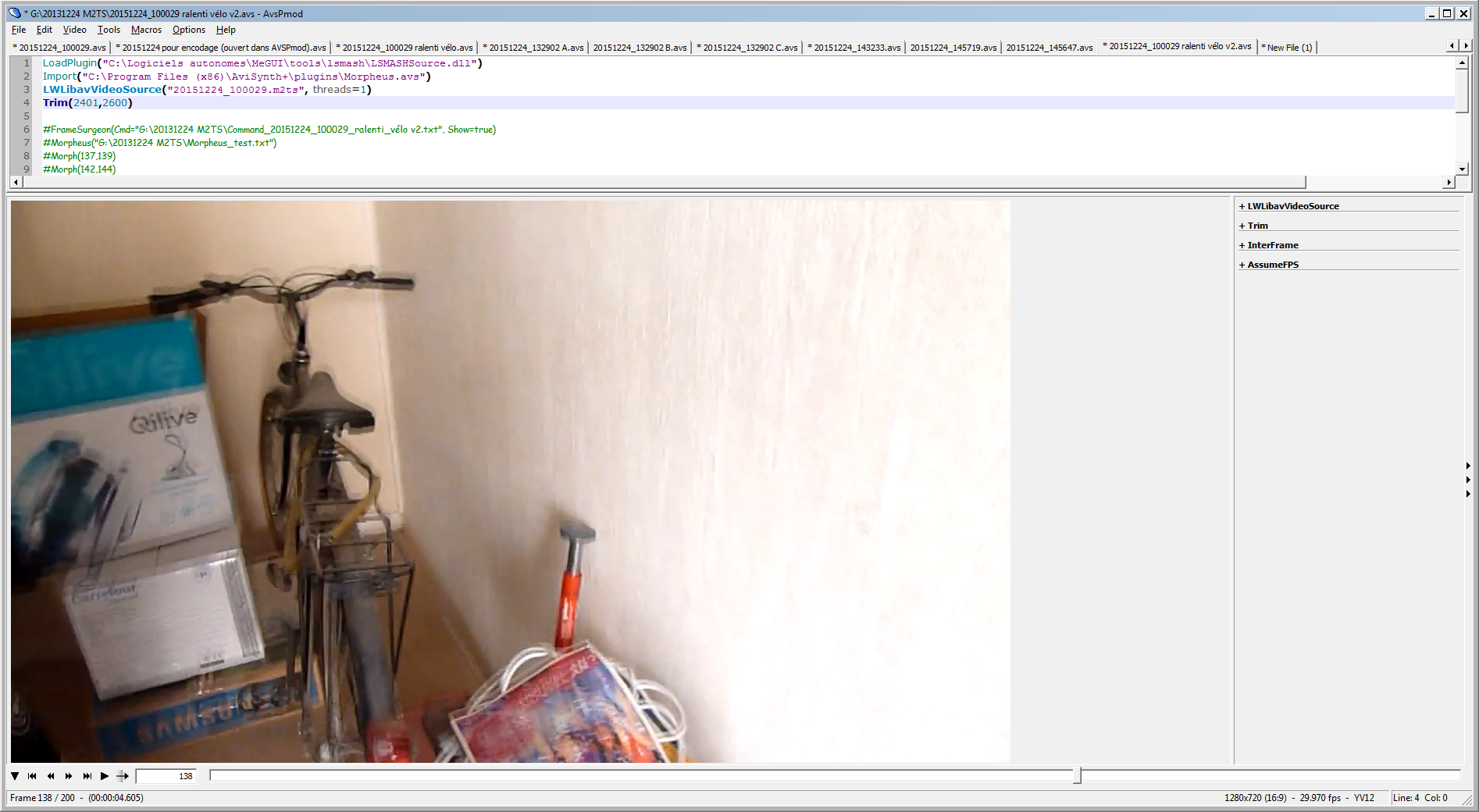

    Morph :
Name:	138 Morph.png

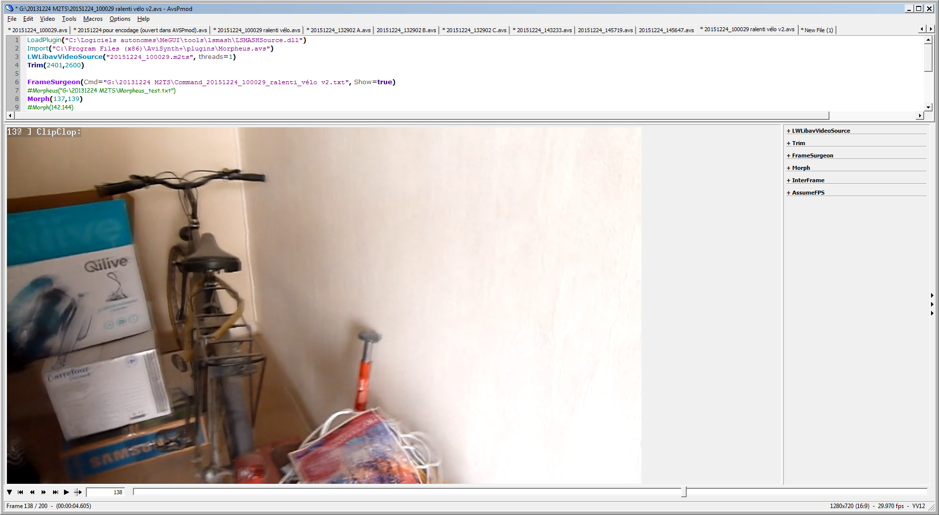

    Morph after FrameSurgeon with “show=true” (the front of the bike seems more straight, the letters on the box are clearer – but there are some extra artifacts on the bike's left handle) :
Name:	138 Morph after FrameSurgeon, “show=true”.png

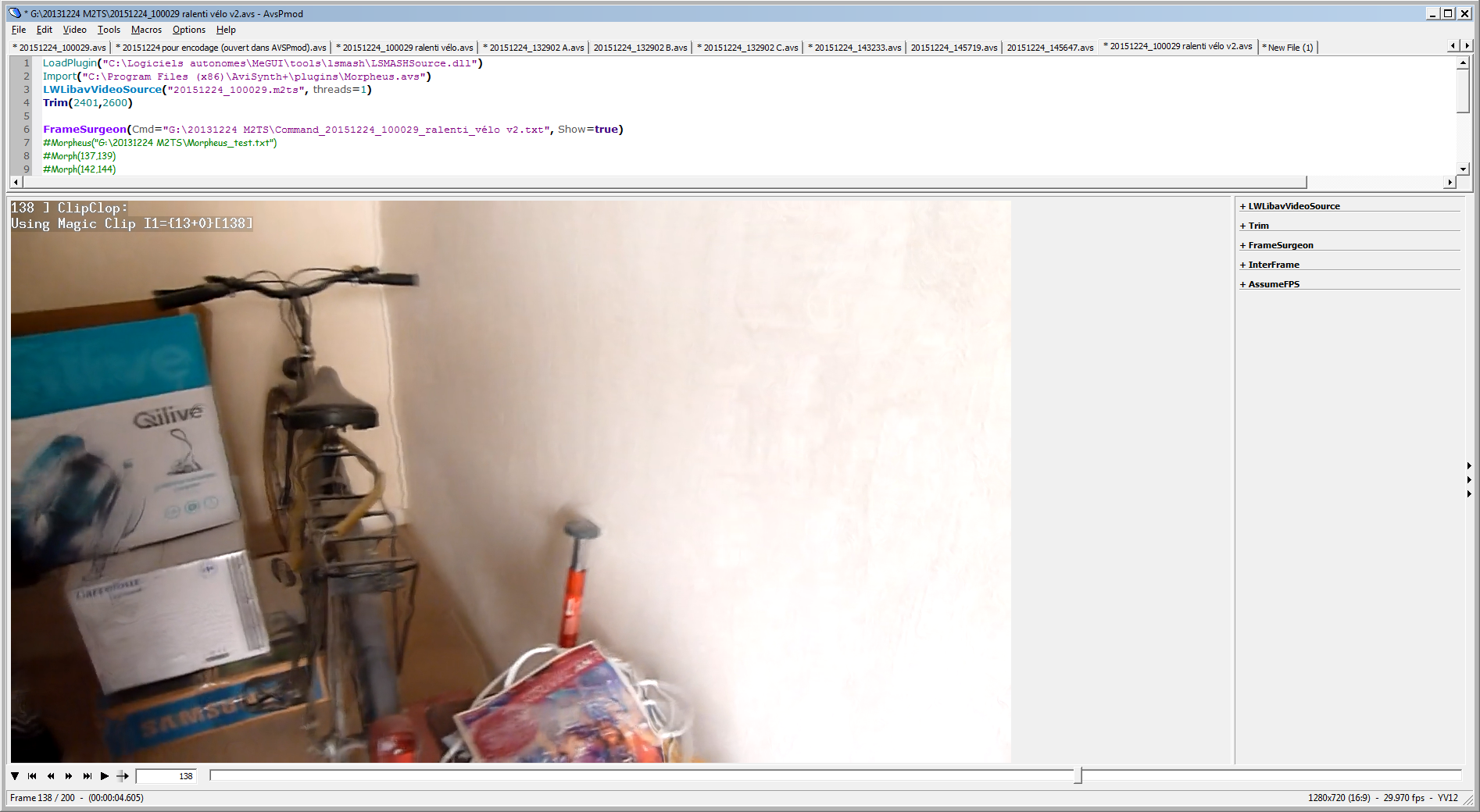

    Morph after FrameSurgeon with “show=false” (identical to Morph alone) :
Name:	138 Morph after FrameSurgeon, “show=false”.png
    Morpheus (similar to FrameSurgeon on this frame, better in some areas, like the wall corner, but worse elsewhere, like the text on the box, hard to say which one is better overall) :
Name:	138 Morpheus.png
