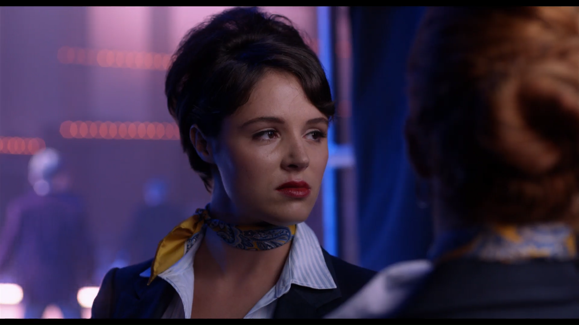

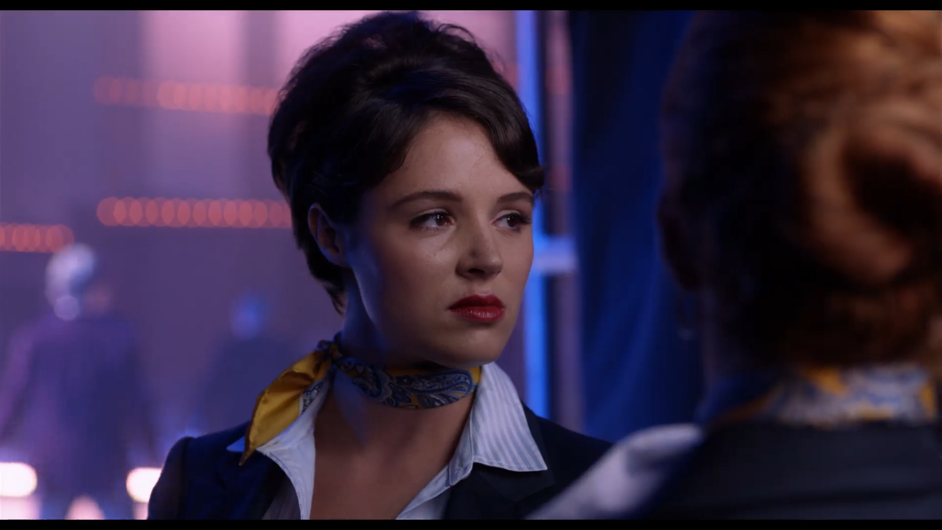

    Any Video Converter -- about 2 to 3 years. I simply wanted to free up harddrive space with all the DVR recordings through Windows Media Center. Watch and purge. Didn't care much about keeping anything. Went strictly with bitrate encoding. Anything to knock down those 5 to 10 to 15 GB per episode/shows recordings.

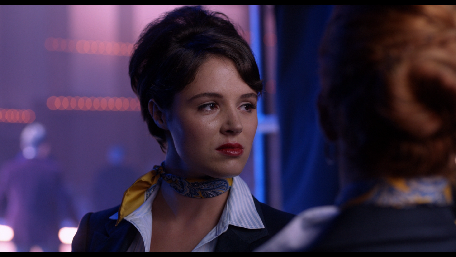

    Screenshot definitely don't tell the whole story. Things in motion is what counts. Pitch Perfect 32GB Blu Ray down to about 1.7GB (Any Video Converter, 2000bitrate encoding, everything else default setting) or 2.6GB (3000bitrate). One's 32GB, one's 2.6GB the other is 1.7GB. 264 encoding. I heard about 265 encoding about a month back, but it has compatibility issue on my ipad, so I'm not going down that route. The files encoded with Any Video Converter was always larger than any of the below programs. So I no longer use AVC.

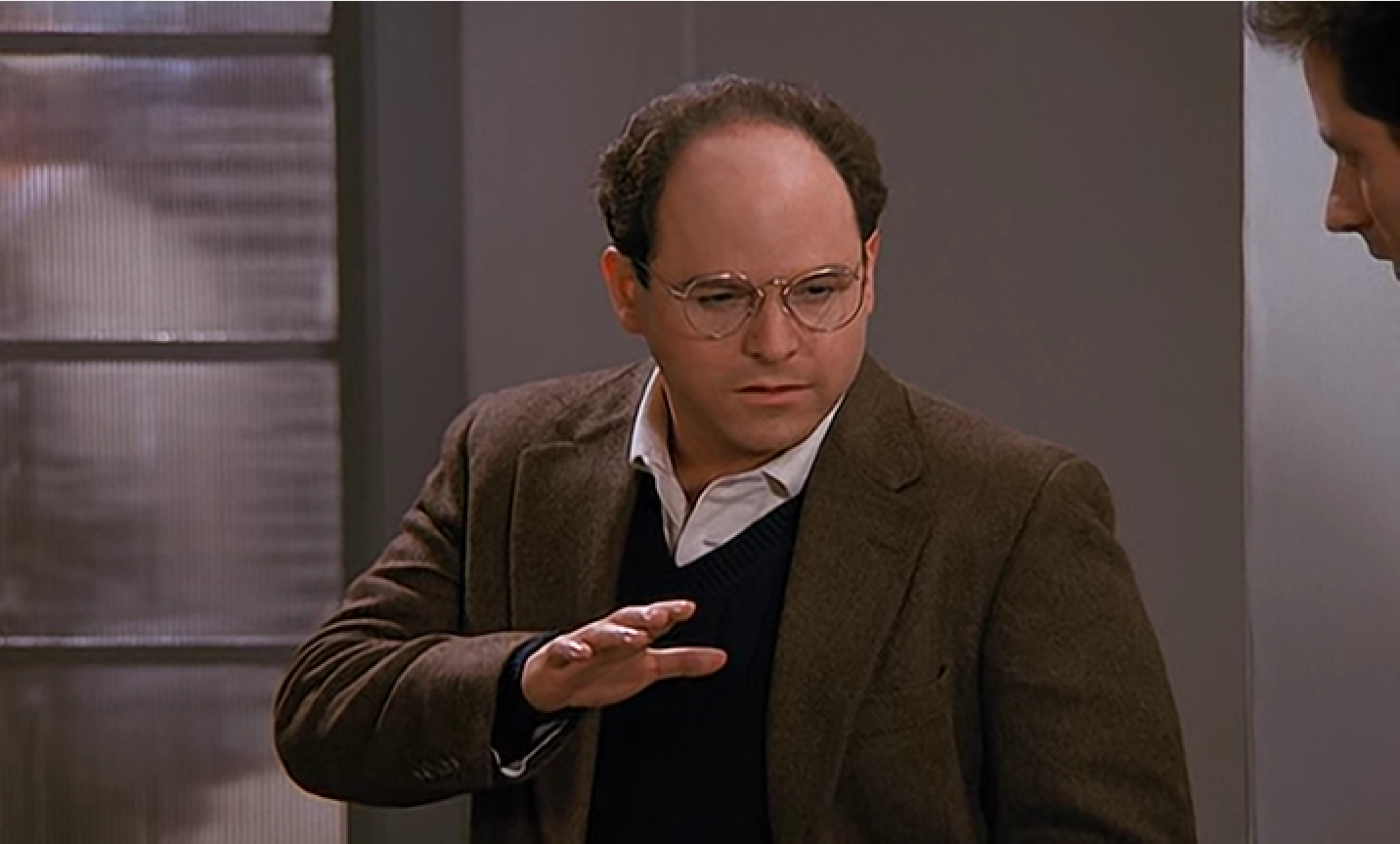

    You can probably figure out which one is which but to me it was good enough for my Ipad.
    [Attachment 45510 - Click to enlarge]
    [Attachment 45512 - Click to enlarge]
    [Attachment 45511 - Click to enlarge]

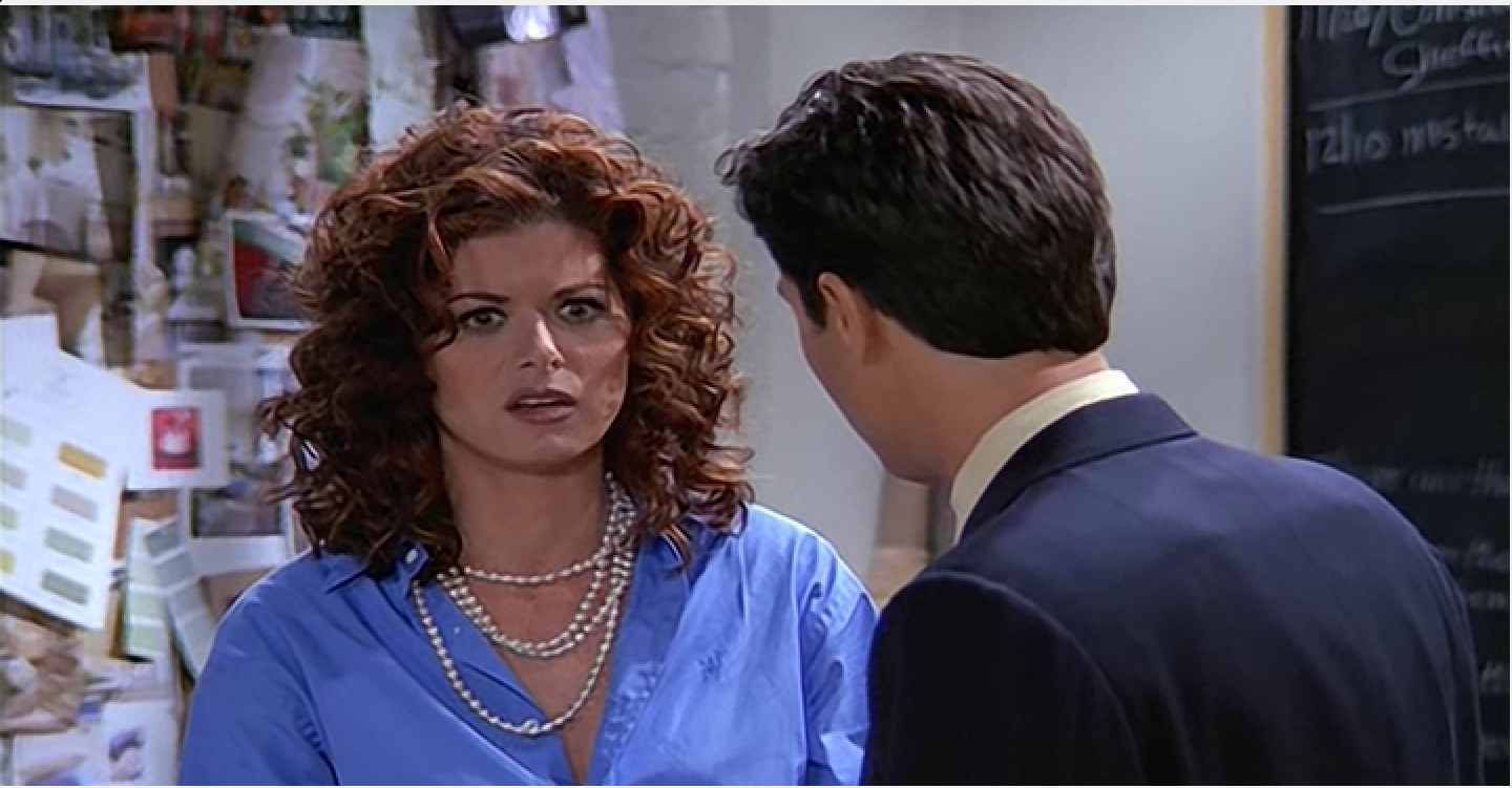

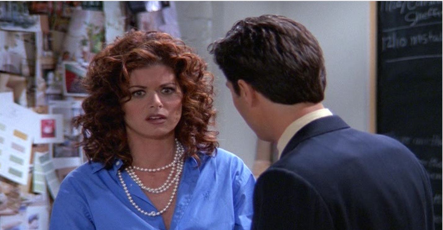

    Here's my beginner's attempt at using Avisynth. And it really depends on your "taste" as far as how the video looks after applying certain filters. Some individuals may not (and will not) like the way my Avisynth processed image looks. My purpose was to increase the sharpness of the video to play on my iPad. So, if I were to simply use Handbrake or some of the other easier to use ones (i.e. handbrake, vidcoder, etc.) even if I push the bitrate as high as it can go or even using a CRF14, I doubt I can really do much to "increase' the sharpness of the original DVD. Avisynth at least allow me to make things appear "high definition-ish." But you really can't call it high definition. It's just adding filters to give it a pseudo enhancement. Again, this is my newbie way of looking at things. I might be completely wrong with everything I wrote up top. So just take it with a grain of salt.
    To the veterans or anyone: Yes, I am open to suggestion on what I can do to improve the image, as well as changing the code to improve things.

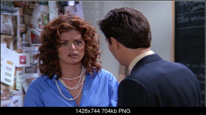

    VOB original (DVD source)
Name:	WillGrace a no filter.png

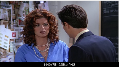

    Avisynth
Name:	WillGrace a yes filter.png

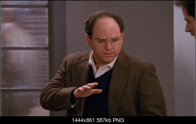

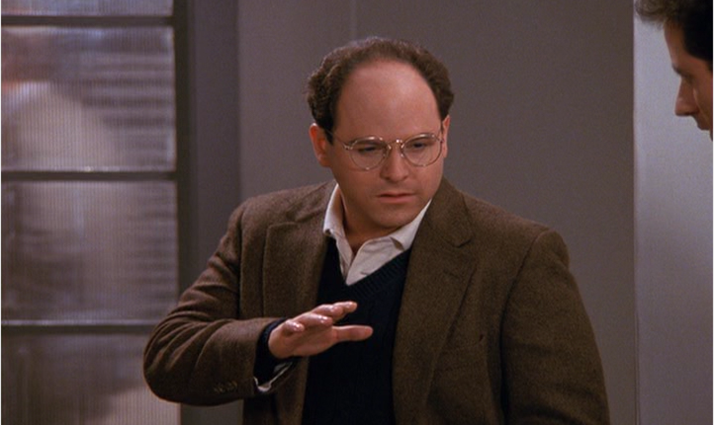

    VOB original (DVD Source)
Name:	Seinfeld b (DVD no filter).png

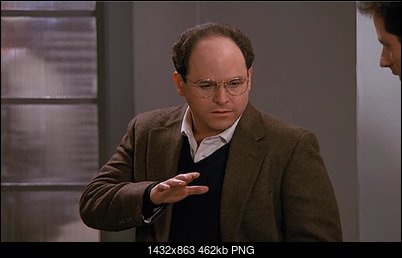

    Avisynth
Name:	Seinfeld b (DVD yes filter).png
    Avysinth code. It's really just about copying and pasting codes and using AVSPMod to get an immediate preview of the filters applied. You don't need to know anything about coding really.
    MPEG2Source("T:\Sitcom - Will & Grace DVD\Will & Grace S1 D1 Ep2 - A New Lease on Life.d2v", cpu=0)
    TFM()
    TDecimate()
    LoadPlugin("C:\Program Files\AviSynth+\plugins64\RgTools.dll")
    FFT3DFilter(sigma=1.5, plane=0, bw=16, bh=16, ow=8, oh=8, sharpen=0.4)
    FFT3DFilter(sigma=3, plane=3, bw=16, bh=16, ow=8, oh=8, sharpen=0.4)
    Import("C:\Program Files\AviSynth+\plugins64\LimitedSharpenFaster.avsi")
    LimitedSharpenFaster(ss_x=1.5, ss_y=1.5, edgemode=1, strength=255)
    LoadPlugin("C:\Program Files\AviSynth+\plugins64\SangNom2.dll")
    Hysteria(strength=1)
    awarpsharp(5)
    Santiag(3,3)
    LoadPlugin("C:\Program Files\AviSynth+\plugins64\nnedi3.dll")
    nnedi3_rpow2(rfactor=2,nsize=4,cshift="spline36resize",fwidth=720,fheight=480)
    FastLineDarkenMOD(strength=1)
    Tweak(hue=-3)
    Updated Code: Not sure if I"m suppose to "import" and "loadplugin" every single filter that I'm using. Did it anyway and the .bat batch code still works.
    if not exist WillandGraceCRF23LLLLLLLL md WillandGraceCRF23LLLLLLLL
    for %%A in ("*.VOB") do (
        "C:\Program Files (x86)\AMVpack\DGMPGDec\DGIndex.exe" -i "%%~A" -o "%%~dpnA" -fo 0 -om 2 -exit
        echo Mpeg2Source("%%~dpnA.d2v", CPU2="ooooxx", Info=3^) > "%%~A.avs"
        echo TFM(d2v="%%~dpnA.d2v"^) >> "%%~A.avs"
        echo TDecimate(^) >> "%%~A.avs"
        echo Import("C:\Program Files\AviSynth+\plugins64\LimitedSharpenFaster.avsi"^) >> "%%~A.avs"
        echo Import ("C:\Program Files\AviSynth+\plugins64\Hysteria.avsi"^) >> "%%~A.avs"
        echo LoadPlugin("C:\Program Files\AviSynth+\plugins64\aWarpSharp.dll"^) >> "%%~A.avs"
        echo LoadPlugin("C:\Program Files\AviSynth+\plugins64\SangNom2.dll"^) >> "%%~A.avs"
        echo Import ("C:\Program Files\AviSynth+\plugins64\FastLineDarkenMOD.avsi"^) >> "%%~A.avs"
        echo LoadPlugin("C:\Program Files\AviSynth+\plugins64\nnedi3.dll"^) >> "%%~A.avs"
        echo LimitedSharpenFaster(ss_x=1.5, ss_y=1.5, edgemode=1, strength=255^) >> "%%~A.avs"
        echo Hysteria(strength=1^) >> "%%~A.avs"
        echo awarpsharp(5^) >> "%%~A.avs"
        echo Santiag(3,3^) >> "%%~A.avs"
        echo FastlineDarkenMOD(strength=1^) >> "%%~A.avs"
        echo Tweak(hue=-3^) >> "%%~A.avs"
        echo nnedi3_rpow2(rfactor=2,nsize=4,cshift="spline36resize",fwidth=720,fheight=480^) >> "%%~A.avs"
        "C:\Program Files\ImageMagick-7.0.2-Q16\ffmpeg2.exe" -i "%%A.AVS" -i "%%A" -map 0:0 -map 1:a:0 -y -c:v libx264 -preset veryslow -tune film -crf 23 -vf hqdn3d,setsar=sar=8/9 -c:a copy "WillandGraceCRF23LLLLLLLL\%%~nA.mp4"
        del "%%~nA*.AC3"
        del "%%A.AVS"
        del "%%~nA.d2v"
        del "%%~nA.d2v.bad"
        del "%%~nA.fix.txt"
    pause
