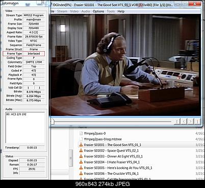

    I say the source is interlace 29.970 because playback on my PC, I notice these lines across the screen as the individuals moved. Mediainfo also says the original VOB file is 29.970. I also want to deinterlace because I don't like seeing the lines on my ipad during playback.
    Do I need to change the encoding FPS from 29.970 to 59.94 by adding -r 60000/1001 to the beginning of the code when I deinterlace? If the source is 23.976 (fps=24/1001), should I add -r 50000/1001 to the beginning of the code when I deinterlace?

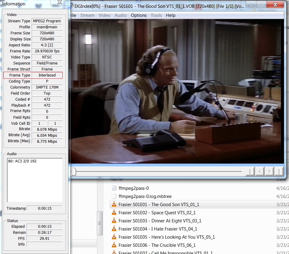

    Will & Grace original DVD vob source
    video
    Format                                   : MPEG Video
    Format version                           : Version 2
    Format profile                           : Main@Main
    Format settings                          : CustomMatrix / BVOP
    Format settings, BVOP                    : Yes
    Format settings, Matrix                  : Custom
    Format settings, GOP                     : M=3, N=12
    Duration                                 : 83 ms
    Bit rate mode                            : Variable
    Maximum bit rate                         : 9 000 kb/s
    Width                                    : 720 pixels
    Height                                   : 480 pixels
    Display aspect ratio                     : 4:3
    Frame rate                               : 29.970 (30000/1001) FPS
    Standard                                 : NTSC
    Time code of first frame                 : 00:59:59;00
    Time code source                         : Group of pictures header
    GOP, Open/Closed                         : Open
    GOP, Open/Closed of first frame          : Closed

  2. If you have lines on playback, simply enable "deinterlacing" in your media player. No need to change the video itself.
    May 2016
    I understand I could do that with VLC, but I simply prefer to deinterlace so I don't have to worry about it. I'm keeping the original VOB, but encoding the video to a smaller size for playback on my 12.9 ipad which only has a maximum capacity of 512GB.
  4. I think it's "-vf yadif=1" or "-vf yadif=mode=1" to get double frame rate.
    May 2016
    Cool -vf yadif=1 worked, but do you (or anyone) happen to know if that's how to "properly" deinterlace videos with interlaced lines?

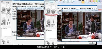

  6. Originally Posted by strawberryshortcake View Post

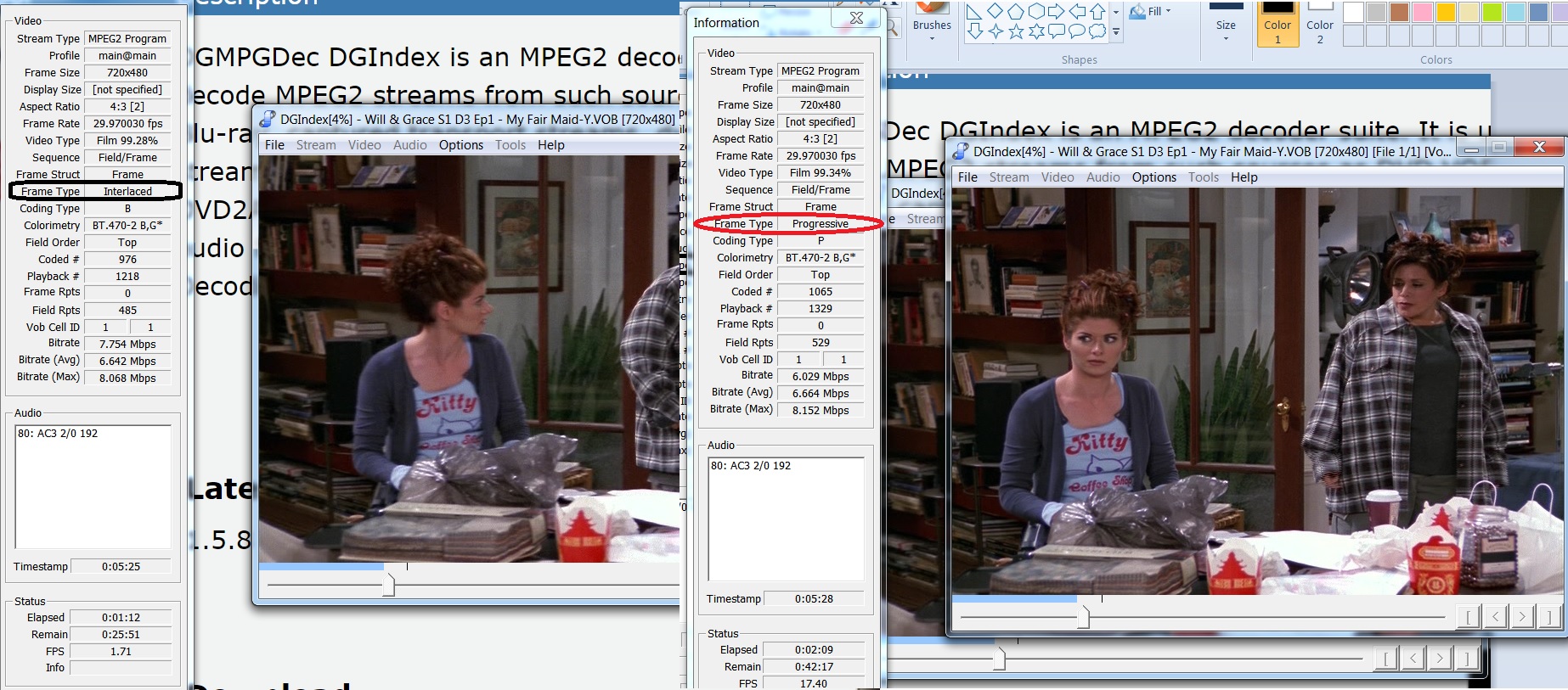

    It depends on the specific video, or what's causing the "interlaced lines" in the first place
    If it was "Will & Grace original DVD vob source" as in your 1st post, you might need to IVTC instead of deinterlacing. I think it was actually a sitcom shot at film rates, not a "video" like a soap opera
    May 2016

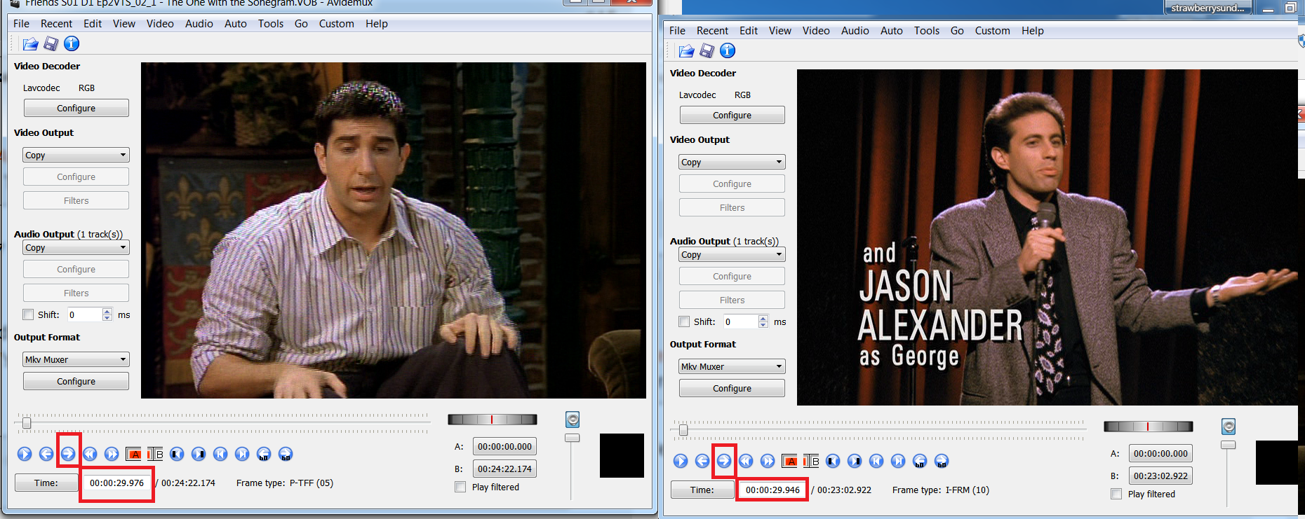

    Is there a way to determine what's causing the interlaced lines using mediainfo?
    Basically is there a flow chart of sort to determine what causes the interlace and from there use ___ such and such technique?
    IVTC? I guess I'll need to do some internet/forum search to see what that's all about. I thought all deinterlacing method were universal (i.e. just pick one and go with it -- that's kind of what i thought initially).
    I've got Seinfeld, Will and Grace, Frasier, Friends, Everybody Loves Raymond that I can recall off the top of my head that I would like to encode to smaller file size.

    So am I suppose to use DGIndex to reencode the VOB files or which reliable program do I use to 'deinterlace' those lines? What about MeGUI?
    Using DGIndex, under frame type,
    Will and Grace flickers continuously between progressive and interlace
    Frasier keeps saying interlace

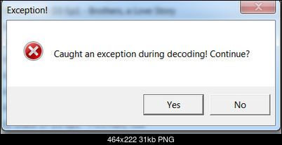

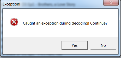

    I also get this error message when I load the MeGUI converted Will and Grace file. Maybe the program only works on original source? How do I determine the source if it's a file that has already been encoded?
Name:	MeGUI will and grace converted file.png
  12. You can check quickly to see if your exported 29.97 file was actually 23.976 "filmrate". You can open it up in vdub2 or avidemux and go frame by frame. If the rate was supposed to be 23.976, you will see every 5th frame is a duplicate . The playback will be jerky . You're also encoding 25% more frames for nothing (it's not 25% worse, temporal compression doesn't work like that , duplicate frames don't "cost" very much) .
    Frametype there just tells you how it's encoded. Again, it's not confirmation of what it actually is in terms of content. But in that 2nd Will and Grace screenshot, if it's >99% film and progressive, you can probably "force film" . All this stuff is covered in other posts, there should be some guides as well
    Sometimes you can have bizzare things, mixed content. IIRC Some seasons of Frazier were very tricky with aliasing
    Yes you can use Megui ; it also has an "auto analysis" but it's not always correct either.
  13. Originally Posted by strawberryshortcake View Post
    [Attachment 45335 - Click to enlarge]
    I haven't used megui in a few years but not sure, never seen that before. Maybe it wasn't decrypted properly ?
    You can use megui on anything, but it uses avisynth in between, so you need a script. It should create a script for you if you use it correctly
    megui is not the easiest to use, but there should be step by step guides out there

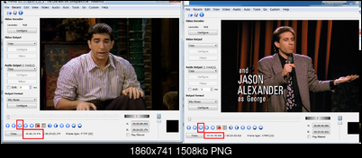

    I did a quick frame by frame test in Avidemux (already had this) as you suggest for Seinfeld, Fraiser, Friends, and Will and Grace. There are no duplicate frames at all.
    I'll be running around the internet to read about IVTC, but in the meantime, what program do you use to IVTC?
  15. Originally Posted by strawberryshortcake View Post
    On the exported deinterlaced file at 29.97 ? Yes , with all the info here, there should be a duplicate every 5th frame at 29.97.
    That 99.34% film and "progressive" encoding screenshot of W&G is the 1 case where you can be reasonably sure automatically, because it's soft pulldown. This means it's encoded progressive, and "flags" signal repeat fields to output 29.97 interlaced. But it's actually progressive content, and progressive encoding.
    The other ones that say "interlaced" are likely progressive content, but interlaced encoding - that's known as "hard telecine" because the actual field repeats are hard coded or actually encoded
    I use avisynth. For mpeg2 sources , like DVD, dgindex.

    Maybe I'm not doing the test correct, but I simply loaded each video VOB file into Avidemux, use the right arrow on the keyboard (or the blue arrow, next frame). I tried it at zero, then went to 29 seconds, etc.
    https://www.youtube.com/watch?v=8nHXIPw6VU4&feature=youtu.be
    Am I suppose to be looking/using those .... just using the right next frame arrow for many frames in a row and nothing is duplicated.
Name:	Avidemux frame test.png

  24. Geez, it says you're in the US so I can only assume English is your first language. Did anyone say anything at all about YouTube? Please upload the M2V you got from DGIndex here. To this site. There's an upload button. And 10-15 well chosen seconds will be plenty. Two minutes is neither wanted nor needed.
    Move the DGIndex slider to an appropriate start place and hit '['. Move the slider further along and hit ']'. Go File->Save Project File and Demux Video. Upload the resulting M2V file here.
    Edit: The Fraser YouTube video has duplicate frames every 5th frame. From that we know it was shot on film. What we can't learn is if it's soft or hard telecine. Which it is determines how it's to be treated. Hard telecine has the 3:2 pulldown encoded into the video and is encoded as interlaced 29.97fps. Soft telecine has the 3:2 pulldown added as flags telling the DVD player how to display the fields and is encoded as progressive 23.976fps. There's a big difference there and a YouTube version is worse than useless in telling which it is.
  25. Member
    May 2016
    Apologies. Yes, United States. I was looking for some type of attachment and notice the "insert video" icon asking for website link, thus youtube initially.
    Fixed uploading with a 17 second clip, at about 3:30 mark into the first episode of Frasier.
  26. Member
    May 2016
    A couple more, probably not necessary, but Frasier supposedly is "different" from what I may have read.
  27. Okay, now we're getting somewhere. Thank you. The first one - Frasier S01E01 NEXTTEST.demuxed.m2v - is hard telecine and just needs an easy IVTC:
    TFM().TDecimate()
    That's from TIVTC. I couldn't tell you if you can IVTC in ffmpeg as I don't (and won't) use it. If you're serious about your video encoding hobby, in my opinion it's in your best interests to learn your way around AviSynth.
    I noticed from the YouTube one that the intro is real 29.97fps. I don't know if it's pure interlace or progressive (probably the former). In any event, the part where the buildings are drawn will be slightly jerky. It's very short and, in my opinion, doesn't matter. I would make my D2V file in DGIndex using 'Honor Pulldown Flags' and then IVTC it in an AviSynth script. Maybe others have other suggestions. If the goal is to make another DVD, then there's other solutions that can keep the 29.97fps parts as 29.97 and the 23.976fps parts as 23.976.
    Now to check the others...
  28. Will And Grace was shot on film and isn't hard telecined. However, it was edited as video and that presents problems. I'd make the D2V using 'Honor Pulldown Flags' and make the script like this:
    TFM(D2V="Will & Grace S1 D1 Ep2 - A New Lease on Life NEXTEST.demuxed.d2v").TDecimate
    That allows TIVTC to treat the soft telecined parts as film (no IVTC needed) and just IVTC's the video portions. It's not a bad way to handle everything as, unless the bottom of the D2V file shows as 100% FILM, and you can Forced Film it in DGIndex and get an immediate progressive 23.976fps video file with no need of an IVTC, you might be better off doing it this way. The D2V setting is thoroughly explained in the docs included with TIVTC.
    Seinfeld was shot on film and hard telecined, like Frazier. It needs a full IVTC to return the original progressive 23.976fps frames.
    Friends, same thing, hard telecine.
    Note that none of these get deinterlaced (except for some orphaned fields and any intros that might be pure interlaced 29.97fps). The fields are reassembled into their frames and the duplicate frames are removed. As pdr mentioned earlier, you do not want to blindly deinterlace when it's not necessary. However good the deinterlacer is, it's still not as good as getting back the original progressive frames.
  29. Member
    May 2016
    Good thing I posted otherwise I would have gone down the wrong path, which I've already done by encoding episodes of Seinfeld, Will and Grace and Frasier using yadif. Time to start over and use Avisynth.

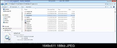

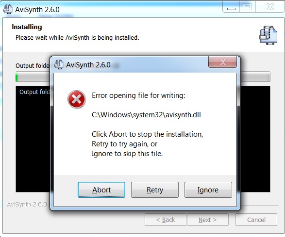

    I tried to install it but coming up with an error message. I simply aborted the installation process.
Name:	avisynth install problem a.jpg

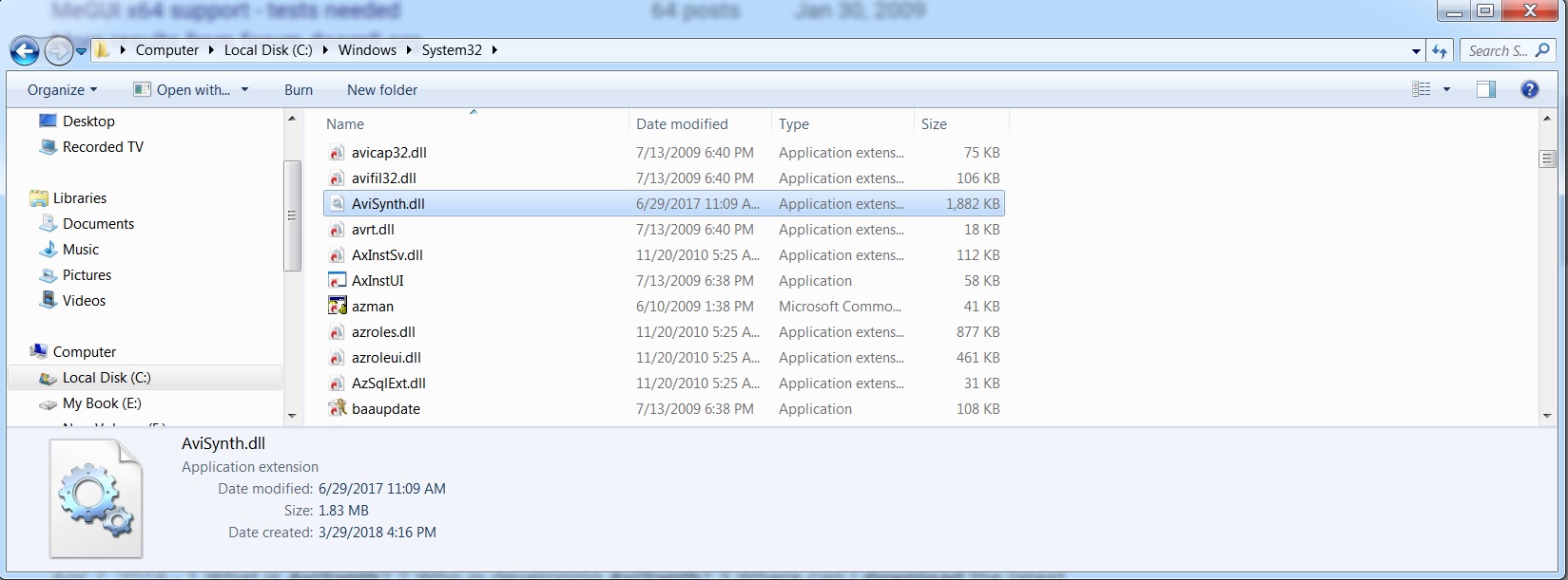

    The following Windows System folder has AviSynth.dll present. How I came upon this was googling the error message
    windows\system32\avisynth.dll forum issues
    xtrill user of videohelp mentioned deleting the AviSynth.dll file. Instead of deleting I simply moved it to the desktop. I didn't want to mess anything up. But the installation process still prompted the error message.
    https://forum.videohelp.com/threads/328805-Unable-to-install-avisynth-Error-opening-file-for-writing
Name:	avisynth install problem b.jpg

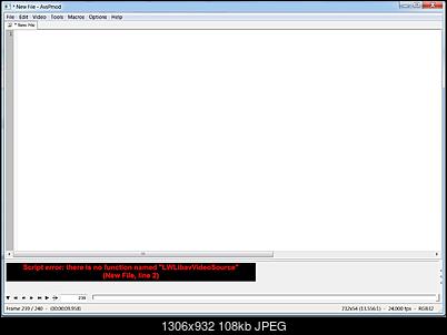

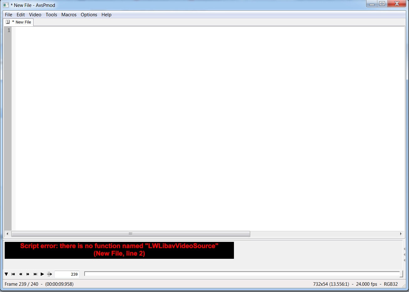

    I can open avsPmod, does that mean I already have avisynth installed? Youtube tutorial is few and far between for beginners when it comes to Avisynth.
Name:	avisynth install problem c.jpg
    I've got to go to bed soon/ like now. But I'll be back.
    EDIT: I also downloaded the TIVTC file all the way at the bottom. Unzipped but not really sure what to do. Basically trying to figure out how to even start using avisynth. Is it a program like handbrake, megui, or ffmpeg typing command lines.
    This: http://avisynth.nl/index.php/TIVTC
  30. If your avisynth is installed correctly, just extract tivtc.dll to "C:\Program Files (x86)\AviSynth\plugins".
    To answer your question, Avisynth is a frameserver program that is controlled by scripting. Think of it like program that's doing something in the background and you feed output of that to some other program for encoding. It doesn't have its own GUI but you can use avsPmod that you mentioned as an editor and to preview the avs output. On the first page of the official site, there's section that explains the basics, it's not that hard.
    And don't mind if someone is a little impatient with you, guys like manono, poisondeathray, jagabo are very knowledgeable users that helped many people for many years and they probably answered this particular topic ("how to deinterlace DVD") probably hundreds if not thousands of times so it's a little tiresome for them to repeat common knowledge for the nth time. Everything is already answered here about DVD and IVTC many many times.
