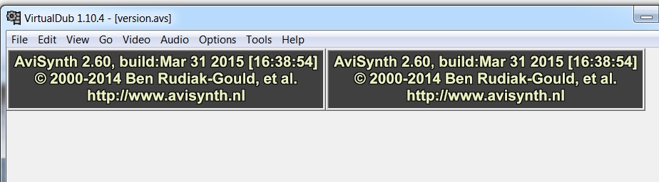

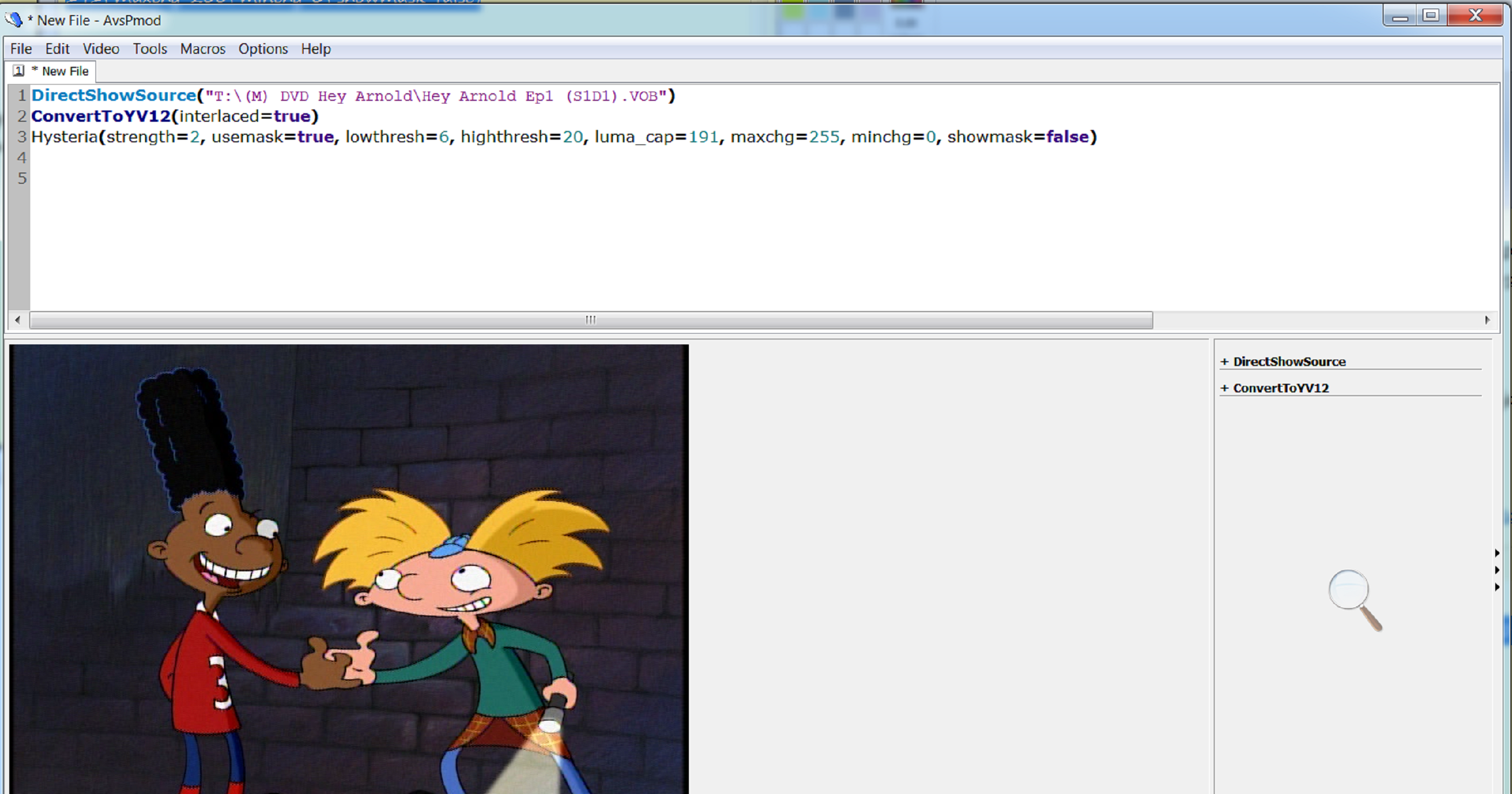

    Thread concern: I've copied the .dll file and .avsi file directly into my Avisynth folder, but I'm not even able to get AVSPmod to recognize the filter. There must be something that I'm doing incorrectly. Pictures below.
    I have Avisynth 2.6 installed.

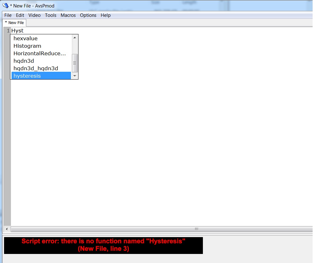

    The drop down tab in AVSPmod doesn't bring up "Hysteria" instead it bring up "Hysteresis" and I don't believe those two are the same. The command/script/or whatever it's called is:
    Hysteria()
    specific example (can be seen here: http://www.aquilinestudios.org/compare/hysteria.html
    Hysteria(strength=3.0,luma_cap=225)

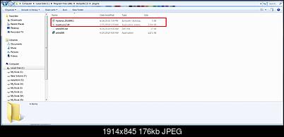

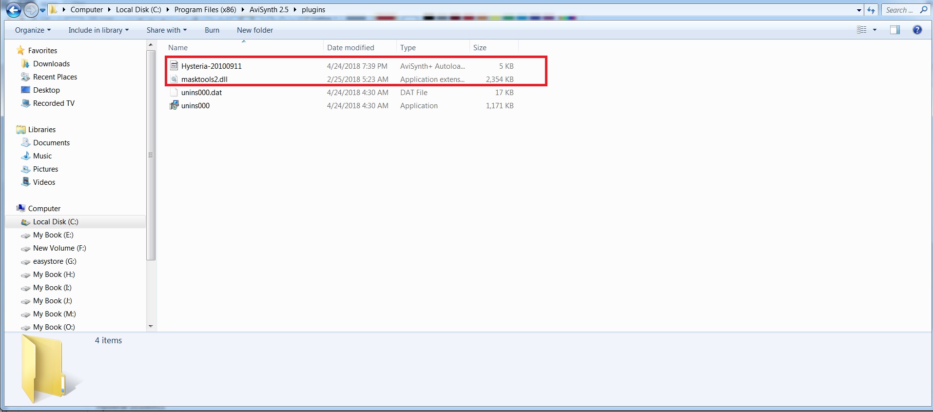

    The following "plugins" are in the AviSynth plugin folder (or are these referred to as something else, a different term). I have two AviSynth folders (AviSynth and AviSynth 2.5), so I figured I'll just put the Hysteria and masktools2.dll into both locations.
    Hysteria-20100911 (AviSynth + Autoload Script)
    masktools2.dll
    mt_masktools.dll
    mvtools2.dll

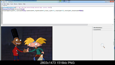

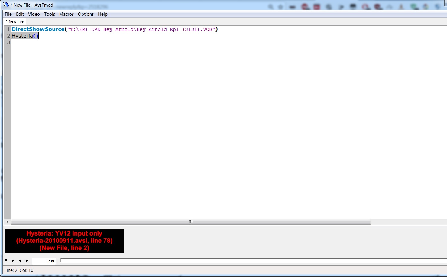

    Not exactly sure how to decipher it, but I get the following message in red letters in AVSPmod (#1 this is the original AVSPmod that I downloaded).
    Hysteria: YV12 input only
    (Hysteria-20100911.avsi, line 78)
    (New File, line 2)

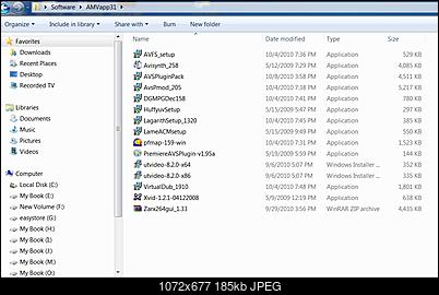

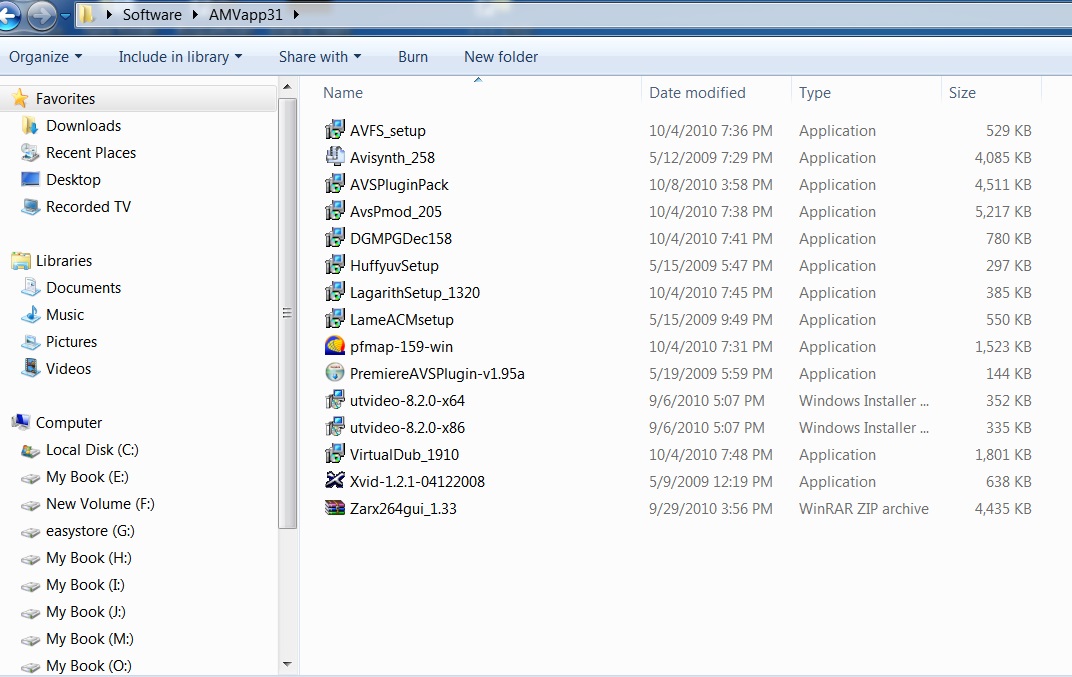

    I still want to know how to address or add in plugins (for future reference), but I decided to just go with the available installation pack for the time being found in the link below (animevideomusic.org) It worked, now I can do the hysteria thing; opening the AVSPmod that was packaged with the AMVpack worked. The drop down suggested menu tab shows "Hysteria".
    When I did install the AMVpack (double click on it), it did prompt me to install some type of Microsoft Redistribution thing or whatever it's called like you pointed out. I still have the AVSPmod (original #1) that still doesn't have the drop down suggestion for hysteria, it's still hysteresis, but with the new AVSPmod (#2) that was packaged with the AMVpack it does work with hysteria ()
    However, this doesn't really "teach me to fish" so to speak ; it's simply giving me the fish. Not going to know exactly how to properly "install" plugins.
    AMVpack 64bit version.
    https://www.animemusicvideos.org/forum/viewtopic.php?f=11&t=121948
    AMVpack is an installer package for all the tools commonly used for handling and preparing footage for use in making AMVs. This is similar to AMVapp but is more up to date and will have an expiration date so that old versions will not run. I plan to keep this as up to date as possible and will try to have one release a year to help maintain the latest usable versions of any particular item in the package.
    Download: Windows (x86/x64) / macOS / Sources
    NOTE: THIS PACKAGE EXPIRES AND WILL NOT INSTALL AFTER DECEMBER 31, 2018!
    I also don't quite understand the paragraph statements. It's set to expire, so does that mean after December 31, 2018, the program will stop working?

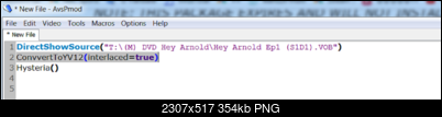

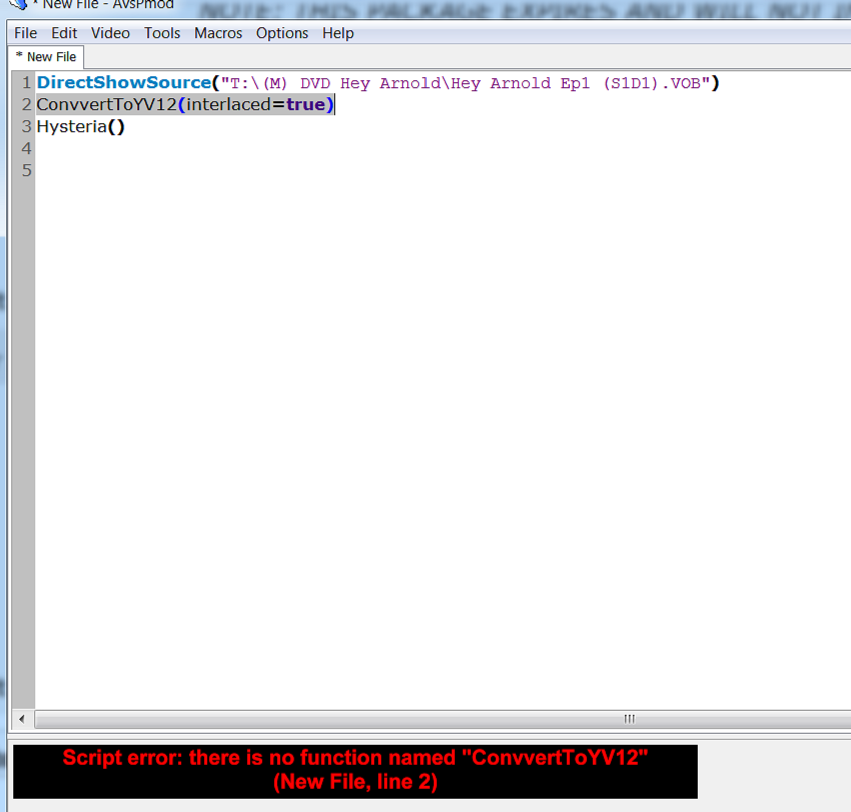

  4. The error message indicates Hysteria is installed but the video needs to be YV12, not whatever DirectShowSource() output. Add ConvvertToYV12(interlaced=true) between the two lines.
    May 2016

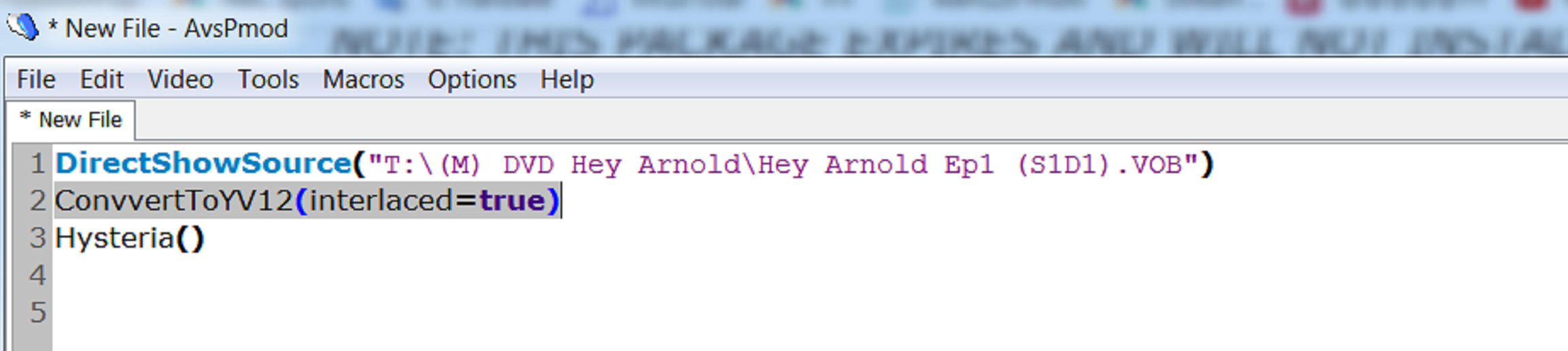

    Script error: there is no function named "ConvvertToYV12" (New File, line 2)
    [Attachment 45391 - Click to enlarge]

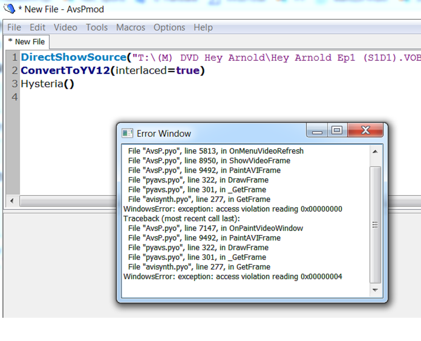

    Then I thought maybe I should take out the extra "v" inside "ConvvertToYV12," but then I get another strange error.
    [Attachment 45390 - Click to enlarge]
    Mar 2008

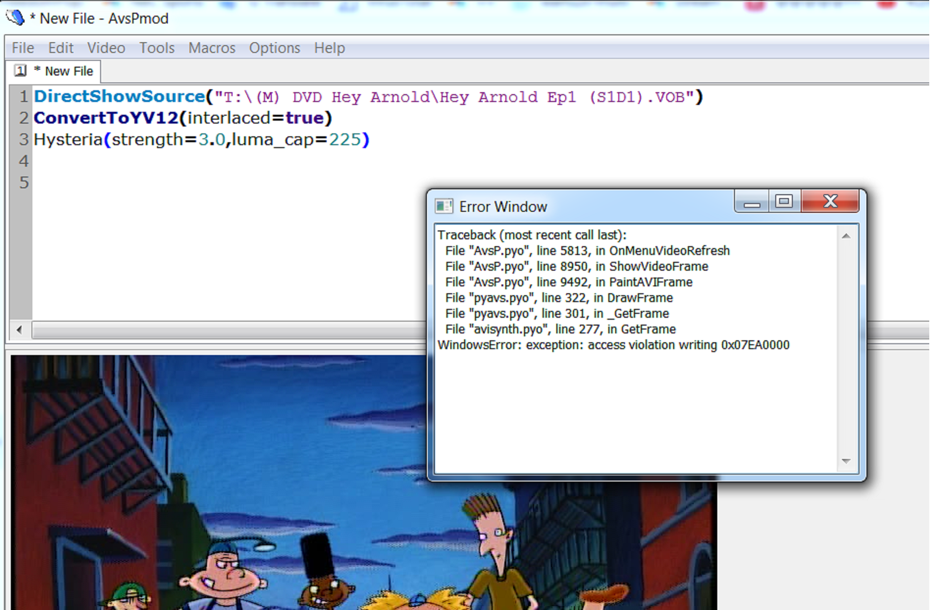

    AvsPmod crashed. Why don't you forget it for now, edit your scripts in Notepad and test them in Virtualdub2
  7. Originally Posted by strawberryshortcake View Post
    Oops. I typed too many v's.

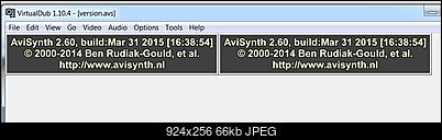

    That's is the correct solution. I don't know why the program crashed. Possibly a version incompatibility problem between masktools 2.0 and Hysteria?
    I tried it here with both 32 bit AviSynth (and 32 bit VirtualDub) and 64 bit AviSynth+ (and 64 bit VirtualDub). Both had no problems with an animated DVD source.

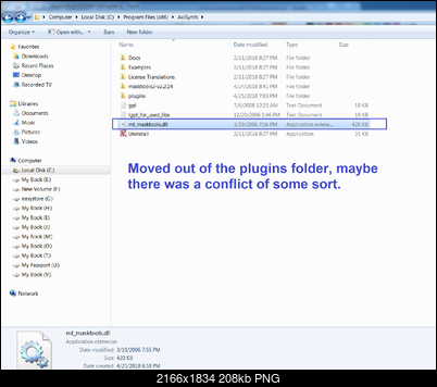

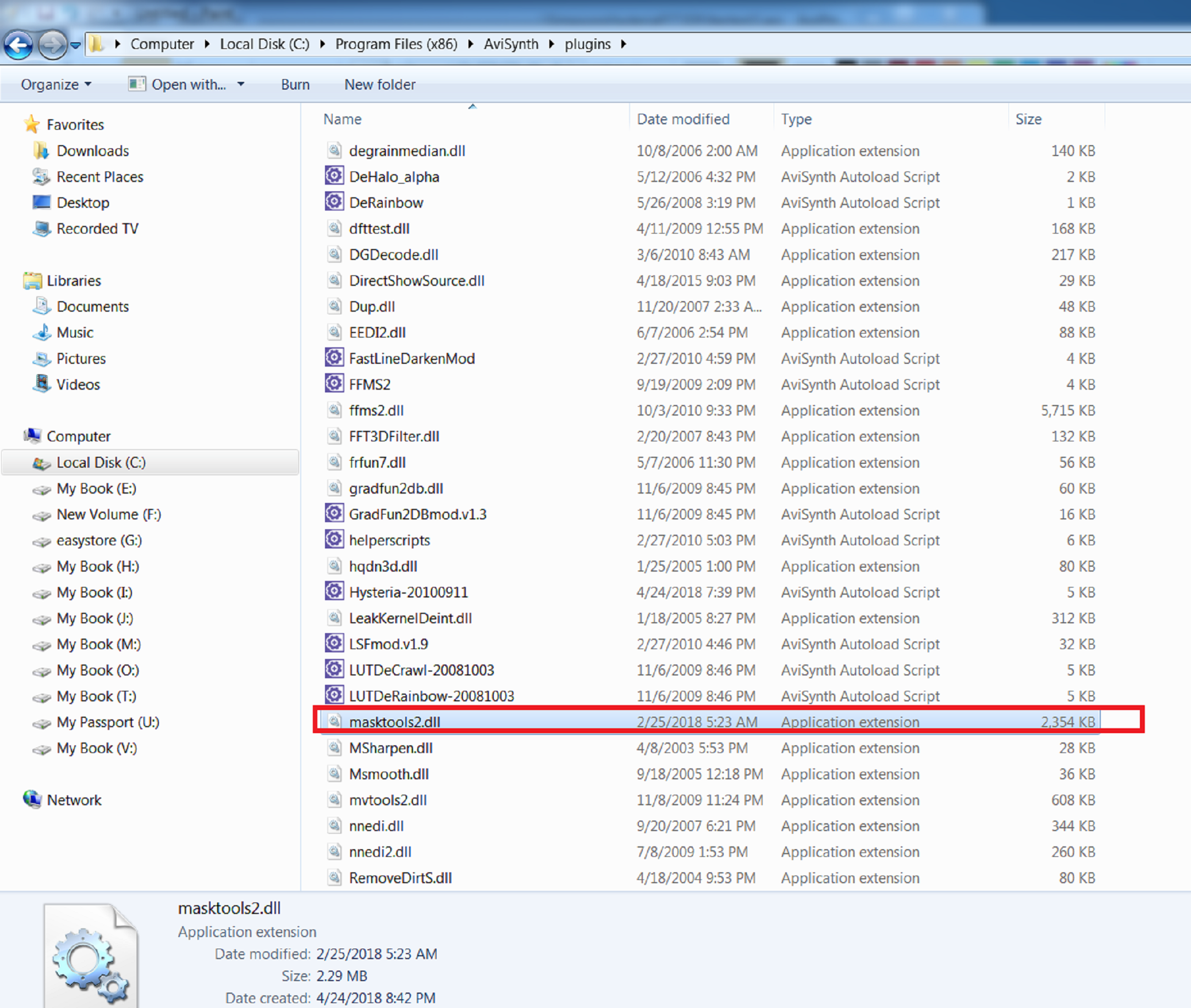

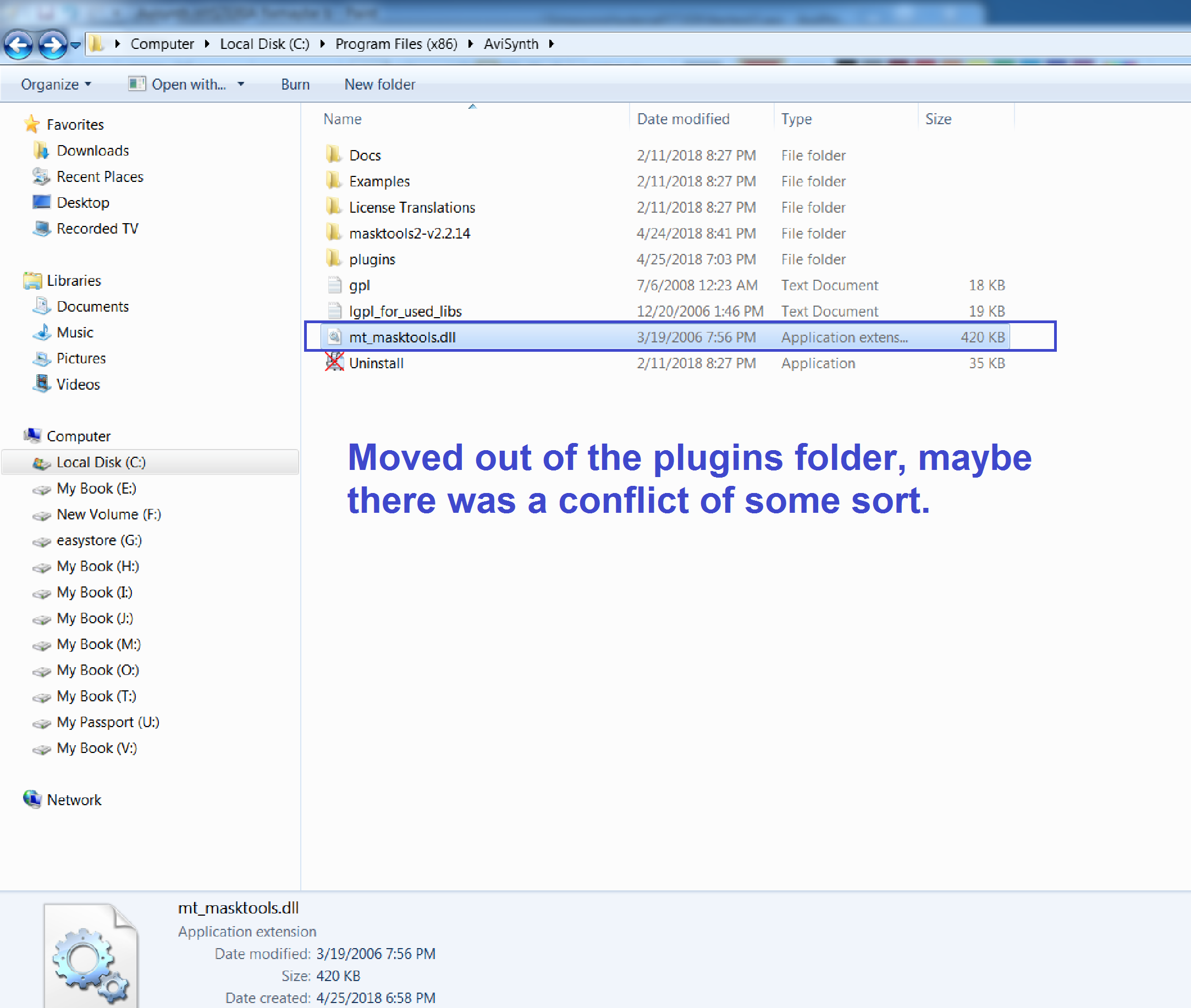

  8. That type of error usually means plugin autoload issue . Look at some of your old plugins , clean out the ones you don't need (just put them into a different folder). You have 2 versions of masktools. Put mt_masktools into a different folder .
    May 2016
    I'm still a complete novice to the world of avisynth. It's been less than a day of cumulative hours. The script and even the very first script is mostly a copy and paste job from seasoned veterans. I figured having the drop down menu in AvsPmod would be a good starting point; a guidance down the correct path of sort.
    I think it does boil down to a compatibility issue. I did exactly what poisondeathray suggested, moved "mt_masktools " to a different location and now your suggestion to insert ConvvertToYV12(interlaced=true), after hitting F5 works. No errors returned.
    Did exactly what you suggested there, moved mt_masktools outside of the plugin folder and now F5 to refresh/preview works.
    What I still don't understand is why the dropdown suggestion menu in AVSPmod (#1) still doesn't show Hysteria as one of the selectable choices. I figured as newbie to the world of AVSPmod/Avisynth, if the code word is available within the drop down menu, gets its own color and bolded when selected, then the plugin was correctly installed. I did type the following, press F5 and did see changes to the video image. So it works, but just wondering why the world Hysteria is not one of the available option in the drop down menu in AVSPmod (#1)
    Hysteria(strength=9, usemask=true, lowthresh=6, highthresh=20, luma_cap=191, maxchg=255, minchg=0, showmask=false)
    Yes, i have a working AVSPmod (#2) (that came packaged with AMVpack) that actually shows the drop down "Hysteria" function/feature/code or whatever it's called. It's bold and in blue letters while Hysteria typed in AVSPmod (#1) is black and the font is thin.
    Figure 1: Shows mt_masktools moved out of the plugin folder, and this did the trick.

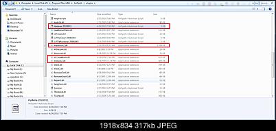

    Figure 2: Show masktools2.dll in the plugin folder along with hysteria
Name:	Avisynth HYSTERIA fixmaybe b.png
    Figure 3: Even though pressing F5 to preview works with the Hysteria code, I'm just wondering why "Hysteria" is not part of the suggested drop down menu.
Name:	Avisynth HYSTERIA fixmaybe d.png
    Figure 4: This was the error situation when I still had mt_masktools within the plugin folder of avisynth. Something was in conflicted.
Name:	Avisynth HYSTERIA fixmaybe a.png

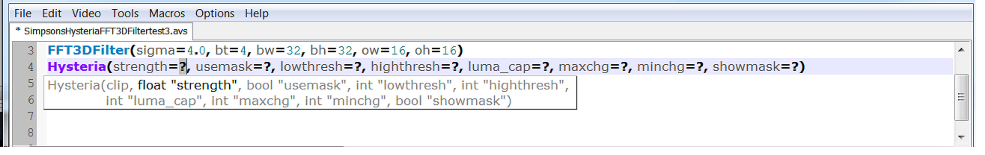

    AVSPmod (#2) Has the Hysteria drop down menu and all the settings shown, Hysteria font is colored, and bold
Name:	Avisynth HYSTERIA fixmaybe e.png
    AVSPmod (#1) Doesn't have the hysteria drop down menu, letters font is thin black.
Name:	Avisynth HYSTERIA fixmaybe f.png
    Question remains: I'm guessing I "installed" the .dll file sort of correctly (by copying and pasting it directly into avisynth plugins folder? And is this basically the way to do it with all plugins? Just copy and past the .dll file into the Avisynth plugins folder.
    And the same goes for something like this (random google search) .... just copy and past the .dll into the avisynth plugin folder.

  10. "dll hell" is an avisynth rite of passage . Nobody "levels up" until they waste hours cleaning up dll's
    [Attachment 45398 - Click to enlarge]
    [Attachment 45401 - Click to enlarge]

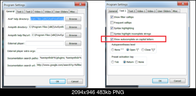

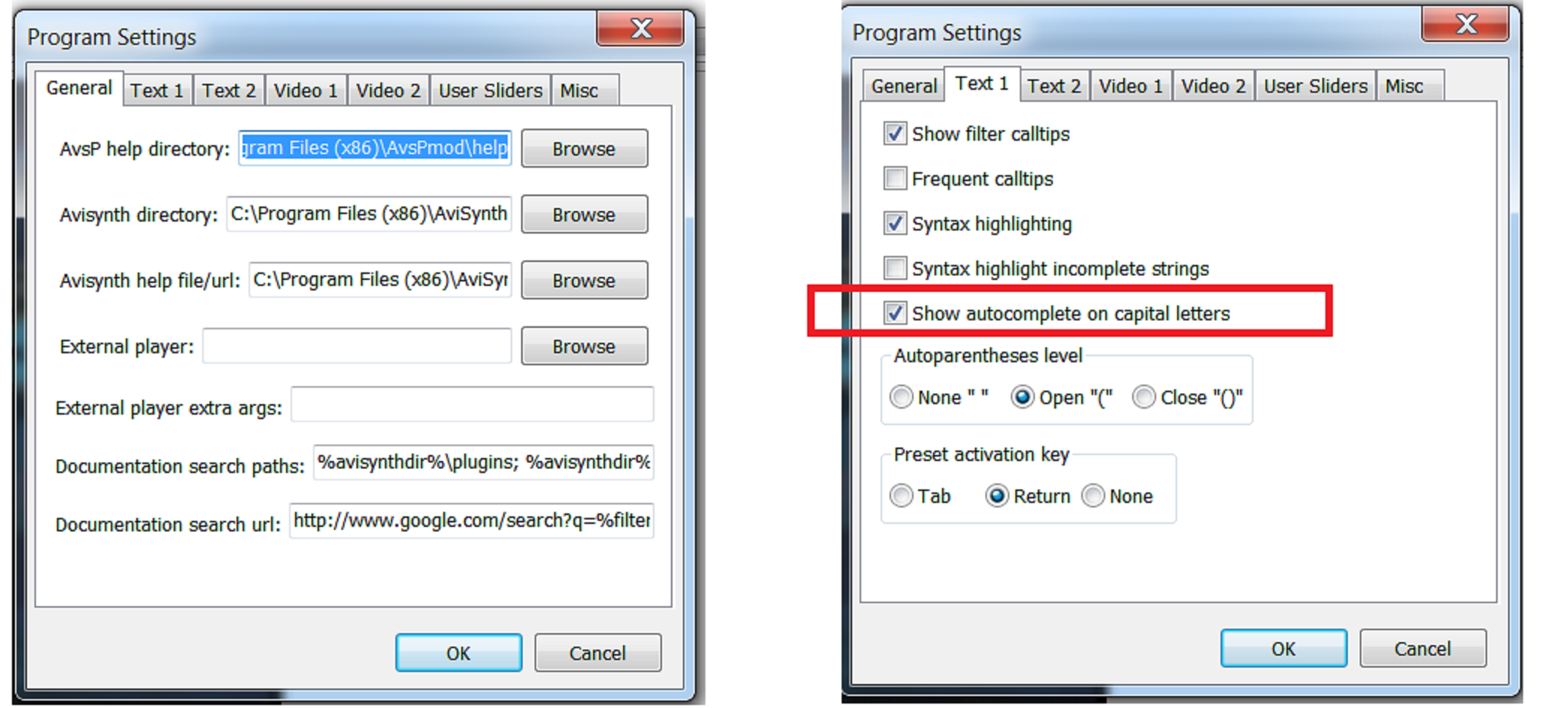

    Not sure what you mean ?
    Do you mean autofill / autocomplete ? It has to be either an autoloaded.dll or .avsi at runtime to load when you start avspmod . There are options to enable/disable. options=>program settings=> auto complete . It might be disabled partially in the one that doesn't work
    [Attachment 45404 - Click to enlarge]
    [Attachment 45405 - Click to enlarge]
    Yep, autofill and autocomplete is exactly what I meant. The AVSPmod (#1) won't autofill Hysteria. Options==> program settings==> but didn't see auto complete button. The only place with autocomplete was .... None of the other tabs had autocomplete
Name:	Avisynth HYSTERIA fixmaybe g.png
  12. It's probably just an older version. Just download the newest version. Maybe it's even newer than your #2
    The problem with downloading prepackaged collections is some plugins, dlls, avs's are outdated, but some might not be. It's a surefire way to enter "DLL HELL" hahaha
    It's tough organizing the plugins directory. Some people use LoadPlugin() for everything . Autoload slows avisynth initialization. The more junk you have in the directory, the slower it is to startup. I only keep the plugins directly autoload with a few things that I use often. The others are in subdirectories and don't autoload. Each directory is labelled so I know which versions are using on this particular install
