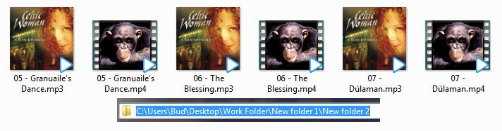

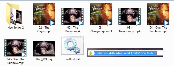

Make a batch file with:
Put it in the parent directory and run from a CMD prompt from that parent directory. It copied all of the mp3's in the parent and the recursive folders and the metadata in my test.Code:for /R %%g in ("*.mp3") do ( ffmpeg -loop 1 -i "Bud_009.jpg" -i "%%g"^ -map_metadata 1^ -map_metadata:s:v 1:s:v^ -map_metadata:s:a 1:s:a^ -c:a copy -c:v libx264^ -shortest "%%~dpng.mp4" )
[Attachment 44252 - Click to enlarge]
[Attachment 44253 - Click to enlarge] -

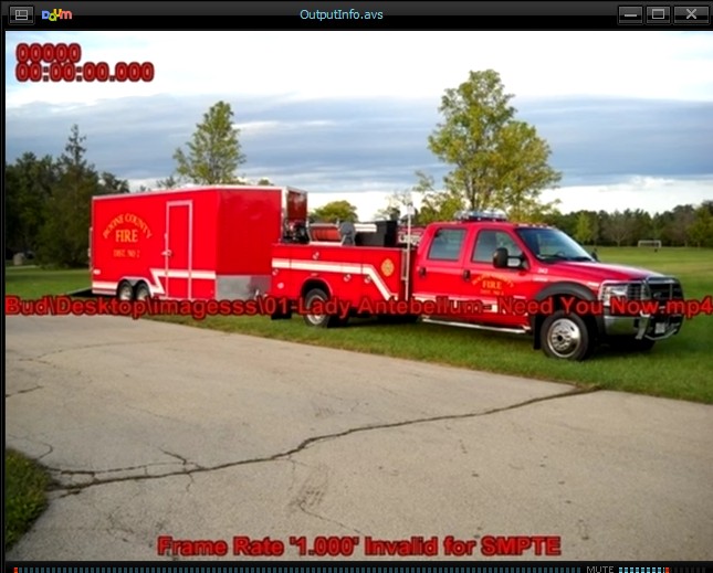

Also tried playing resulting MP4 in VLC and there is indeed a Black screen at the beginning. Apparently it doesn't like to show the image until the audio starts, which is after the image which had no audio. Windows Media player and Potplayer do not show the Black screen.
There is no Black frames as tested with FFprobe and Avisynth.:
[Attachment 47346 - Click to enlarge]
