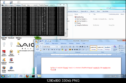

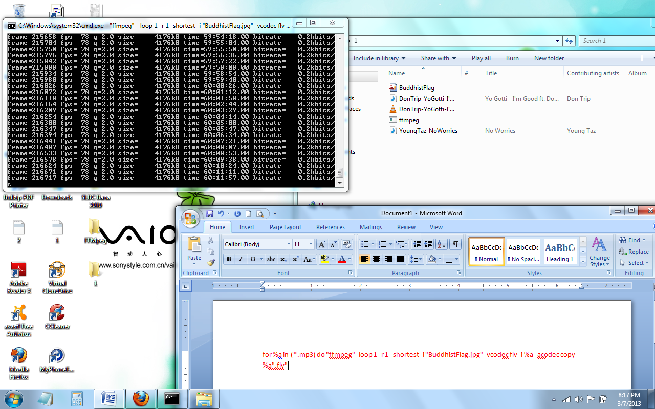

  6. Thank to both Cornucopia and Budman1 for your great suggestion.
    @Budman1, I seem to like your method better and it almost worked except for few issues.
    As I have mentioned before, the audio files are about 1hr in length (55mb in size), but still I wanted to check your method with smaller audio files and I wanted to check it myself since you wrote a really good explanation on what to type on the command window and all the other details associated with it..
    Please see the attach picture. It has a print screen about the problem I am having now.
    So I grabbed two mp3s from internet (2.30 min/ 2.5mb in size) and tried to join with an image.
    The file names for the audio are Don Trip You Gotti and Young Taz No Worries (just disregard the stupid names, those are the first ones I could find online)
    As you could see from the picture, a flv file for the first audio file in the folder was made pretty quickly by the FFMpeg, but the flv for the second audio file was not made even after more than 45 minutes from the start of the process and instead the FFMpeg kept running without any specific output as you can see from the command prompt window.
    I typed the command prompt as it appears in the word file with the replaced image name for what you had there.
    Do you have any suggestion for what I might be doing wrong for the FFMpeg to not produce the 2nd video file and on instead kept running.
    Can there be something wrong with the spacings in the command prompt. I basically copied what you had and only changed the image name.
    Sorry for all the trouble, but this is the first time I'm using command prompt to execute something.Click image for larger version

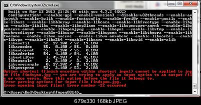

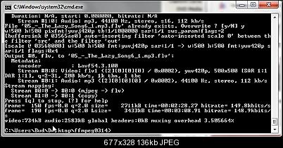

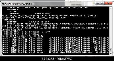

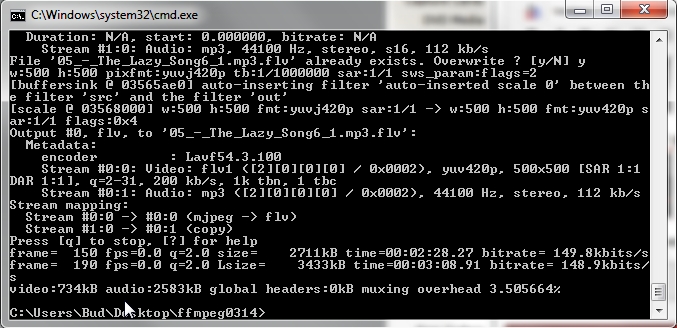

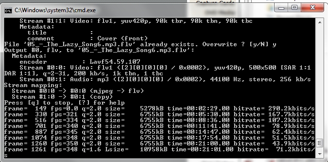

    Sorry it took so long to reply but I didn't seem to get a notice. Anyway, I tried your scenario and I got the same sort of results and then I realized I had updated FFMpeg. I tried the last 3 versions I had used and got, surprisingly, 3 different results. The 3 versions were:
Name:	ScreenHunter_481 Mar. 16 23.30.jpg
    With the 20130110 version, I got the same results as you caused by a high frame count being encoded.
Name:	ScreenHunter_481 Mar. 16 23.38.jpg

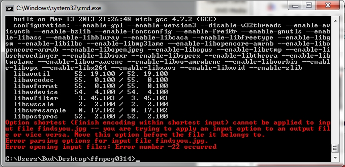

    With 20130314 version I got an error and it failed completely:
Name:	ScreenHunter_481 Mar. 16 23.40.jpg
    But with the 20120426 version 2 files converted in a few seconds as was my last attempts:
Name:	ScreenHunter_481 Mar. 16 23.42.jpg
    You might also notice my notation one one version that works with EBUR128 and it fails on the latest also. Guess the moral is FFMpeg is great but different versions seem to be VERY different in some uses. I'm noting all that work now and which ones so I can try all the failures on any new versions. I downloaded the 20120426 version at http://ffmpeg.zeranoe.com/builds/win32/static/ and there are a lot between there and 20130110 version I updated to but I'd start with the one that works and work up from there if you wish.
    It works fine on all I try with 20120426, hope it does for you.
    UPDATE:
    See my update to post #5 above for the correct syntax that was tested in later versions.
