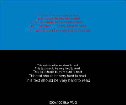

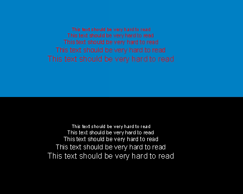

  2. Colors are encoded at half resolution (each dimension) in MPEG files. So your 720x480 image has the grayscale portion encoded at 720x480 but the colors at 360x240. That causes blurring of small colored objects, text, etc. Before on the left, after on the right:
    Notice how the white text is still perfectly legible. But the red text on the blue background is very fuzzy. You can alleviate this by using larger text or using only grayscale.
