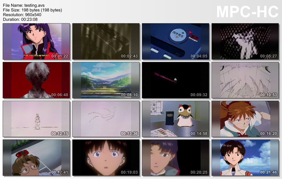

  1. I thought I'd try adding a "luma ramp" to the borders. After a bit of messing around I finally worked out how to make it work in practice much the way it was working in my head. I used jagabo's method for creating a "ramp", only I used the very edge pixels from the video to create the ramp rather than a greyscale ramp as such. That seemed to work better, although I'm still not sure I like the ramp idea after all that.
    I also added a InPixelAR option to the script, so it'll resize anamorphic sources to square pixels now, and add frosty borders as required.
    I think I discovered a silly in the previous method of copping/resizing while I was at it, so that's now fixed.
    See post #72 for details. The new version is FrostyBorders 2017-10-28.avsi
    Here's screenshots. With and without the gradient option enabled.
Name:	top-bottom gradient.jpg

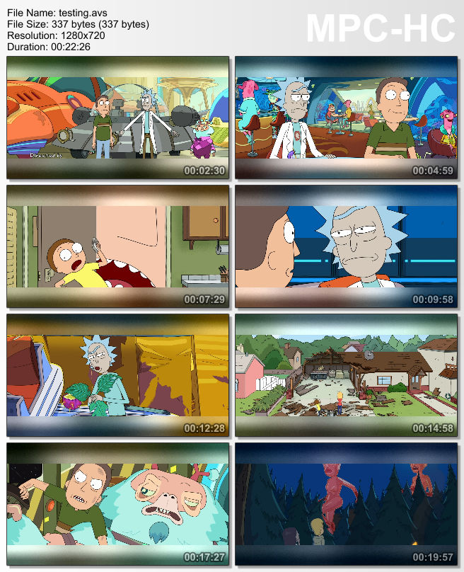

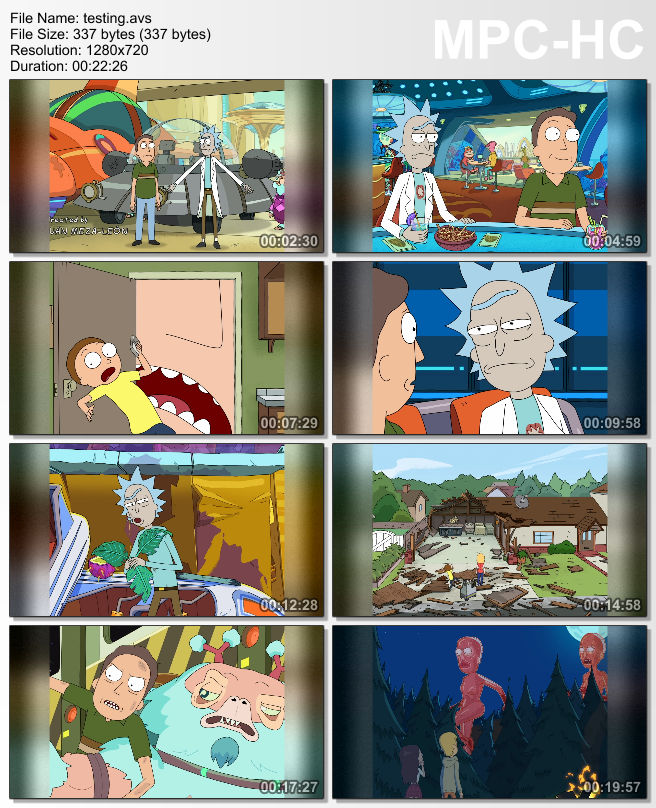

  18. I finally got around to having a less rushed look at the script today and found a couple of bugs. The only one that matters in respect to adding borders was a potential aspect error when resizing the width (I forgot a bracket). If there was an error, it should have only been wrong by a few pixels.
    A new version of the script with a bunch of changes. Follow this link for details and download.
Name:	Frosty Borders A.jpg
Name:	Frosty Borders B.jpg

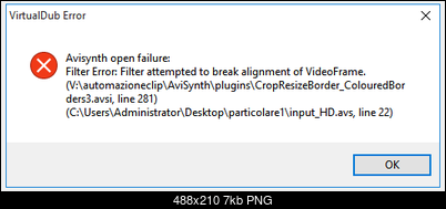

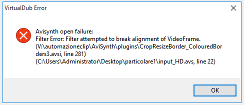

  23. Hello_hello please help a cat:
    I have now installed this Avisynth+ 64bit R2574: https://www.videohelp.com/download/AviSynthPlus-MT-r2574-with-vc-redist.exe
    and use your https://forum.videohelp.com/attachments/43454-1508563458/CropResizeBorder_ColouredBorders3.avsi
    in a script that use the CropResizeBorder function:
    Import("v:\automazioneclip\avisynth\plugins\IResize.avsi")
    Import("V:\automazioneclip\AviSynth\plugins\smoothFPS2.avsi")
    Import("v:\automazioneclip\AviSynth\plugins\FrostyBorders.avsi")
    Import("V:\automazioneclip\AviSynth\plugins\CropResizeBorder_ColouredBorders3.avsi")
    LoadPlugin("v:\automazioneclip\AviSynth\Lsmash64perVirtualDub64\LSMASHSource.dll")
    LoadPlugin("V:\automazioneclip\AviSynth\plugins64\ffms2.dll")
    LoadCPlugin("v:\automazioneclip\avisynth\plugins64\yadif.dll")
    vid=FFVideoSource("C:\Users\Administrator\Desktop\particolare1\input.mp4")
    aud=FFAudioSource("C:\Users\Administrator\Desktop\particolare1\input.mp4")
    left=GetChannel(aud, 1)
    right=GetChannel(aud, 2)
    both=mergechannels(left, right)
    audiodub(vid, both)
    ConvertAudioTo16Bit()
    #TurnRight()
    #Turn180()
    #TurnLeft()
    #robocrop()
    ConvertToYUY2(interlaced=false)
    colorMatrix(mode="Rec.601->Rec.709")

    If I use avisynt+ R1576 (my old version) the script works ok
    But only if I try to install the Avisynth+R2574 (the new version) I get this error:
  24. I'm guessing, but line 281 in the script involves autocrop.dll, so I'd be thinking that's something to do with it.
    Try the new version of the script. I finished it a little while ago.
    CropResize
    It'll do everything the old version can (it also has coloured borders), but it only uses autocrop.dll when auto-cropping is specifically enabled, so if autoctop.dll is the problem it'll hopefully go away.
    Keep in mind the new version no longer has a Cmode option, so to disable resizing you need to set Resize=false instead, but the following should give you the same result as the example in your previous post, only with more accurate cropping.
    CropResize(InDAR=480.0/368.0, PicDAR=16.0/9.0, Resize=false)
    In fact if you want to use LanczosResize for upscaling you should be able to do it the following way with the CropResize8() version of the script. It uses the Resize8 script to do the resizing. The defaults for Resize8 are Lanczos4 for luma upscaling, Lanczos for chroma upscaling, and Spline36 for luma and chroma downscaling.
    CropResize8(1920,1080, InDAR=480.0/368.0, Resizer="Lanczos")
    The PicDAR option has no effect when both OutWidth and OutHeight are specified, unless the script is adding borders, so in the above example "PicDAR=16.0/9.0" would be obsolete. If you specify 16:9 dimensions the script will still crop to 16:9 before resizing.
    Also keep in mind the new script automatically converts between rec.601 and rec.709 when resizing between HD and SD. That can be disabled with ColorCorrect=false (or there's instructions in the help file for disabling it by default), but I suggest checking what the script is doing with Info=true until you get to know it. Info=true is a lot more informative than the old script. It shows you exactly what cropping is being applied along with the source and output aspect ratios etc, and whether colour correction is taking place (there's screen shots in the second post of the thread I linked to). If you try the new version, and I recommend you do because it's better than the old script, I'd suggest looking through the help file because there's a few new options even though the basic functionality is the same.
    PS. I do the following when cropping 4:3 to 16:9 as it forces the script to crop a little more from the bottom than from the top, which usually works better, but the extra cropping is proportional to the resolution of the source (you'll need to use the new version of the script for it to work predictably though).
    c=last
    CropResize8(1920,1080, CB=-(floor(height(c)*0.075/2.0)*2), InDAR=4.0/3.0)

    That's why I mentioned twice it would only work if you also load the new CropResize script.
    Originally Posted by marcorocchini View Post
    The problem with avisynth is solved only using this new script, independetly from R2574 or R2580.
    I imagine it was something to do with AutoCrop.dll. Probably not AutoCrop's fault, but related to one of the Avisynth R2574 bugs.
