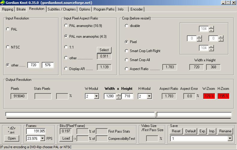

  11. Originally Posted by marcorocchini View Post
    ok thanks but if my source is 720x576 SD 4:3 what is the right script?
    I use GKnot for this sort of thing. Note in the picture the source (720x576), that it's set for PAL 4:3 Input Pixel Aspect Ratio, the amount of cropping done (104 from top and bottom) for the desired final resolution (1280x718 which you make 720 in your script). It should be noted that in the Options tab I have it set for ITU resizing. With non-ITU you'll crop differently.

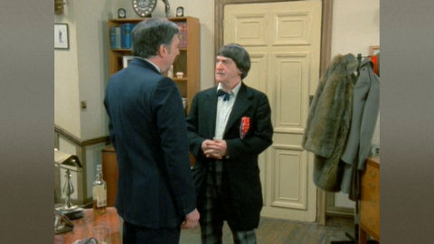

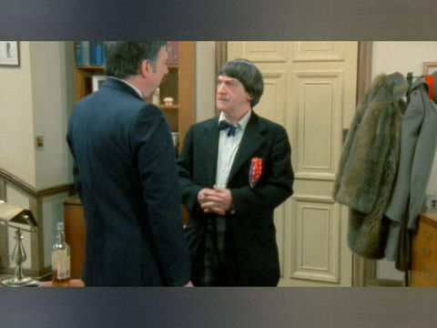

  16. I've added my latest effort to the attached version of the CropResizeBorder script. Once again when borders are enabled, it won't add black borders, only the coloured ones. There's no options for the borders yet either. The borders are created mostly using a dumb-downed version of raffriff42's function, but I'm not too unhappy with how they look.
    Pretty simple to use.
    This would take any (square pixel) image, crop it to 4:3 and add borders for 16:9:
    CRB(960, 540, PicDar=4.0/3.0)
    And this would take any (square pixel) image, crop it to 16:9 and add borders for 4:3:
    CRB(960, 720, PicDar=16.0/9.0)
    The edges aren't made from an enlarged version of the image, just from 12 pixels at the left and right edges (or top and bottom), merged together and then blurred and stretched etc.
    I tried adding a gradient to the borders, but it never seemed to work in practice the way it worked in my head, so I gave the gradient idea the flick.

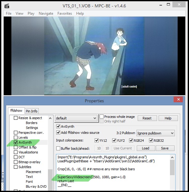

  20. I've renamed my script to SuperSexyWidescreen - because, why be so serious?
    BTW a good way to use it (or any pillarbox filter) is through ffdshow. Now all your videos are super widescreen!
    [Attachment 43447 - Click to enlarge]
    (and of course do not encode this effect, or any type of border)

    LanczosResize(round(x * 1080.0),1080)
    SuperSexyWidescreen(1920, 1080)
    exactly I don't know why but it's necessary the 2 lines x = float(width) / float(height)
    LanczosResize(round(x * 1080.0),1080) to get the correct result. Or is there a way to avoid they?
    Make you own function that does it all for you. This is trivial.
