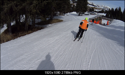

    I am still struggling with the details of video-conversion.
    Now I notice a very noticable change in colors I cannot explain.
    I just reencoded the original and extracted the same frame from both videos:
    %ffmpeg% -i Original.mp4 -c:v libx264 -preset fast -crf 10 -an "264.CRF10.mp4"
    %ffmpeg% -i "Original.mp4" -ss 00:00:05 -vframes 1 -s 1920x1080 "Original.png"
    %ffmpeg% -i "264.CRF10.mp4" -ss 00:00:05 -vframes 1 -s 1920x1080 "264.CRF10.png"
    In the resulting images, some colors do not match. This becomes very visible if you open them in two tabs and switch between them.

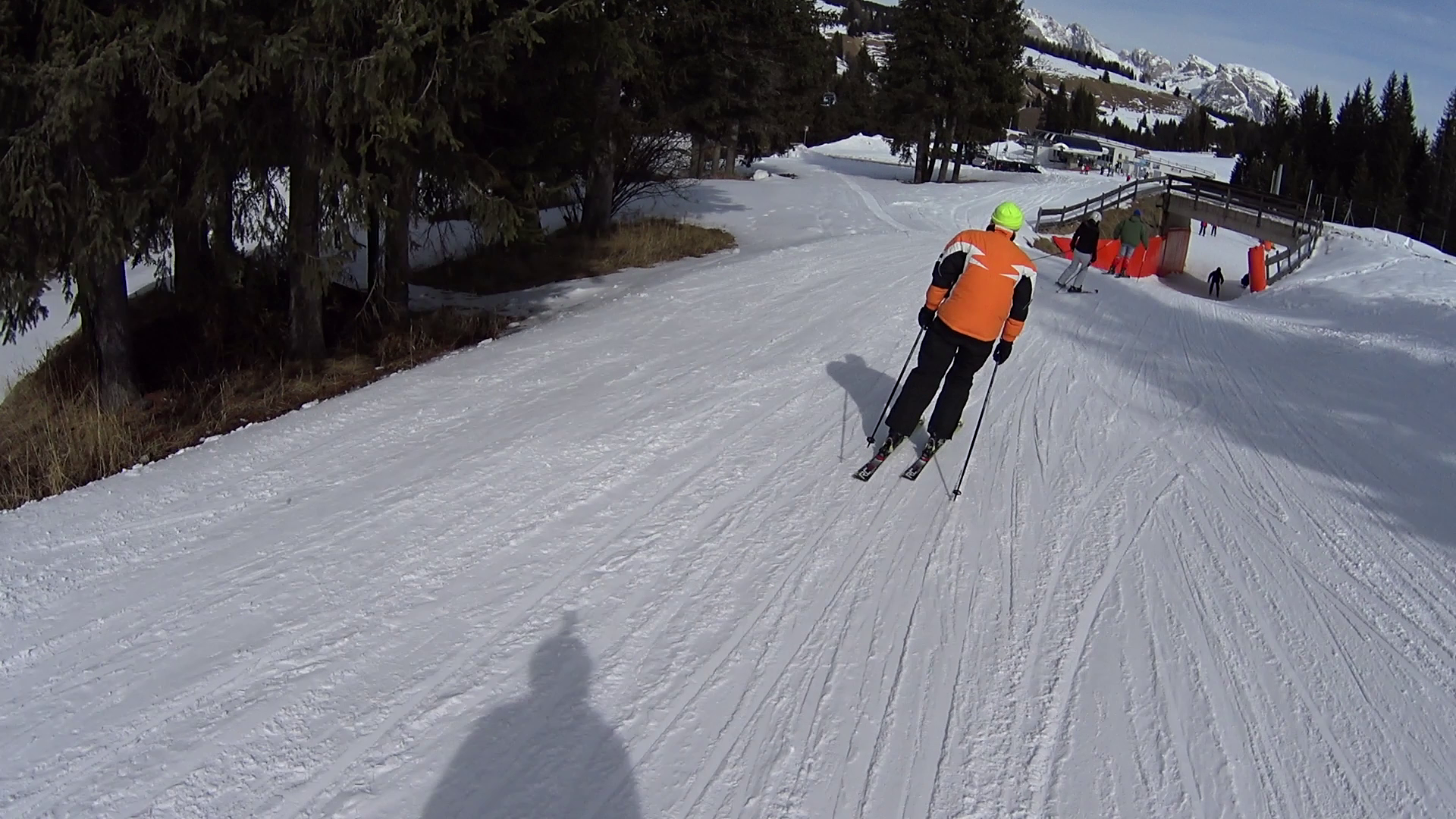

    Original:

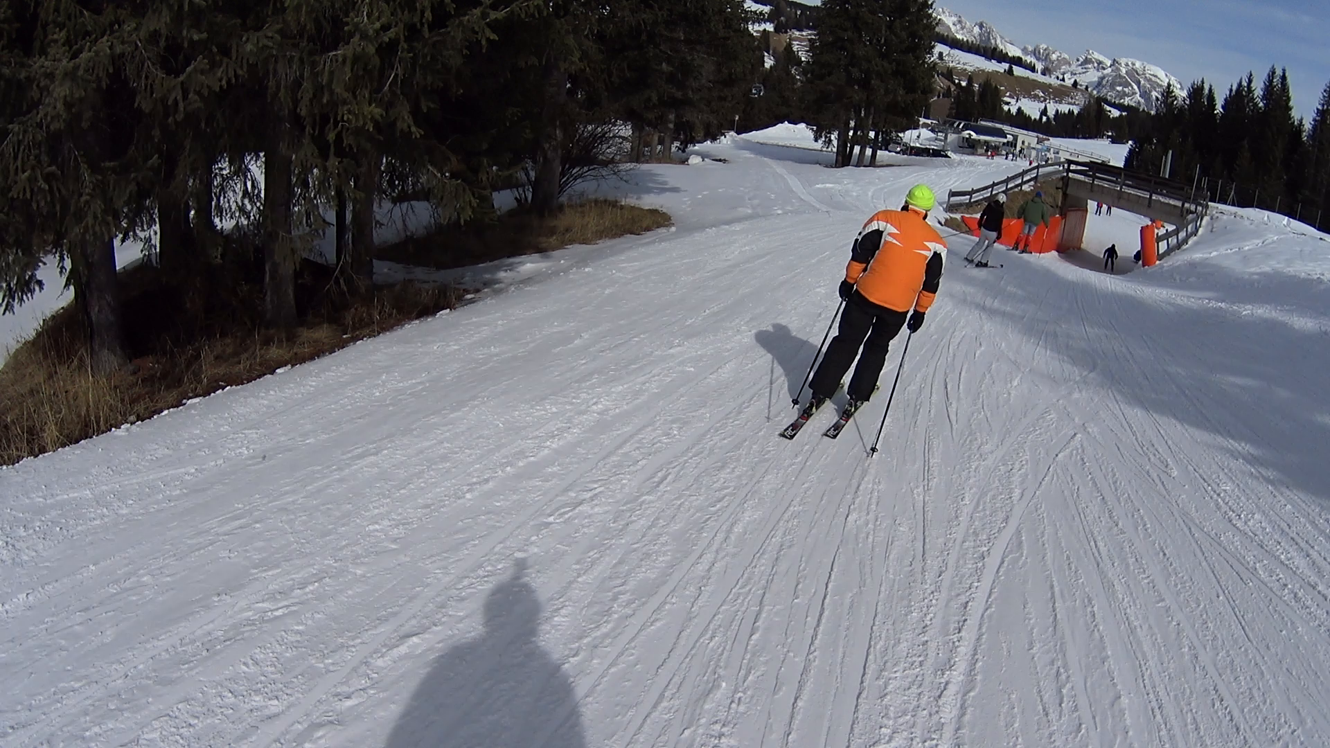

    264.CRF10:
  2. The x264 image is being converted to RGB with rec.601 colors, not rec.709 colors (internally the video is stored as YUV, so it has to be converted to RGB for display). The important setting is the Matrix Coefficients. You can add them while encoding with x264 adding "--colormatrix bt709" to the x264 command line. The other flags don't really need to be set but you can do so with --colorprim "bt709", --transfer "bt709", and don't use --fullrange (there's not an explicit limited range command). For SD video use bt470bg instead of bt709. Note that ffmpeg uses a single hyphen instead of two.
    If the colormatrix isn't specified most players will assume rec.709 for HD, rec.601 for SD, limited range for both. In between 720x576 (SD) and 1280x720 (HD) behavior depends on the particular player. Some players always use one or the other matrix, even if the matrix is specified. And your graphics card settings can effect this too.
    In AviSynth you can use the ColorMatrix() filter to convert between rec.601 and rec.709. ColorMatrix(mode="rec.601->rec.709") or ColorMatrix(mode="rec.601->rec.709"). Also, when converting back and forth between YUV and RGB ConvertToRGB(matrix="rec709"), ConvertToRGB(matrix="rec601") and similar arguments for ConvertToYV24(), ConvertToYV12(), ConvertToYUY2(), etc.
