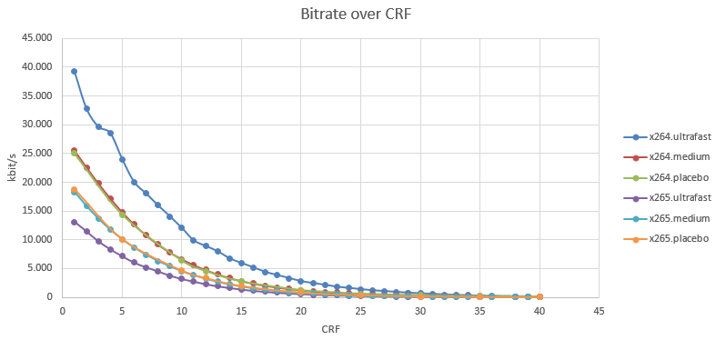

    In the meantime (and a little to distract you ), I have run some encoding-tests comparing x264 and x265.
    For this, I encoded the same 10-second-video (1080p60, Sony HDR-AS200V) with about 200 different settings:
    As you can see, x265 and x264 behave very differently. While the bitrate goes down with processing time in x264, it goes up in x265.
    Currently, VQMT is measuring the MS-SSIM-value to create a nice overview of quality vs. bitrate. Let's see, where this goes.
    From the first glance at the encodes:
    Ultrafast with CRF 33 creates about the same quality as placebo with CRF 40. But ultrafast uses 67kbit/s, while placebo needs only 30.

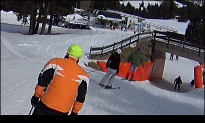

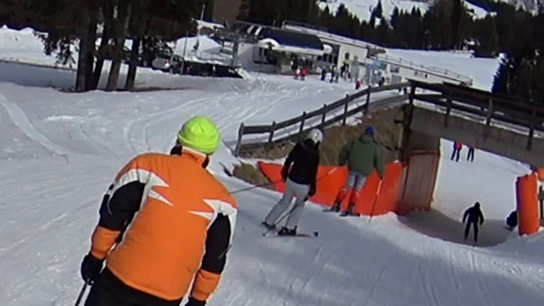

    Originally Posted by sophisticles View Post
    Do you think you could run some encoding tests with Stax Rip, use any source you want (the higher quality the better), pick a decent bit rate (like 5mb/s for 1080p), and run some encoding tests using x264, x265 and quick sync (configured for the highest quality), then post the samples for us to see and report the encode times?
    Well, I did not use Stax Rip, but QSVEnc to do some tests.
    The encoding is surprisingly quick. Even at setting "best", the encode ran at about 30fps. That did not feel right.
    Well, and the results are very bad as well.
    Please compare yourself:
    • all images are from the same source: 1080p60 action-cam
    • all videos are encoded at about 16Mpbs
    • all are zoomed to 200%
    QSVEnc, vbr 16000, best, encoded with 30fps
    x265, crf 19, ultrafast, encoded with 40fps
    I am pretty bad at judging these images.
    IMO, x265 added too much noise to the surfaces, while QSVEnc lost more details.
    Just for comparison:
    x265, crf 20, placebo, encoded with 0.25 fps
    Is there anything, you could do wrong with QSVEnc?

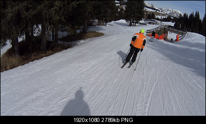

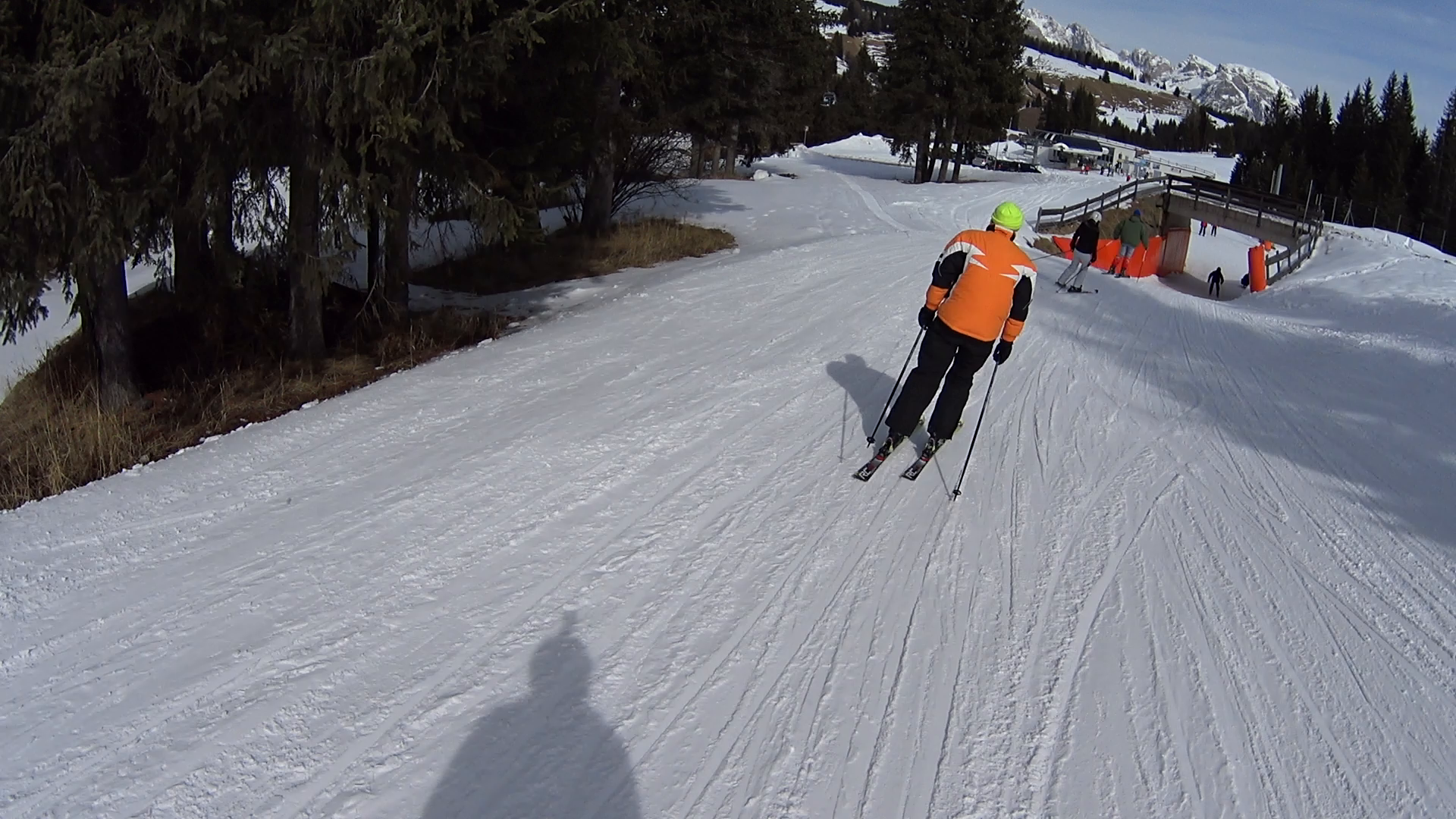

    And the original:
    And for the sake of completeness, the full-resolution original:
    GoPro camera's are not exactly top of the line video equipment.
    It's not a GoPro. And it was a source video of 1080p 50Mbit in H.264.
    He only used a 10 second clip, at 30 frames per second that's 300 frames, meaning with GOP of 250 frames that's only 1 I frame in the entire clip for which the other frames can reference. This does not give the analysis algorithms each codec uses an adequate chance to get the best picture quality. For proper tests the source should be of prestine quality and more importantly should be a previously uncompressed or losslessly compressed or at the very least Intra frame only source, like AVC Intra or MPEG Intra or something similar.
    The source video had just over 580 frames. Now when you look at the 2016 MSU report, you will see that they used clips in the range of 300 frames to 1500 frames. So 580 frames is well within MSU standards at least. Why you all of a sudden have a problem with it is interesting. You also told Epaminaidos to use any high quality source he wanted.
    But the biggest mistake is using QSVenc, this implimentation of Quick Sync is severely limited, making use of only some of the settings QS is capable of.
    Then insist he uses staxrip.
    At the very least he could share the command line he used for QSVenc, my guess is he didn't use anywhere near the most aggressive settings, which is why I suggested he use Staxrip as it would make it easier for him.
    Then ask him to share his settings used.
    Or he could stick with QSVenc and do something remotely approaching a proper test, I mean really take a 10 second clip, encode it using Lord knows what settings, take a screenshot, blow it up and then post it as proof that Quick Sync offers lower quality than x264 and x265?
    He provided the original source video, along with the 3 encoded videos via drop box. And x264 was not part of his quicksync/hevc test, which makes me think you are not really paying attention in this thread.
    Does StaxRip use something else?
    Here's the command line I used:
    %qsvEnc% -i %original60fps% -o "%targetDirectory%\%filename%" --codec hevc --vbr %vbr% --quality %preset% >> %log%
    Parameters were: vbr: 16000, preset: best
    The simple-frame is the frame in the middle of the clip (i.e. at 5.00s).
