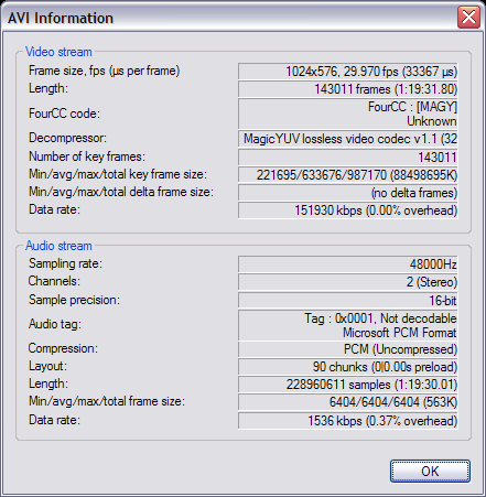

    I almost finished editing a video which is 1h19m30s long. It mixes footage in 29.97FPS (first part) and 25FPS (second part). I'm using Magix Video Deluxe (abbreviated as “MVD” below).
    At first I set the project in 25FPS, as it's a more common framerate here, and it seems less tricky to deal with an integer value, rather than a decimal one (apparently I was right on that part !). But I had a problem : the 29.97FPS camera had a defect (stabilizer not working properly) so the footage has random instances of vertical jerkiness (not correlated to the normal shakiness when it was shot handheld -- or it would mean that I have “vertical Parkinson disease”), and I had to make intensive use of the “stabilizing” function available in MVD. But it wasn't working properly, I couldn't understand why (I had already used this function which normally works very well), until I realized much later (I had abandoned this project for months in the mean time, mostly because of this issue) that the stabilizing function was correlating the corrective parameters with the output framerate (25FPS) instead of the input framerate (29.97FPS), and was messed up because of the 25FPS setting. When I changed the parameter of the project to 29.97FPS the stabilization worked nicely.
    Then, when I made the final export (in AVI MagicYUV, 29.97FPS), the resulting video file apparently had a wrong index, according to VLC Media Player, and was definitely out of sync, no matter which player I tried. If I let VLC correct the index it would play fine. I tried loading it in VirtualDubMod (where it also played progressively out of sync) and re-exporting it (Direct Stream Copy) : no “wrong index” message this time but it was still out of sync. I thought maybe it was because the project was first set to 25FPS then changed to 29.97FPS (and I dreaded having to start it all over again in 29.97FPS if that proved to solve the problem), so I created a new project in 29.97FPS and made a series of tests : a 20sec. export would always play directly (too short to verify the A/V synchronization), but a 30sec. export would always have this “wrong index” error in VLC. I tried exporting in 25FPS (from the original project) : it would play fine (no “wrong index” error, no sync issue), but then the stabilized segments would be jerky (same if exported in 30FPS), for the reason explained in the first paragraph. I also tried copying the source files in another folder and letting MVD re-import them in a new 29.97FPS project (thus re-creating the frame table or whatever is stored in the .m2ts.H0 files) -- same results. It seems like even in a brand new project set to 29.97 with 29.97 source files, MVD insists on converting the framerate somehow, adding duplicate frames at a certain interval (which I haven't yet identified).
    The whole movie should be exactly 1h19m30s, which is 4770 x 29.97 = 142956.9 frames, I guess it should be rounded to 142957, but it ends up being 1h19m31s80 or 143011 frames (it's not correct for 30FPS either : that would be 143100 frames). (I couldn't find a way to set Magix Video Deluxe to display the number of frames instead of the duration.) If I export 30s and open the file in VirtualDubMod the video appears to be 901 frames long instead of 899 (as for the duration, the video is 30.06s, the audio 30.05s). I tried exporting the begining segment (11m03s) in video only and audio only (WAV), then mixing the two with AudioDub function in Avisynth : it's still progressively out of sync. I examined a segment with constant motion in VirtualDubMod and noticed a duplicate frame (17304 = 17305) but couldn't find the next one (the idea was to try to decimate one frame every X frames and see if that would correct the synchronization issue) ; my guess is that it would be between 20s and 30s later (which would explain the “wrong index” warning), but that would be tremendously painstaking to do manually.
    So, questions :
    - Is there an explanation to this weird behaviour ? Is it common to other NLE softwares when dealing with 29.97 video, or is it a bug specific to MVD ?
    - How can I export the whole thing with a correct duration and perfect synchronization, in order to compress it (using MeGUI) and be done with it ? If there's indeed an issue with MVD which prevents it from exporting to 29.97FPS with a flawless synchronisation, maybe an Avisynth function would do the trick, like automatically detecting the duplicate frames and removing them ? What would be the best method to do that ? (I haven't tried exporting directly in MP4 within MVD to see if the output would be correctly synchronized, but I would definitely prefer to do it with the intended workflow so as to benefit from the best possible quality / size ratio offered by x264 / qaac.)
    Thanks to those who will help me solve this thing.

    Anyway it would seem like the duplicated frames are present within the timeline already, so something is wrong in the way the 29.97FPS source files are imported and dealt with in the first place.
    What else could I try ? Is my idea to detect and remove duplicate frames with Avisynth a good one, and how could I proceed – with which plugin – to do that automatically ?

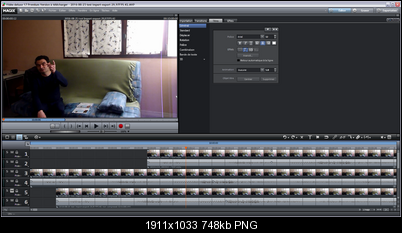

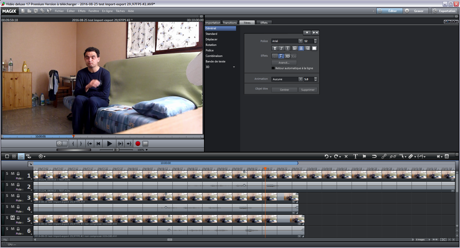

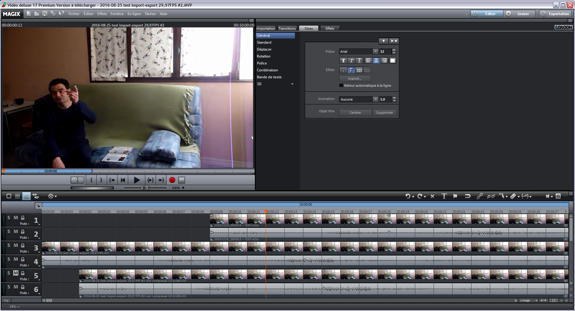

  11. Further tests :
    – If I create a brand new project in Magix Video Deluxe v.17, set it to 29.97FPS, add one 29.97FPS M2TS source file which is 18m50s long, and export exactly the first 10m00s00 (according to the duration displayed in the timeline), the resulting file has exactly the same issues as before : wrong index according to VLC Media Player, duplicated frames every 2662-2663 frames, the first one being frame #1332, and progressive video/audio desynchronization. The duplicated frames apparently do not appear in the timeline, they're added only during the export. (Same result with MagicYUV, UtVideo, Lagarith.)
    – If I re-import that exported file into the timeline, it is displayed as having a duration of exactly 10m00s00, right at the end of the selection previously made (when zoomed to the maximum, the grid unit being one frame, there appears to be a “partial frame” sticking out after the selection mark, if that makes sense). But the two files are not perfectly matched : to match the picture I have to shift the source video by two frames to the right at the begining (then the audio doesn't match). Is it to be expected when losslessly recompressing from a compressed format which is not “key-frames only” like M2TS ? Then if I go at the first duplicated frame, around 0m44s, I have to shift the source by one more frame to have the picture from both videos matched. Then at the end of the 10m00s export the total shift between the two videos to have the picture matched is 9 frames.
    – If I change the program parameters from PAL to NTSC, it doesn't change anything.
    – If I select “Automatic creation of a frametable during import” and re-create a project and re-import the same file and re-export 10m00s00, same result.
    – If I export to uncompressed AVI : I no longer get the warning in VLC, but there are still repeated frames at the same spots. But strangely, the picture is matched with that of the source footage at the begining (I don't have to shift the source by 2 frames), as opposed to the losslessly compressed AVI exports. Once I have shifted the uncompressed AVI by two frames relative to the losslessly compressed AVI, both are matched right through the end (so by the end the shift is 7 frames between source and uncompressed AVI, instead of 9 for losslessly compressed AVI).
    – If I let VLC rebuild the index (which is only temporary) before reading the losslessly compressed export it then displays a duration of 2m23s (instead of 10m00s), so it's too short to verify the synchronization (which is progressive thus barely noticeable during the first few minutes) ; it otherwise plays normally until right before the end (at 2m23) where it suddenly cuts to a very short segment which is near the end of the 10min, and stops.
    – If I export in MP4 : like the losslessly compressed AVI, there's a shift of 2 frames at the begining, the duplicated frames are at the same spots, but there are 7 extra frames at the end (if I re-import the MP4 in the timeline the duration is displayed as 10m00s07f), just as many as the number of duplicate frames (which is deduced from the shift relative to the source to get the picture matched).
    I don't know yet what I can make of all this weirdness... or, again, how I can fix it...
    Below are two screencaps from MVD corresponding to the matching test above (tracks 1-2 = source M2TS video / tracks 3-4 = losslessly compressed AVI 10m00s00 export / tracks 5-6 = uncompressed AVI 10m00s00 export ; the tracks are shifted relative to each other so that the picture matches for all three near the 10m00s00 mark ; on the first image the grid unit is 5 frames, on the second image the grid unit is 1 frame).
Name:	MVD test import export 29,97FPS (fichier source, export 10m00s00 puis ré-import) - AVI non comp.png
ID:	38277Click image for larger version
