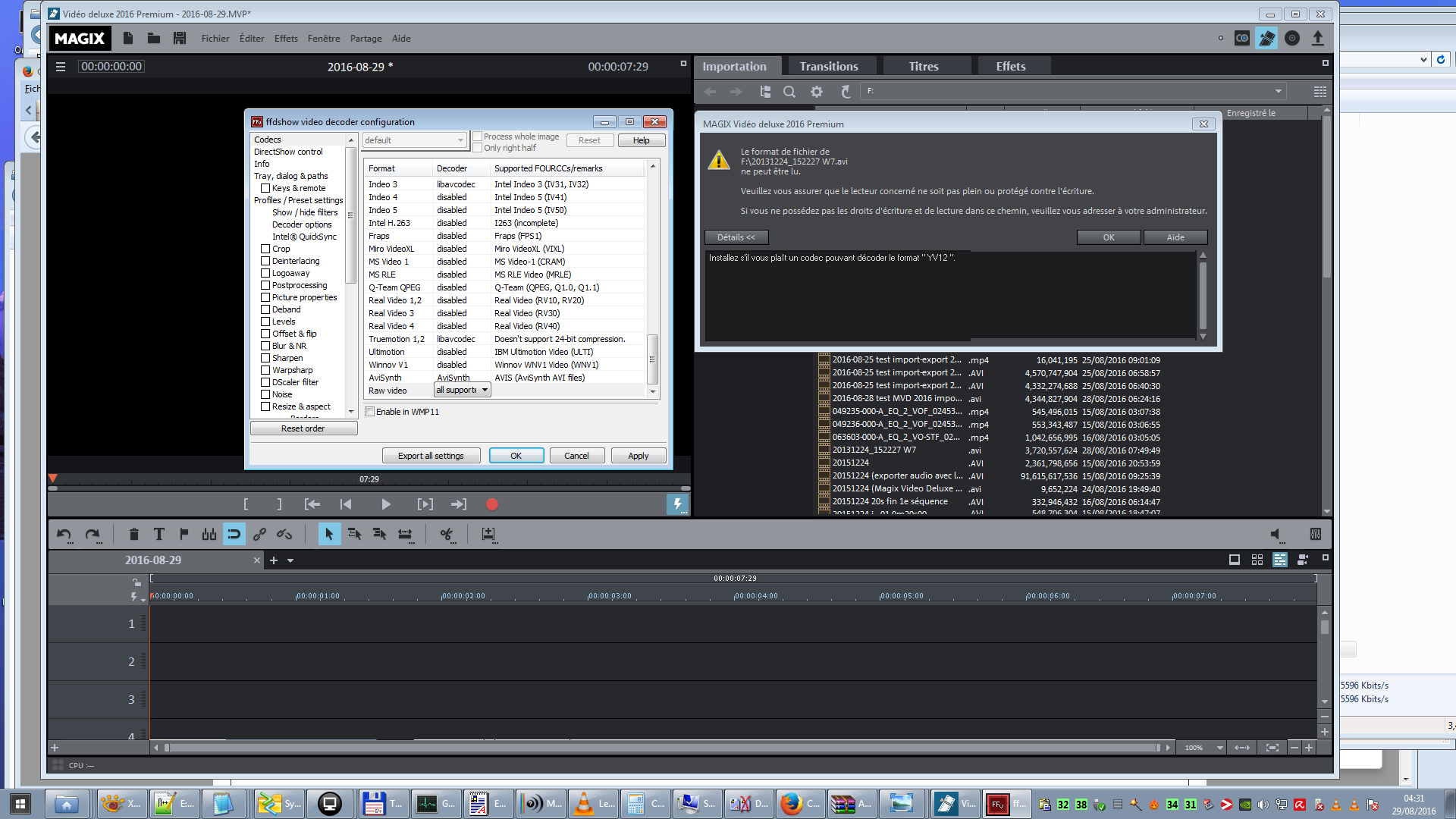

    Can't import raw YV12 :
    What am I missing ?
    (It used to work fine
    On a Win XP system
    With older version.)
  2. Try using ffdshow and enabling the raw video yv12 decoder.
  3. Hi, thanks.
    Already did that : installed ffdshow, set "Raw video" to "all supported" (should include YV12 right ?), also disabled the "don't use ffdshow in..." and "use ffdshow only in..." boxes, still doesn't work.

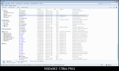

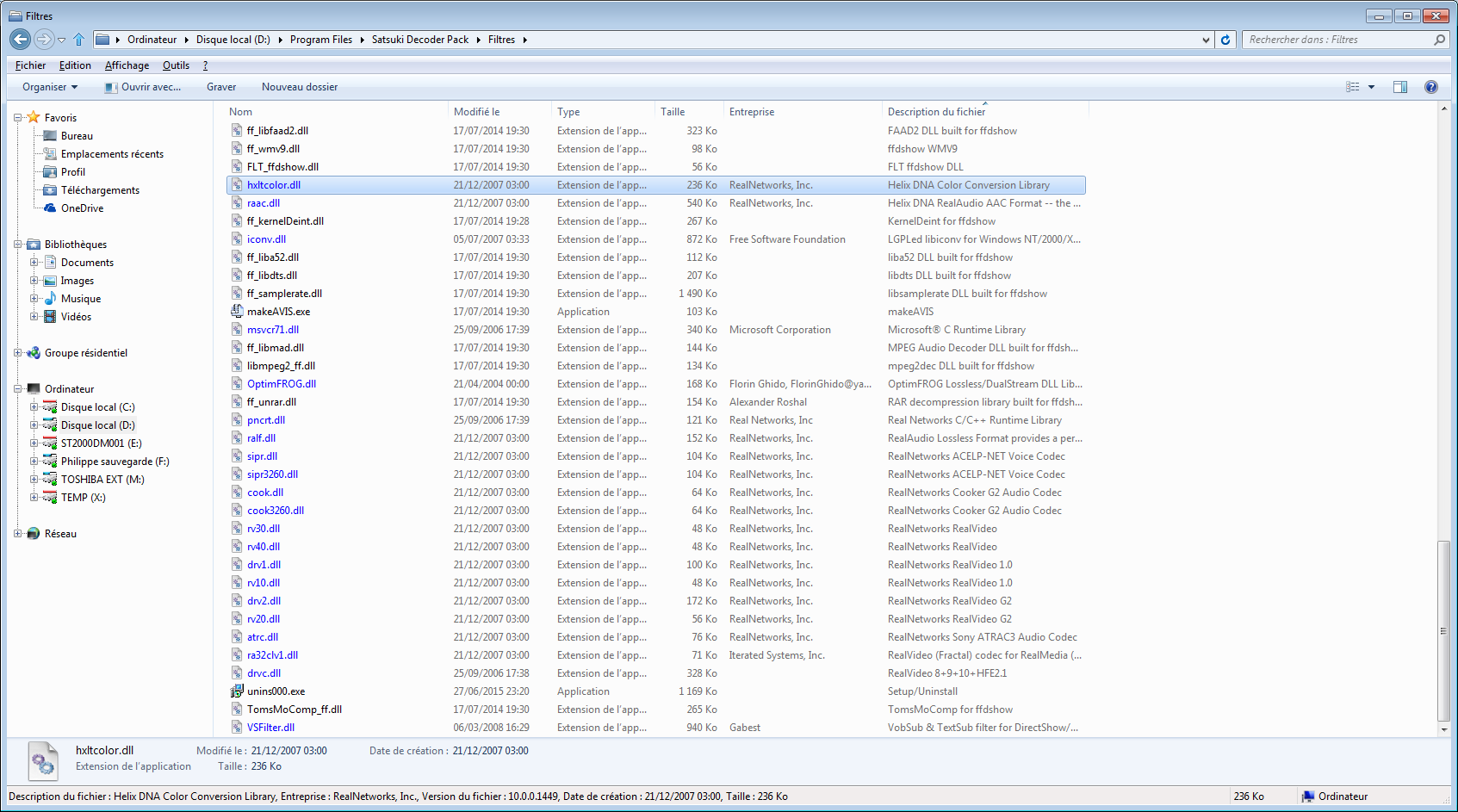

    On the XP partition I have a thing called “Satsuki Decoder Pack” installed, which includes Media Player Classic and a supposedly carefully selected assortment of filters. It contains two files for which the description says “Helix...” something, not sure if that's the one you mean.
Name:	Satsuki Decoder Pack - Helix DNA.png
    (Satsuki folder in XP partition.)

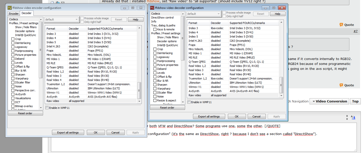

    Yes, that's the right idea. But... Did you set it for both VFW and DirectShow? Some programs use one, some the other.

  9. Yes, that's the right idea. But... Did you set it for both VFW and DirectShow? Some programs use one, some the other.
    I set it both in "VFW configuration" and in "Video decoder configuration" (it's the same as DirectShow, right ? because I don't see a section called "DirectShow").

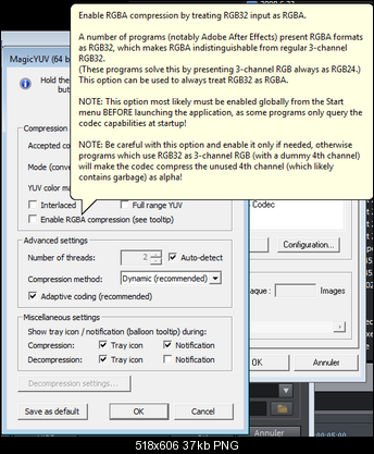

    I read this about RGB / RGBA with dummy 4th channel in MagicYUV's options :
  11. Originally Posted by abolibibelot View Post
    Do you have a reference for that statement ? And how is that "dummy alpha channel" generally treated by editors ?
    It's just an observation with some programs. It depends on the specific program. But the underlying reason has to do with alignment to machine word boundaries
    http://avisynth.nl/index.php/RGB32
    Using the RGB32 video format provides in modern processors faster access to video data because the data is aligned to machine's word boundaries. For this reason many applications use it instead of RGB24 even when there is no transparency mask information in the fourth (A) byte, since in general the improved processing speed outweighs the memory overhead introduced by the unused A byte per pixel.
    I forget exactly where or which programs there were some benchmarks/speed tests showed it was like 20% faster than RGB24, despite being "larger"
    It's handled fine by most programs. It's a "dummy" alpha, so no actual data. Some programs might pop up a dialog asking you how to handle it (e.g. it might give you an option to ignore it). If you had real alpha channel (transparency information) with RGB32, then it would also be handled ok in most NLE's because they use it when compositing / mixing layers
