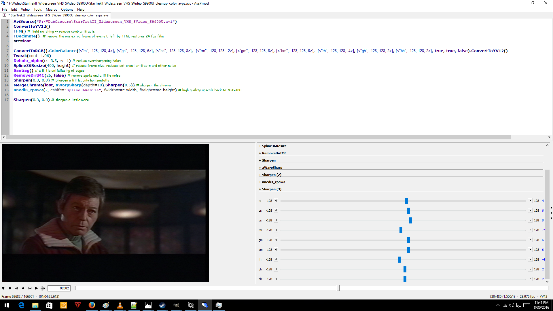

This is an example of what I wanted to use a graphical editor for. The color balance is 9-axis and is quite cumbersome to do by typing in values and then tweaking them in a text editor. The Animate() method wouldn't work well for this either since there are 9 variables to check all the other variables against. The sliders make this quite easy to work with though:
[Attachment 38363 - Click to enlarge]
I'm not sure if there's a better method available to do this type of adjustment. -

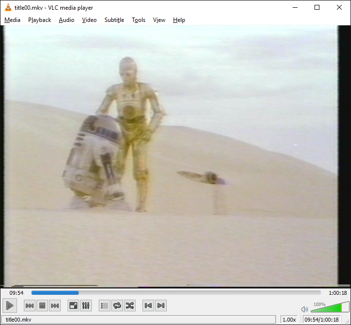

So I've been back at working on archiving some videos. I've been testing out some different optimizations that seem to have good cleanup potential. However, in comparing some of the denoising to AVIsynth output, I noticed there seems to be some significant loss of detail and overall brightening from TFM() and TDecimate(). I was a little surprised by this, but it's particularly noticeable with clouds.
This is the full AVIsynth script applied to the the capture:
Screen caps are attached. Is that behavior expected from TFM?Code:Mpeg2Source("title00_track1_eng.d2v", CPU2="ooooxx", Info=3) TFM() # field matching -- remove comb artifacts TDecimate() # remove the one extra frame of every 5 left by TFM, restores 24 fps film

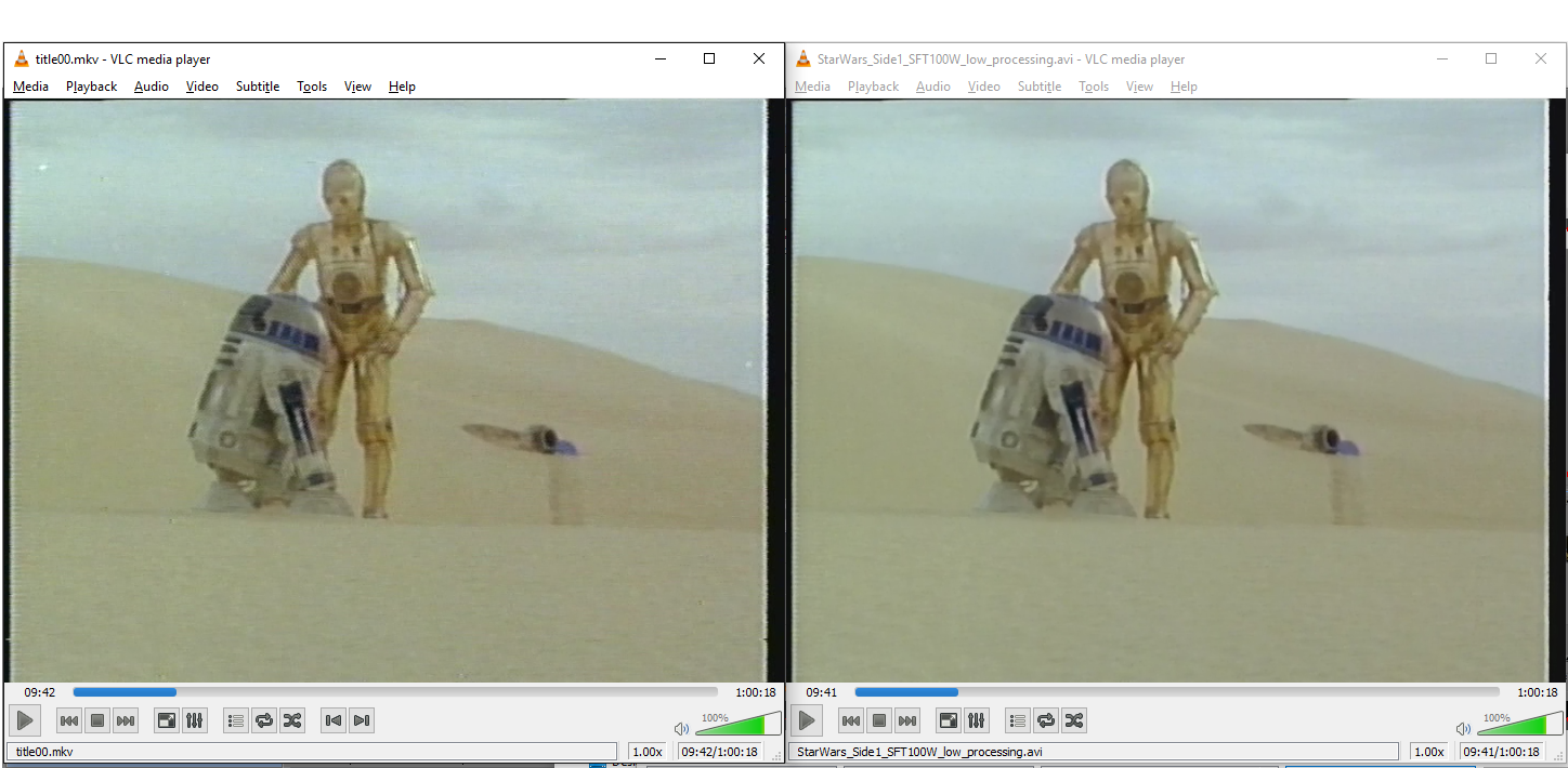

Yes, both Windows were open at the same time, but I don't believe that to be the issue. I have different version I'm working on (CED as opposed to VHS). It doesn't exhibit that issue with both open, though the colors are darker from this source:

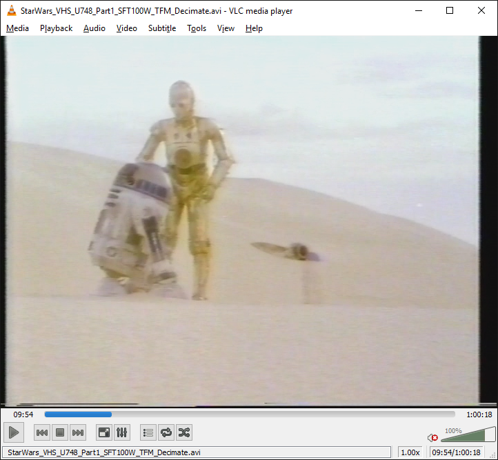

Also, looking at the avs in VirtualDub (other apps closed) with the "CPU2="ooooxx", Info=3" removed appears the same:
