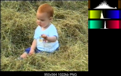

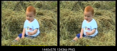

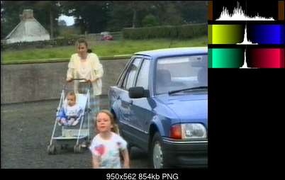

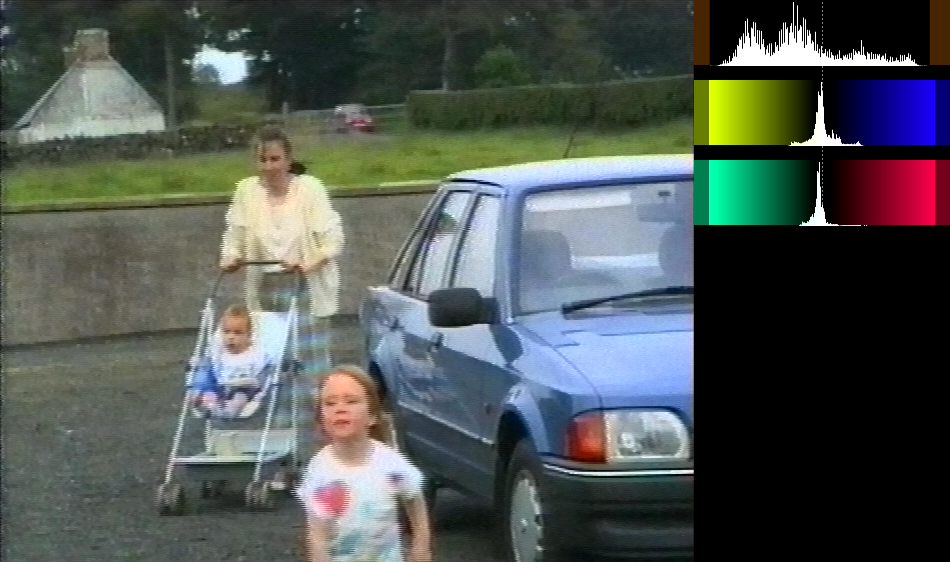

    A quick attempt on my side. The source is not the best, but I see some improvement with a basic processing.
    Levels video 1 OK:
    Levels video 2 OK:
    Processing video 1:

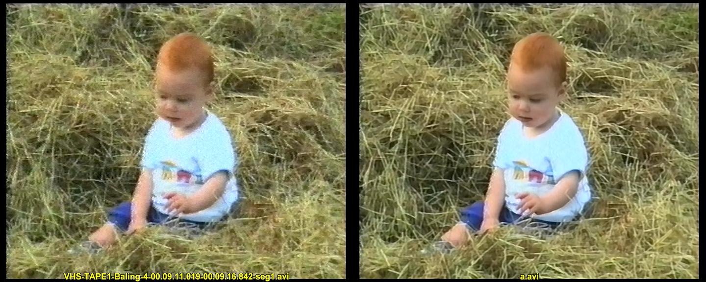

    video (cutted for upload limits): a_cutted.avi
    comparison by side:
    comparison with slider: https://imgsli.com/MzI0MzUw (a bit unfair, interlaced vs progressive)
    Processing video 2:
    video: b.avi
    comparison by side:
    comparison with slider: https://imgsli.com/MzI0MzUx (a bit unfair, interlaced vs progressive)
    Filtering video 1:
    video_org=AviSource("VHS-TAPE1-Baling-4-00.09.11.019-00.09.16.842-seg1.avi")
    # cropping
    	crop_left=16	# | rimozione esatta delle bande nere sinistra, sopra, destra e del disturbo sotto
    	crop_top=8	# | 720-(16+10)x576-(8+4)=694x564
    	crop_right=10
    	crop_bottom=4
    video_org_crop=video_org.crop(crop_left,crop_top,-crop_right,-crop_bottom)
    ### de-interlacing
    deinterlaced=video_org_crop.AssumeTFF().QTGMC(preset="slow", matchpreset="slow", matchpreset2="slow", sourcematch=3, tr1=2, tr2=1, NoiseTR=2, sharpness=0.1)
    ### convert to YV16
    deinterlaced_yv16=deinterlaced.convertToYV16()
    ### denoising
    denoised_yv16=deinterlaced_yv16.TemporalDegrain2(degrainTR=3)
    ### convert to YUY2
    denoised=denoised_yv16.convertToYUY2()
    ### convert to YV12
    video_org_yv12=denoised.convertToYV12()
    ### sharpening
    sharpened_yv12=video_org_yv12.LSFmod(defaults="slow")
    ### convert to YUY2 with chroma from YUY2 color space
    sharpened=sharpened_yv12.convertToYUY2().MergeChroma(denoised)
    ### add borders
    video_rest=sharpened.addborders((crop_left+crop_right)/2-1,(crop_top+crop_bottom)/2,(crop_left+crop_right)/2+1,(crop_top+crop_bottom)/2)
    return(video_rest)
    Filtering video 2 (just crop top changed):
    # cropping
    	crop_top=10	# | 720-(16+10)x576-(10+4)=694x562
    	crop_right=10
    	crop_bottom=4

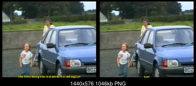

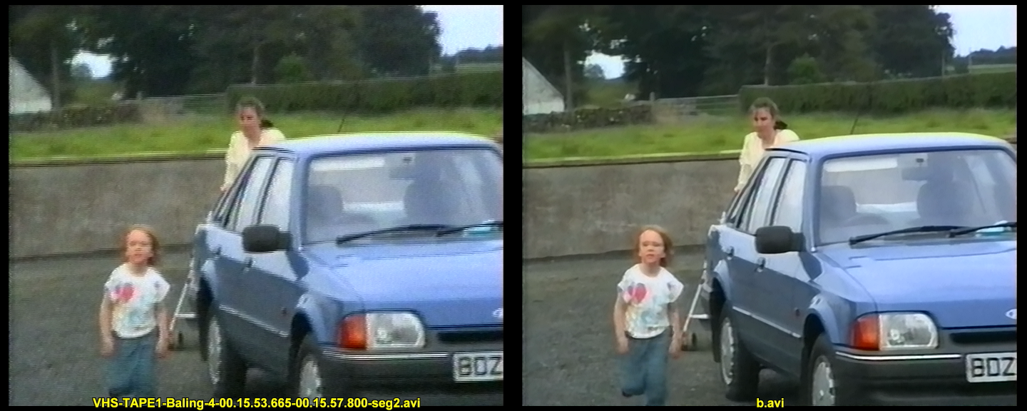

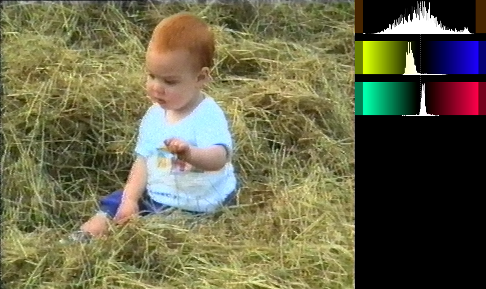

  8. Originally Posted by lollo View Post
    Levels video 1 OK:
    [Attachment 83944 - Click to enlarge]
    Levels video 2 OK:
    [Attachment 83945 - Click to enlarge]
    Processing video 1:
    video (cutted for upload limits): Image
    [Attachment 83948 - Click to enlarge]
    comparison by side:
    [Attachment 83946 - Click to enlarge]
    Processing video 2:
    video: Image
    [Attachment 83949 - Click to enlarge]
    comparison by side:
    [Attachment 83947 - Click to enlarge]

    Thanks for that. I was using very similar - TG2 and LSFMod albeit the fast mode. I'm using Staxrip so the conversions and mergechroma isn't something I specify (assume it happens behind the scenes).
    Is the low quality source to be expected if this was recorded from some other device e.g. camcorder to VHS?
  9. Captures & Restoration lollo's Avatar
    Jul 2018
    Italy
    Yes. Every analog copy degrades the quality. But other aspects may be relevant (i.e. quality of the recorder, quality of the player, signal path, etc.)
    MergeChroma and ColorSpace conversions are there just because my setup. Actually the first avoid sharpening the chroma, which may be useful in some cases (anyhow, by default the best sharpener do not act on chroma).
    You do not need any useless gui, for encoding just use:
    ffmpeg.exe -i <input>.avs -c:v libx264 -crf 17 -preset slow -aspect 4:3 -c:a aac -b:a 128k <output>.mp4
