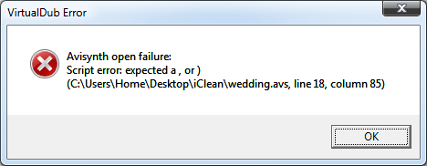

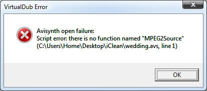

    Firstly, thank you for reply , really appreciate it.., I have never used avisynth before , i have downloaded the plugins and copied into my avisynth plugin folder and downloaded the test.avs script and replaced with my file name and open in VirturalDub 1.9.11 i get this error comes up..

    MPEG2Source ("wedding.mpg")
    ConvertToYV12(interlaced =true)
    AssumeTFF()
    SeparateFields()
    a=last
    clense(reduceflicker=false).merge(last,0.5).clense (reduceflicker=false)
    mot=removegrain(11,0).removegrain(20,0).DepanEstim ate(range=2)
    take2=a.depaninterleave(mot,prev=2,next=2,subpixel =2)
    clean1=take2.TMedian2().selectevery(5,2)
    sup1 = clean1.minblur(1).removegrain(11,0).removegrain(11 ,0)
    \ .mt_lutxy(clean1,"x 1 + y < x 2 + x 1 - y > x 2 - y ? ?",U=2,V=2)
    \ .msuper(pel=2,sharp=0)
    sup2 = a.msuper(pel=2,levels=1,sharp=2)
    bv22=sup1.manalyse(isb=true, truemotion=false,global=true,delta=2,blksize=16,ov erlap=8,search=5,searchparam=4,DCT=5)
    bv21=sup1.manalyse(isb=true, truemotion=false,global=true,delta=1,blksize=16,ov erlap=8,search=5,searchparam=4,DCT=5)
    fv21=sup1.manalyse(isb=false,truemotion=false,glob al=true,delta=1,blksize=16,overlap=8,search=5,sear chparam=4,DCT=5)
    fv22=sup1.manalyse(isb=false,truemotion=false,glob al=true,delta=2,blksize=16,overlap=8,search=5,sear chparam=4,DCT=5)
    interleave(a.mcompensate(sup2,fv22),a.mcompensate( sup2,fv21),a,a.mcompensate(sup2,bv21),a.mcompensat e(sup2,bv22))
    sup3 = last.msuper(pel=2,sharp=2)
    bv33=sup3.manalyse(isb=true, truemotion=false,global=true,delta=3,blksize=8,ove rlap=4,search=5,searchparam=4,DCT=5)
    bv32=sup3.manalyse(isb=true, truemotion=false,global=true,delta=2,blksize=8,ove rlap=4,search=5,searchparam=4,DCT=5)
    bv31=sup3.manalyse(isb=true, truemotion=false,global=true,delta=1,blksize=8,ove rlap=4,search=5,searchparam=4,DCT=5)
    fv31=sup3.manalyse(isb=false,truemotion=false,glob al=true,delta=1,blksize=8,overlap=4,search=5,searc hparam=4,DCT=5)
    fv32=sup3.manalyse(isb=false,truemotion=false,glob al=true,delta=2,blksize=8,overlap=4,search=5,searc hparam=4,DCT=5)
    fv33=sup3.manalyse(isb=false,truemotion=false,glob al=true,delta=3,blksize=8,overlap=4,search=5,searc hparam=4,DCT=5)
    last.mdegrain3(sup3,bv31,fv31,bv32,fv32,bv33,fv33, thSAD=499)
    Interleave()
    Weave()
    #####interpolate bad frames and residual cleaning
    Super = msuper()
    bv1 = manalyse(Super, isb=true, delta=2)
    fv1 = manalyse(Super, isb=false, delta=2)
    bv2 = manalyse(Super, isb=true, delta=3)
    fv2 = manalyse(Super, isb=false, delta=3)
    global CandidatesForN = mflowinter(Super, bv2, fv2, time=33.3, ml=100)
    global CandidatesForO = mflowinter(Super, bv2, fv2, time=66.7, ml=100)
    global CandidatesForC = mflowinter(Super, bv1, fv1, time=50.0, ml=100)
    last
    rx(104,12) #104-116 replaced
    AssumeTFF()
    SeparateFields()
    f1=SelectEven().RemoveDirtMC(100,false).LSFMod(str ength=5)
    f2=SelectOdd().RemoveDirtMC(100,false).LSFMod(stre ngth=5)
    Interleave(f1,f2)
    Weave()
    function MinBlur(clip clp, int r, int "uv")
    uv = default(uv,3)
    uv2 = (uv==2) ? 1 : uv
    rg4 = (uv==3) ? 4 : -1
    rg11 = (uv==3) ? 11 : -1
    rg20 = (uv==3) ? 20 : -1
    medf = (uv==3) ? 1 : -200
    RG11D = (r==0) ? mt_makediff(clp,clp.sbr(),U=uv2,V=uv2)
    \ : (r==1) ? mt_makediff(clp,clp.removegrain(11,rg11),U=uv2,V=u v2)
    \ : (r==2) ? mt_makediff(clp,clp.removegrain(11,rg11).removegra in(20,rg20),U=uv2,V=uv2)
    \ : mt_makediff(clp,clp.removegrain(11,rg11).removegra in(20,rg20).removegrain(20,rg20),U=uv2,V=uv2)
    RG4D = (r<=1) ? mt_makediff(clp,clp.removegrain(4,rg4),U=uv2,V=uv2 )
    \ : (r==2) ? mt_makediff(clp,clp.medianblur(2,2*medf,2*medf),U= uv2,V=uv2)
    \ : mt_makediff(clp,clp.medianblur(3,3*medf,3*medf),U= uv2,V=uv2)
    DD = mt_lutxy(RG11D,RG4D,"x 128 - y 128 - * 0 < 128 x 128 - abs y 128 - abs < x y ? ?",U=uv2,V=uv2)
    clp.mt_makediff(DD,U=uv,V=uv)
    return(last)
    # median of 5 clips from Helpers.avs by G-force
    Function Median2(clip "input_1", clip "input_2", clip "input_3", clip "input_4", clip "input_5", string "chroma")
    chroma = default(chroma,"process") #default is "process". Alternates: "copy first" or "copy second"
    #MEDIAN(i1,i3,i5)
    Interleave(input_1,input_3,input_5)
    chroma == "process" ? Clense(reduceflicker=false) : Clense(reduceflicker=false,grey=true)
    m1 = selectevery(3,1)
    #MAX(MIN(i1,i3,i5),i2)
    m2 = input_1.MT_Logic(input_3,"min",chroma=chroma).MT_L ogic(input_5,"min",chroma=chroma).MT_Logic(input_2 ,"max",chroma=chroma)
    #MIN(MAX(i1,i3,i5),i4)
    m3 = input_1.MT_Logic(input_3,"max",chroma=chroma).MT_L ogic(input_5,"max",chroma=chroma).MT_Logic(input_4 ,"min",chroma=chroma)
    Interleave(m1,m2,m3)
    selectevery(3,1)
    chroma == "copy first" ? last.MergeChroma(input_1) : chroma == "copy second" ? last.MergeChroma(input_2) : last
    Return(last)
    function TMedian2(clip c) {
    Median2( c.selectevery(1,-2), c.selectevery(1,-1), c, c.selectevery(1,1), c.selectevery(1,2) ) }
    function RemoveDirt(clip input, int limit, bool _grey)
    clensed=input.Clense(grey=_grey, cache=4)
    alt=input.RemoveGrain(2)
    return RestoreMotionBlocks(clensed,input,alternative=alt, pthreshold=6,cthreshold=8, gmthreshold=40,dist=3, dmode=2,debug=false,noise=limit,noisy=4, grey=_grey)
    # Alternative settings
    # return RestoreMotionBlocks(clensed,input,alternative=alt, pthreshold=4,cthreshold=6, gmthreshold=40,dist=1,dmode=2,debug=false,noise=li mit,noisy=12,grey=_grey,show=true)
    # return RestoreMotionBlocks(clensed,input,alternative=alt, pthreshold=6,cthreshold=8, gmthreshold=40,dist=3,tolerance= 12,dmode=2,debug=false,noise=limit,noisy=12,grey=_ grey,show=false)
    function RemoveDirtMC(clip,int limit, bool "_grey")
    _grey=default(_grey, false)
    limit = default(limit,6)
    i=MSuper(clip,pel=2)
    bvec = MAnalyse(i,isb=false, blksize=8, delta=1, truemotion=true)
    fvec = MAnalyse(i,isb=true, blksize=8, delta=1, truemotion=true)
    backw = MFlow(clip,i,bvec)
    forw = MFlow(clip,i,fvec)
    clp=interleave(backw,clip,forw)
    clp=clp.RemoveDirt(limit,_grey)
    clp=clp.SelectEvery(3,1)
    return clp
    function R(clip Source, int N)
    # N is number of the frame in Source that needs replacing.
    # Frame N will be replaced.
    Source.trim(0,-N) ++ CandidatesForC.trim(N-1,-1) ++ Source.trim(N+1,0)
    function RP(clip Source, int N)
    # N is number of the first frame in Source that needs replacing.
    # Frames N and N+1(O) will be replaced.
    Source.trim(0,-N) ++ CandidatesForN.trim(N-1,-1) \
    ++ CandidatesForO.trim(N-1,-1) ++ Source.trim(N+2,0)
    function RX(clip Source, int N, int X)
    # N is number of the 1st frame in Source that needs replacing.
    # X is total number of frames to replace
    #e.g. RX(101, 5) would replace 101,102,103,104,105 , by using 100 and 106 as reference points for mflowfps interpolation
    start=Source.trim(N-1,-1) #one good frame before, used for interpolation reference point
    end=Source.trim(N+X,-1) #one good frame after, used for interpolation reference point
    start+end
    AssumeFPS(1) #temporarily FPS=1 to use mflowfps
    super = MSuper()
    backward_vec = MAnalyse(super, isb = true)
    forward_vec = MAnalyse(super, isb = false)
    MFlowFps(super, backward_vec, forward_vec, blend=false, num=X+1, den=1) #num=X+1
    AssumeFPS(FrameRate(Source)) #return back to normal source framerate for joining
    Trim(1, framecount-1) #trim ends, leaving replacement frames
    Source.trim(0,-N) ++ last ++ Source.trim(N+X+1,0)
    MPEG2Source can't be used in that manner. Also, usually MPEG2 is already YV12 colorspace. But it won't hurt to be sure by using ConvertToYV12.
    MPEG2Source is part of the DGMPGDec package: http://neuron2.net/dgmpgdec/dgmpgdec.html .
    A guide to using it with MPG and similar videos: http://neuron2.net/dgmpgdec/QuickStart.html

  8. MPEG2Source can't be used in that manner. Also, usually MPEG2 is already YV12 colorspace. But it won't hurt to be sure by using ConvertToYV12.
    my bad it was intended for something else sorry.Sanlyn is right the directshow source is much better and you have to have DGMPGDec package to work as it is ( don't use it here my mistake )I assume you captured avi files so avisource is more appropriate ( if you use aspmod you can just enter insert and it will recognize the source automatically, it is much easier when i started learning avisynth i found it very helpful( i still consider my self newbie after all that time with video ).

    Ops i now see it is mpeg file i'm not very carеfull today then in the first line instead of MPEG2Source ("wedding.mpg")
    enter DirectShowSource ("wedding.mpg")
    or use sanlyn suggestion
    you have error in line 17 of the script you posted did you copy the script exactly from sanlyn or from lin that i gave you
    copy this script exactly and just change the path of your video ( you copy all the plugins that i posted on the other tread right ) should work
    [Attachment 11787 - Click to enlarge]
    Script used
    MPEG2Source is part of the DGMPGDec package: http://neuron2.net/dgmpgdec/dgmpgdec.html . Use DGIndex from this package to create a .d2v index file of your mpg. Then open the .d2v in Avisynth with something like this: MPEG2Source(MyFile.d2v).
    Simple to use...

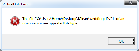

    but i do get this error... :S

  11. Banned
    New York, US
    Don't worry about the "comma or )" error, that happens all the time. Typo's are a frequent pain in the neck.
    If you're capturing to AVI, capture with huffyuv lossless compression (Lagarith is too slow for real-time capture) in YUY2 to avoid color problems. Open an AVI with plain old AviSource(). That script will require that you work in YV12, so be sure to include the COnvertToYV12(interlaced=true) statement in the script you run.
    When you copy avs scripts from the forum, be careful about code that is enclosed inside "QUOTE" instead of inside "CODE". The forum software often puts spaces in lines where they don't belong when "QUOTE" is used, so you get errors when that happens. It's best to copy that script from the original link posted earlier, as you'll see that the original script is inside "CODE" marks.
