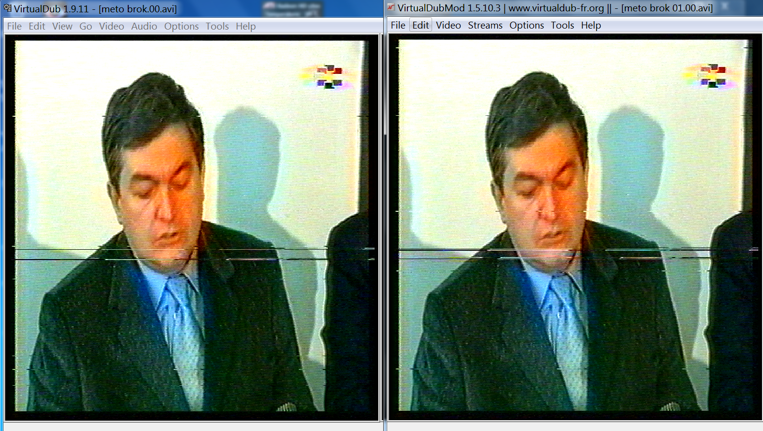

  1. Guys I'm struggling with one really in bad condition tape to transfer it and to restore some of it on PC. First I tryed to fix the tape it self put it in the other housing ( the old one was squiling ) and fast forward it and rewind it couple of times because it had some wrinkles and the tape was like bend it self like from heat or something. I also put it in the old vcr and clean the tape it self with 98% alchocol and take some black garbage from it (no its not the tape couting if you think just garbage) ( althou many of you do not recomend that but i tried on couple of tapes that were mesing my vcr and it really worked they where clean and dont dropeed frames like before). I still didn’t backed the tape ( but I would like to try that in a regular owen so to see what will happen). I uploaded the mkv ( lagarith was to big ) file for you to see what is going on with the tape mind you that noise ( I will fix that in post processing ) and especially color shift is because of the bad antenna reception that I had in the time when the tape was recorded from aerial ( I have 2 or 3 with the same bad tv reception). The source vcr is FS nv 200 passtrough Panasonic dvd recorder ( tbc of the vcr is off because it makes bad jitter when on with these tape especially ). By the way the cleaning of the tape helped tremendously because before it was unwatchable at all ( the vcr head is regularly cleaned if you mean that) but it has some constant lines going up and down and periodical tripping I don’t have dropped frames by the way so I know it’s the tape the recording its in vdub lagarith 720x576 25 tff. I know that some will tell me to forget but can someone help with some software script ( no hardware ) that can at least minor this error i know that you guys know
    http://www.mediafire.com/?xt18n1g0ua6hdsc
    Tried with despot and descratch in avisynth ( even tries the doom forum that talks about this)but nothing happened, I played with the parameters probably the last resort is photoshop and frame by frame to mask the errors some suggestions are welcome
    1mb picture file link
    http://www.mediafire.com/?pwoyhbpbmdyovz8

  3. If you capture the tape again are the lines in the same places in the same frames? Or do they vary with each cap? If the latter, you can use a median filter and 3 or 5 caps to eliminate most of them.
    https://forum.videohelp.com/threads/340963-Best-quality-and-speed-video-denoisers-2011?...=1#post2122313
    Then you can work on the other problems. I don't have multiple caps so I used your one cap with single frame offsets, backward and forward (as a rough approximation of 3 caps, since there's little motion) and a median of 3. First 5 seconds attached.

    You only need to look at two short caps to see if the lines are in the same place or not. If they're all in the same place the median technique will not work at all.
  15. You only need to look at two short caps to see if the lines are in the same place or not. If they're all in the same place the median technique will not work at all.
    Yep I know that unfortunately the lines going from top to bottom are the same on same spot ( no surprise) there but random drop outs probably from bad tape and loose oxidation ( garbage trough screen is not on the same spots twice so median blend will help right?) for lines I think the poisontread script is perfect ( at least on the example that he send me ) but I have some script understanding problem ( I change to avisource for the lagarith file instead of ffsource but I don’t understand “fpsnum=25, fpsden=1, seekmode=0” probably not necessary right ?
    [Attachment 10811 - Click to enlarge]

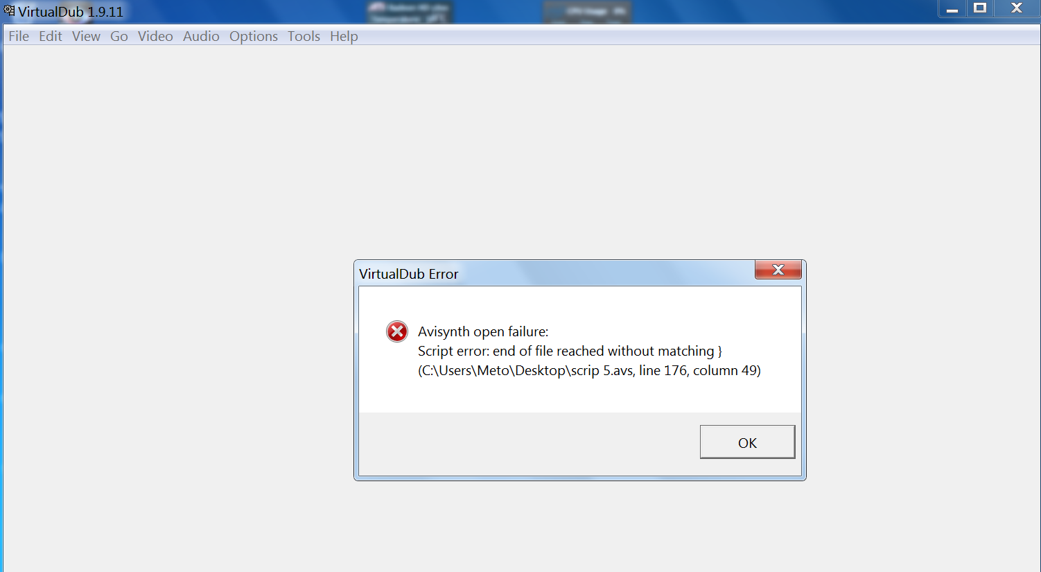

    [Attachment 10812 - Click to enlarge]
    Here we go again I get error on the script

    The error message
    http://img826.imageshack.us/img826/2492/untited2.png
    I’m using avisynth mt version 2.5.8 this is my plugin folder
    http://img69.imageshack.us/img69/3224/avisynth.png
    So I will use FFVideoSource then your script just source file different
  21. I posted the screenshot here, incase problems with imageshack
    What does that line correspond to? line 176, column 49? Upload your .avs file (the spaces and line order might make the script different than mine)

  23. Here is the avs script
    yes the source is lagarith also maybe Super = msuper() is problem
  24. By the way how do you know which line is which and which column is which in notepad is something counting them automaticly that I don’t know
  25. I use avspmod, and you can see the line numbers easily
    Not sure of the error, that corresponds to the function RX
    line 176
    Source.trim(0,-N) ++ last ++ Source.trim(N+X+1,0)
    It might be that I did it in sections, preceded by AVISource after the 1st half. Try it that way
    EDIT you're missing a "}"bracket
    You copy & pasted the code incorrectly
