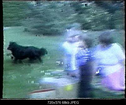

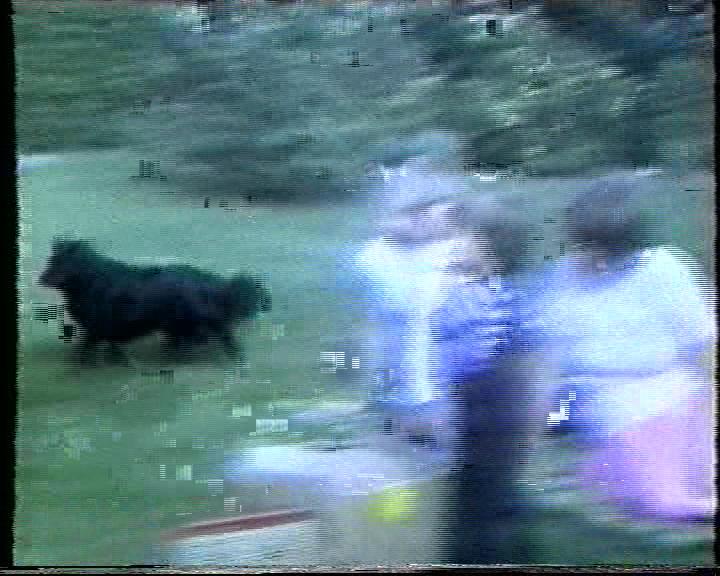

  7. The blocky artifacts that appear sporadically in your caps are indications of capture problems:
    That type of error can't happen on VHS tape. You should be able to fix it by capturing again. You need to figure out why the data is getting corrupt while you're capturing. The usual culprits:

  8. That type of error can't happen on VHS tape. You should be able to fix it by capturing again. You need to figure out why the data is getting corrupt while you're capturing. The usual culprits:
    That's what I was thinking it could be hardware ( the card) or most likely software ( drivers for the card or program in this case wintv ) i had the same ( almost identical) like compression glitches with asus es3 hybrid card. That's why i suggested to capture again in virtualvcr it can support the card ( i think i cant try it myself ).

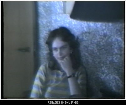

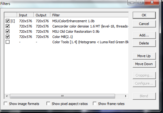

    I allready have filters in virtualdub to help with colors, hang on ill post a screen
    Dec 2011
    Denmark
    Just toke 3 random screens... i think masters has mate the colours look realy good...
    So this is where we are now... anyone have more ideers or are we ready now?

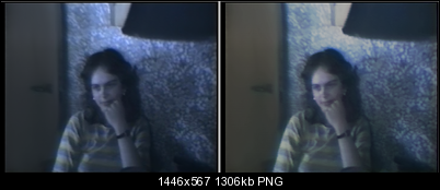

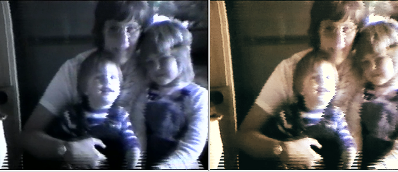

    i will try it now and let you know how it goes
    Look on the third picture especially you made it worse you blown the sky on the left thats a no go

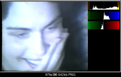

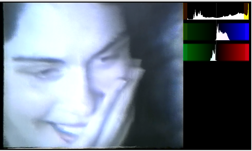

    You have excessive superwhites in the video Click image for larger version
ID:	11766 fix that first in avisynth then go to vdub i will do it after launch and post it here

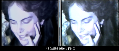

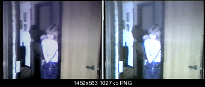

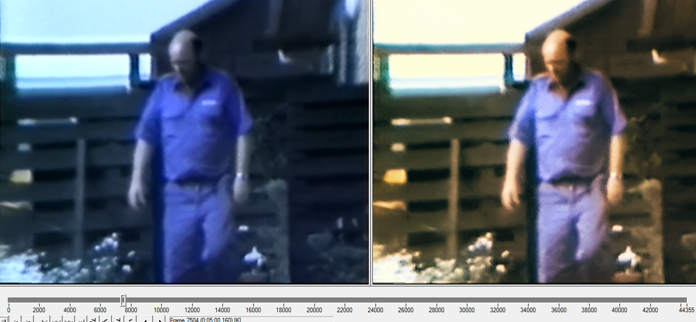

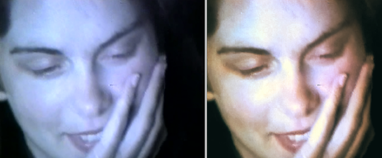

  18. Click image for larger version
ID:	11773Click image for larger version
ID:	11770Click image for larger version
ID:	11771Click image for larger version
ID:	11772 what do you think
    You should split the clip into scenes ( the bright and the dark ones ) and work separatly on them.
    The "best" solution as was mentioned a couple of times is to recapture ( couple of times is best ) with correct levels
    do median do the script correct the color and levels and then encode to mpeg
    That's just my tough i think the others will suggest you something better

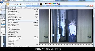

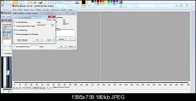

    The scripts you postet is in a avs file, that file i have open in virtualdub and added those filter....
    So now i need to encode from virtualdub, how do i that ? And with which programs???

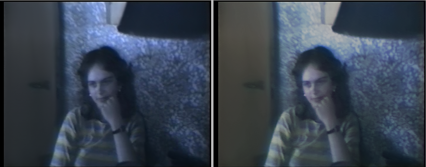

    BTW the correct picture is the one on the left right???
    Dec 2011
    Denmark
    Btw the virtualvcr you talked about its Can find my pvr-500 but not the audio part

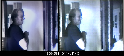

  22. Im not sure what it is you correctet? Maybe im getting tired

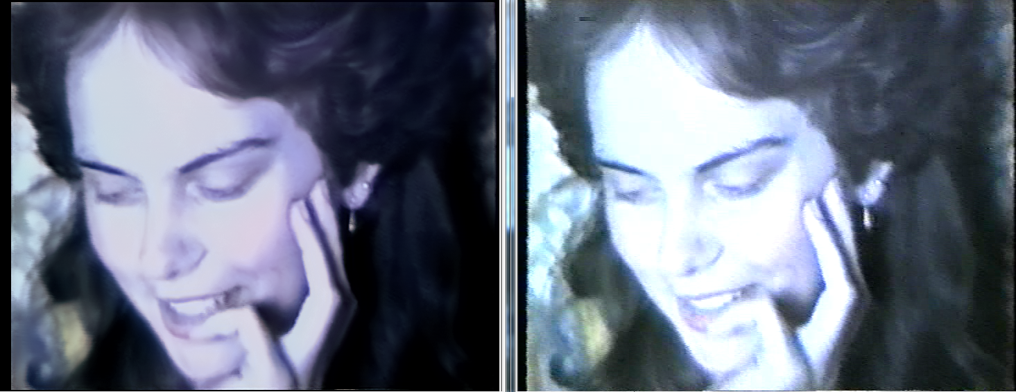

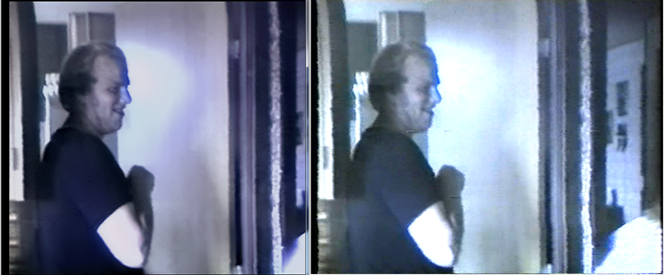

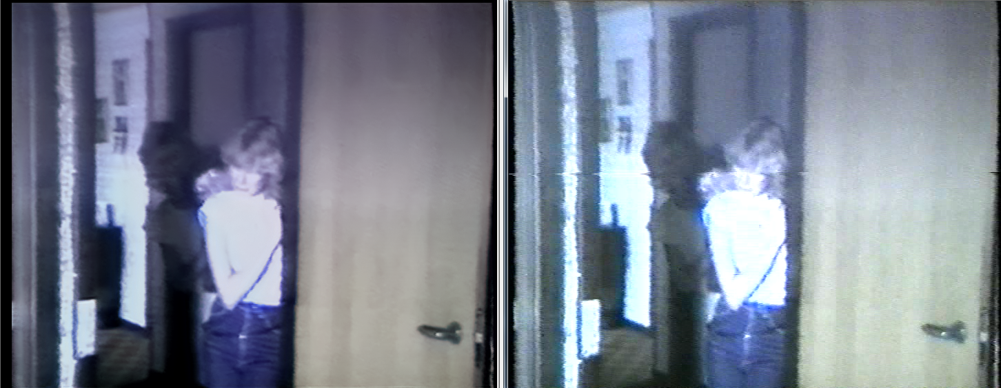

    yes the last three the first one is on the right it has a little more red.
    MSU filters are ok ( especially old color r but you have to be careful it can led to psychedelic colors some times) I don't like the msu Mce filter it boost the colors unnaturally for me at least so i don't use it.
    The pictures show you how the bad frames were repaired automatically and the correct levels were used, because your video had super whites that means you had details in the area ( the yellow on brown part right side the upper picture) that when rgb conversation occurs ( vdub works in rgb32 avisynth in yuv ) you will loose those details in the shades and will lose information. The other thing is that levels are over burned and that mean some of the detail are lost, thats why we are telling you to recapture it again with correct setting ( if you do restoration that always means capture in yuv2 losless and then go to mpeg2 as a final step )

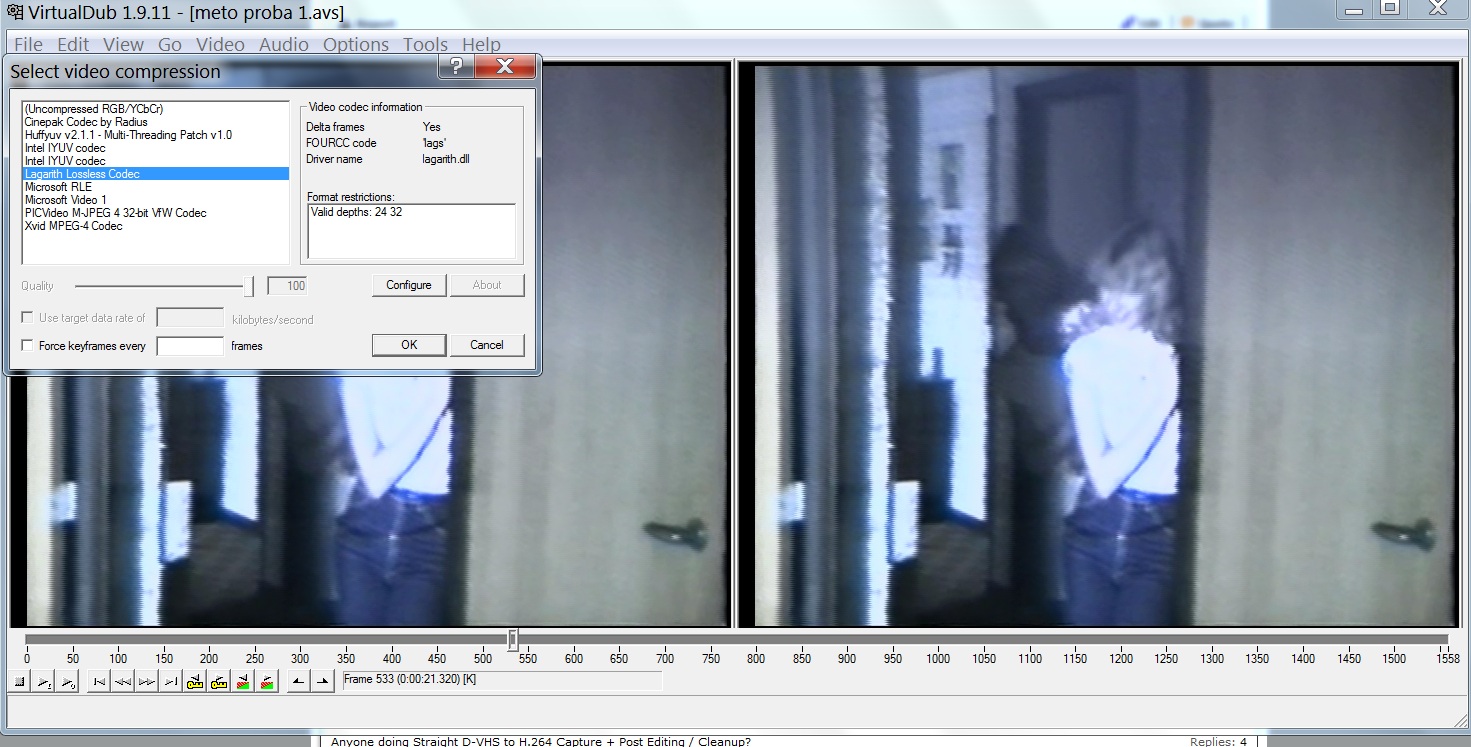

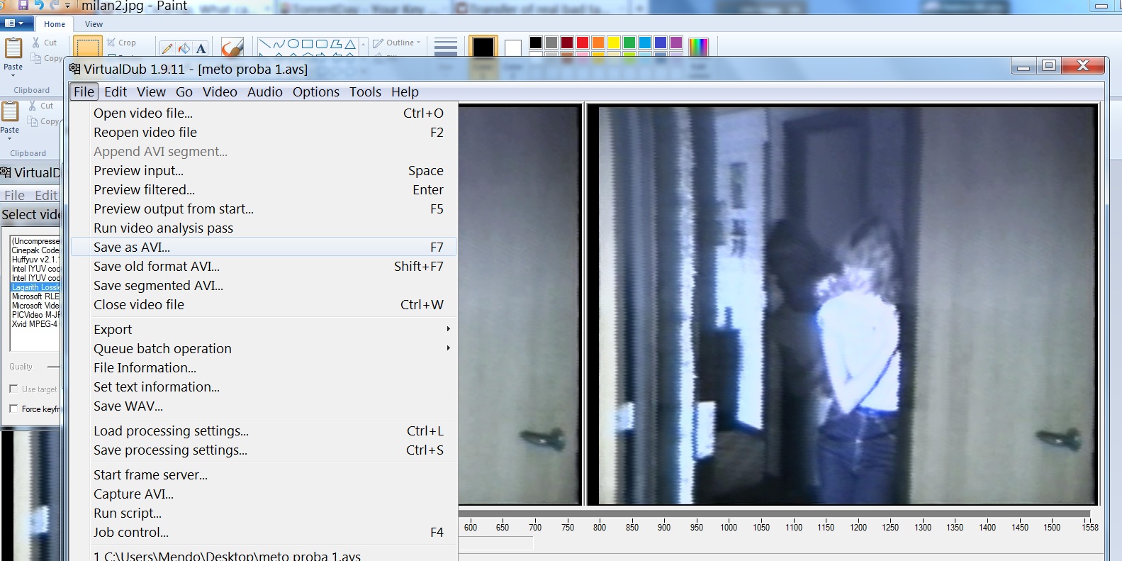

  24. So now i need to encode from virtualdub, how do i that ? And with which programs???
    first in video you chose compression then in file save as and you are done no other program you render the avs in vdub

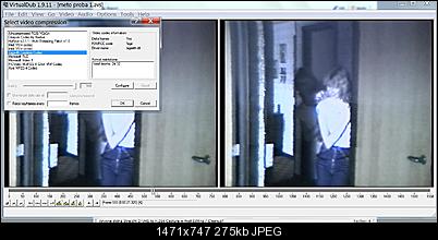

ID:	11776Click image for larger version
ID:	11774Click image for larger version
  25. Member
    Dec 2011
    Denmark

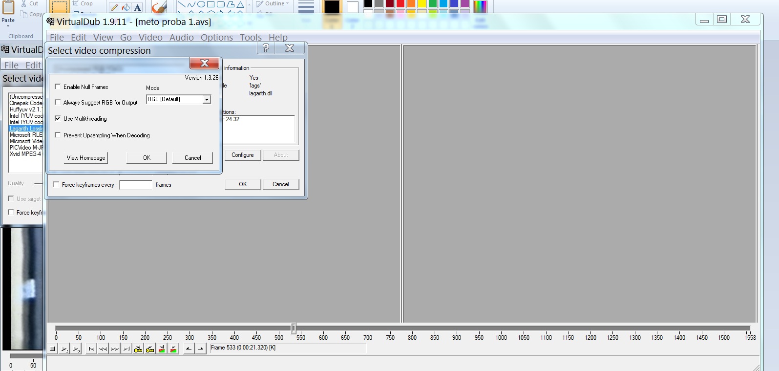

    you save the lagarith as rgb
    rgb??? i dont understand???
  26. you save the lagarith as rgb
    yes what you dont understand vdub works as rgb and all the filtering in vdub is rgb ( it is natural to exit in rgb to not make color conversation anymore till the final encode as we done that in the script as final step. It is not good to do many color conversations yuv to rgb ( but you dont have choice becaouse you do the filtering in vdub so you have to go to rgb ) you exit in rgb so you dont do another one ( vdub openes rgb works in rgb exits rgb instead of vdub opens rgb works in rgb exits yuv conversation occurs )

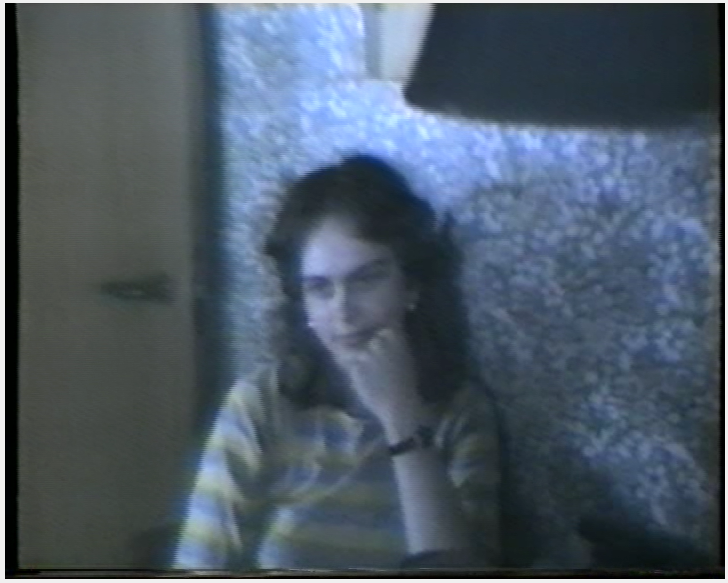

  29. I did some more tweaking today i believe that's the best you can expect:
    video: http://www.sendspace.com/file/5zwgd2
    I've cropped too much but anyway you get the idea for the colors
    The histogram (rgb) seems happy for most scenes and my eyes are aswell, don't think i can do more frankly.
