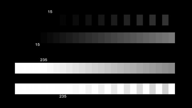

    Jagabo posted some test videos with greyscale patterns for monitor calibration. I don't have the links handy, but they are useful in determining what is going on. I'm sure he'll post the links
    EDIT: here it is , and the link in that post
    https://forum.videohelp.com/threads/313178-A-problem-with-dynamic-ranges?p=1965119&view...=1#post1965119

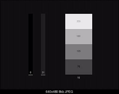

    Thanks poisondeathray/jagabo, that's really useful. It looks exactly as it should with every media player I've tried:

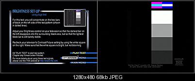

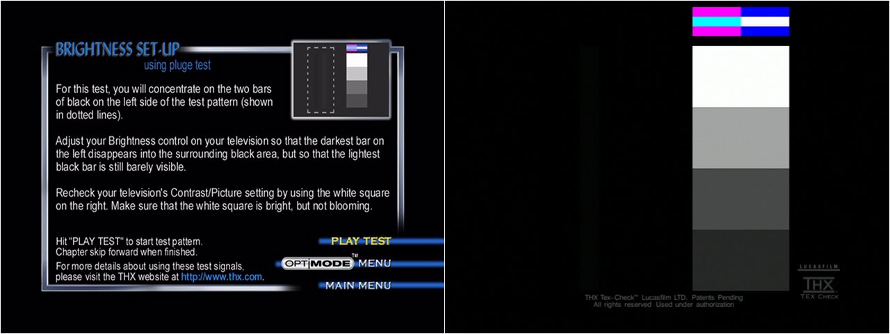

    I also found a THX calibration test on the 'DVD Demystified' disc; and I think I'm getting correct results with that too:

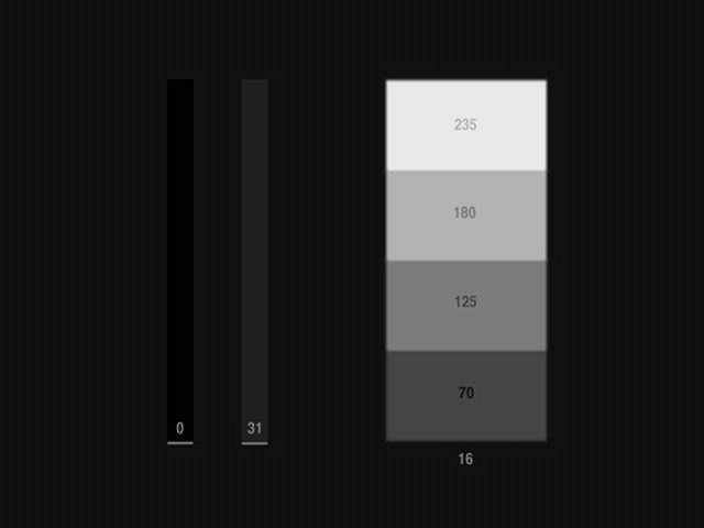

    What confused me was one of the other calibration charts on the DVD Demystified disc:
    *ignore the slightly ribbed pattern on the background - it appeared when I saved the screen-shot as a jpeg.
    I would have expected to see the background (Y=16) to appear black which would then make the leftmost vertical bar invisible.
    Could this be an authoring problem with the disc rather than my computer?

  2. Originally Posted by intracube View Post
    [Attachment 6317 - Click to enlarge]
    It looks like an authoring problem. Or maybe they mean for the chart to demonstrate something else. Another possibility is that you used a different player. Or had two players running at the same time. In that last case, the two players may look different even playing the same video because one is using the graphics card's video processing ability (video overlay, basically a hole in the Desktop through which you see YUV video) and the other is using the Desktop (software is converting to YUV to RGB and displaying RGB on the Desktop).
    As the chart is alongside other calibration images (colourbars, overscan, etc), I think it's intended to be used to set up a TV screen - rather than to conceptually show the 16-235 levels.
    I used one player at a time (xine) which showed up the error with the DVD Demystified chart, then immediately opened the grayblocks2.m2v video - which looked correct.
    I also tried other players; ffplay, mplayer - grayblocks2.m2v looked correct with both, while the DVD Demystified chart looked wrong. Although there are other test charts on the same disc (THX calibration charts) that look correct.

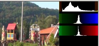

  5. Sorry I made a mistake - If you use avisynth's colormatrix filter to convert to BT709 - colors will look "right" when youtube converts to RGB for display for SD source - I just confirmed this
    colormatrix(mode="rec.601->rec.709" , clamp=0)
    But I'm not sure how to do that in linux? Maybe it will work with wine ?
    Avidemux has a coloryuv filter, that has a BT709 option but it doesn't work properly (when examining the exported file). Also the preview in avidemux is very very off. I remember reporting that in the avidemux forum over a year ago, but it still hasn't been fixed

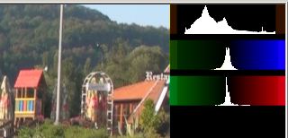

  6. Be carefull while exporting from Sony Vegas through DebugMode frameserver, it changes colorspace.
    It needs to be fixed , for RGB input:
    ConvertToYV12(matrix="PC.709")
    or this line for YUV input:
    ColorYUV(levels="TV->PC")
    otherwise it is going to be clipped entering encoder to 16-135:
