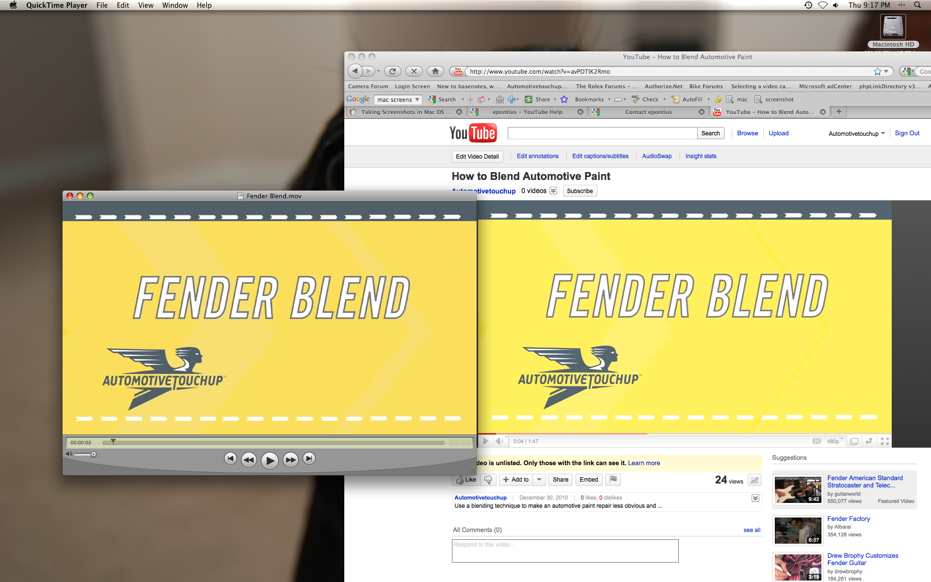

    Youtube changed the color on my video. The left is the original Mpeg4, while the right is the uploaded version played on youtube. Not only is the yellow off, but the youtube version plays much darker and oversaturated compared to the original. What happened?

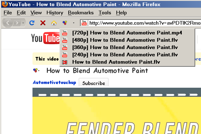

  11. There are many ways to download Youtube videos. FireFox with the Download Helper plugin, for example:
    There are also web sites that will do it for you. Go to this web site and enter the URL for your video:
    http://keepvid.com/

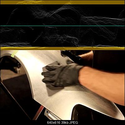

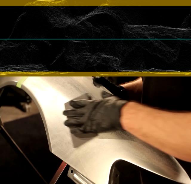

  15. Both the 640x360 FLV and the 1280x720 MP4 I downloaded (both AVC) had the brighter yellows when viewed locally. Using AviSynth's Histogram() shows the two files contain (YV12) luma values outside the normal 16-235 region:
    This is a graph of the brightness of the video, scanline by scanline, summed into one graph. The yellow peaks and valleys in the brown bars shouldn't be there. They should be completely within the black area.
    I'd have to see the original MOV file to say exactly what happened. But this appears to be just a RGB/YUV matrix problem. Maybe the original upload was PC RGB (0-255) and was converted to YUV assuming it was studio RGB (16-235).

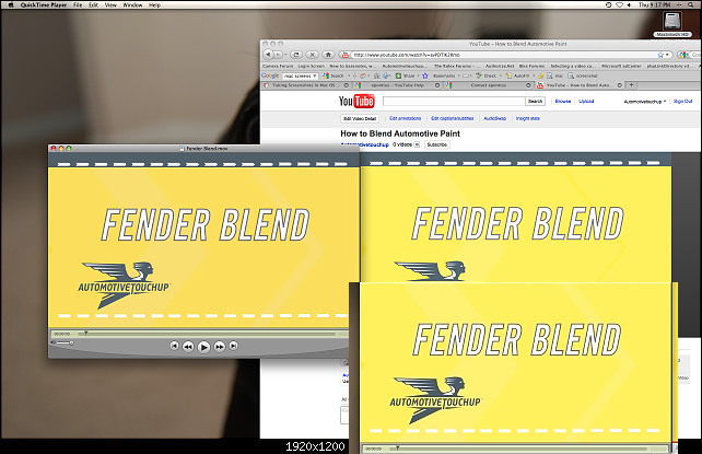

    I downloaded the YT flv video, and rewrapped into .mov with ffmpeg, played with QT
    Left is YT, Right is the same YT video played in QT 7 . (Picture is not hosted by this forum)
    And here is with the gamma shift workaround (now QT player displays video as it should)
    Left is original, Right is with gamma shift fix
    Here is one of the many workarounds
    http://www.videocopilot.net/blog/2008/06/fix-quicktime-gamma-shift/
