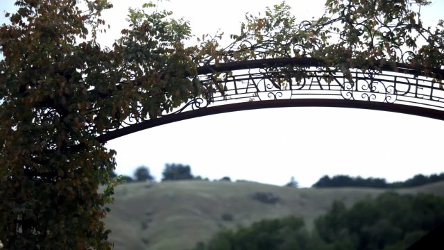

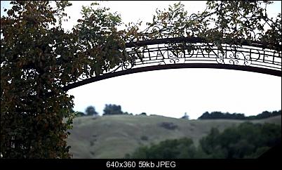

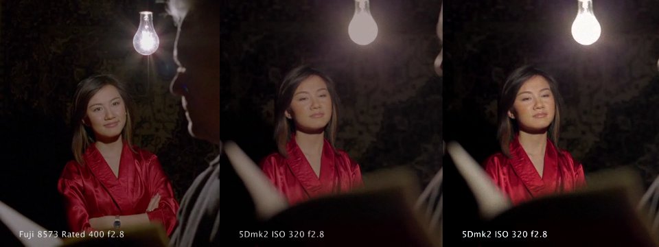

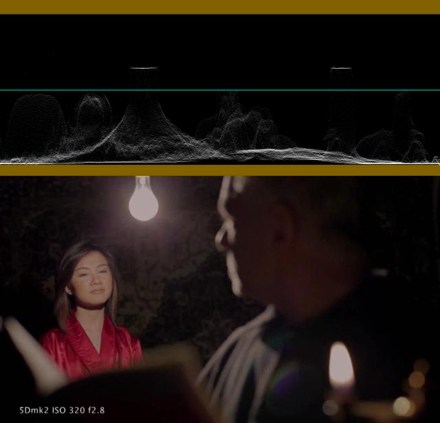

    Going back to the Zacuto link and looking at 'Webisode 1', there's issues with peak white level throughout most of the video - the film examples are mostly stuck at ~235, while many of the digital camera examples are far lower:
    the left and middle images are unaltered, the right has had the highlights lifted.
    Initially I thought it was related to my graphics card and a 235 vs 255 peak white issue. But some of the footage at the end of the video reaches 255:
    image is as it appears on my screen.
    It's hard to draw conclusions with variations like this.
    I would've liked to see them under expose the digital cameras to capture more of the light filament, then colour correct with an s-shape curve to bring the shadows/mid-tones back up. This would reduce some of the ugly digital clipping (but might then show up noise or compression artefacts in the shadows).

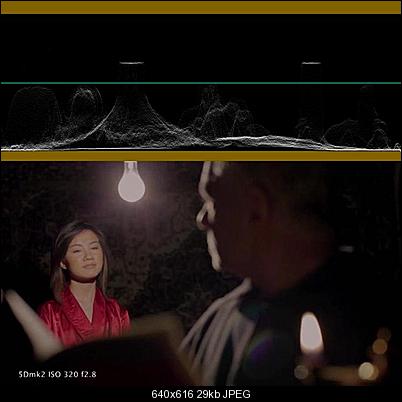

  8. Originally Posted by intracube View Post

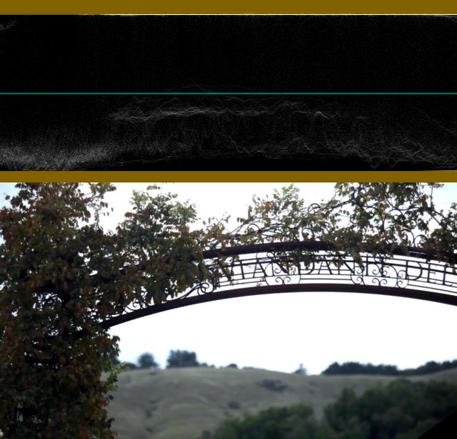

    You should download the videos and look at the levels before conversion to RGB for display. On your computer monitor whites should be at 255, blacks at 0.
    But yes, the peak levels for some of the digital clips are much lower than Y=235:
    The brights on the other shot are overblown but clamped to Y=235:
    I can't find an easy way to dump the stream using Linux. DownloadHelper doesn't work, and tools suggested in other theads are Windows based. Any suggestions?
    I'm still having trouble figuring out what my computer is doing when displaying video files. When I've collated some more info I'll start another thread, rather than take this one off topic.
    [Attachment 6303 - Click to enlarge]
    *Hmm, I can't seem to make that attachment visible any more.
    Are you saying that the peak Y values in the raw video for that specific shot (attachment 6303) are actually 235, and my computer is expanding the range to 255? If so, it's odd as earlier on in the video the Fuji 8573 example seems to be clipping at Y=235 - and in that instance it's not being brought up to Y=255.
    Am I making sense?
  14. Originally Posted by intracube View Post
    You can try rtmpdump which can run on linux
    Here is a mirror
    Am I making sense?
    That is a luminance waveform, it measures Y' in Y'CbCr , not RGB
    That hard white line at the top means values > Y' 235 are clamped .
    When you view anything on a monitor, it has been converted to RGB . The video itself is Y'CbCr. On PC monitors, black is usually at RGB 0,0,0 , white at RGB 255,255,255 - he's referring to RGB values, NOT Y' when he says that.
    Note these are RGB values for R,G,B respectively, not Y' values in Y'CbCr . I think the confusion probably lies there. What usually happens is Y'235 is "white", but gets converted to RGB 255,255,255 for display on your PC. This is what he means by "On your computer monitor whites should be at 255, blacks at 0. "
    Jagabo posted some test videos with greyscale patterns for monitor calibration. I don't have the links handy, but they are useful in determining what is going on. I'm sure he'll post the links
    EDIT: here it is , and the link in that post
    https://forum.videohelp.com/threads/313178-A-problem-with-dynamic-ranges?p=1965119&view...=1#post1965119
    The choice of decoder used makes a differece on how the natively recorded Y'CbCr h.264 MOV's are decoded from the 7D, T2i, T3i etc... The native Quicktime decoder will clamp values and decode in standard range Y' 16-235 , but libavformat based decoders (such as ffmpeg ) will decode full range (Y' 0-255). There are significant gamma differences and significant quality differences between the QT decoder and other decoders as well when decoding this DSLR footage , but enough hijacking. If you want more info specific to the DSLR processing , just ask

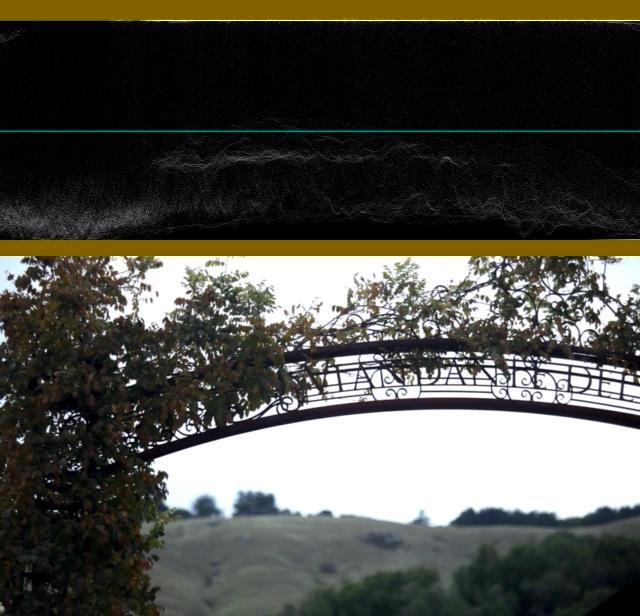

  19. Originally Posted by intracube View Post
    Odd. DownloadHelper worked for me. I started playing the video and it appeared in the DH pulldown.
    Oct 2010
    England
    You're right. What I did wrong was pause the video before clicking on the DownloadHelper menu, which screwed things up. Leaving the video playing made the .flv file appear on the menu. I've just updated to the latest version of DH, and that particular bug has been fixed.

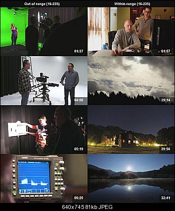

    Back to the luma issue. Looking at the raw video with mplayer and forcing it to not convert the levels from 16-235 to 0-255 seems to confirm what I was thinking - that some of the shots go above Y=235.
    The image I posted of the arch & vines was a bad example - I can now see that shot stays within spec.
    The images on the left have pixels that go above Y=235 (but not below Y=16), the images on the right seem OK:
    On the topic of using DSLRs to shoot video - I'm really excited by what's now possible. In addition to the shallow depth of field and low light capabilities, using DSLRs opens the door to using a wide range of specialist lenses; super wide angle rectilinear/tilt shift/telephoto/macro/etc - without the need for clunky adapters that affect the image quality.
    Philip Bloom's short film at the end of the first Zacuto video looks gorgeous. The DOF, the lack of noise, lens artefacts (chromatic aberrations/purple fringing etc) and skilled camera work all give the video a silky smooth quality. Great stuff.

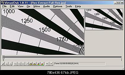

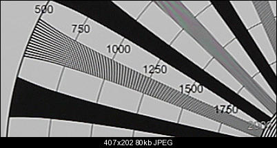

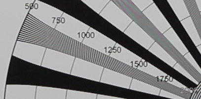

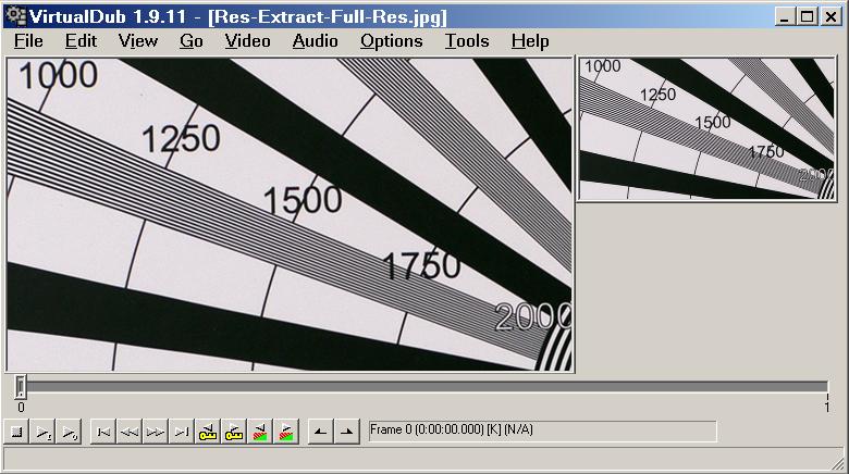

  24. The picture with the resolution test pattern is showing the result of a simple bilinear (maybe simple bicubic) resize.
    Here's their "good" image with VirtualDub's Resize filter in Simple Bilinear mode:
    Click on the image to see it full size. You'd think Canon could use a better resizing algorithm like Precise Bilinear.
