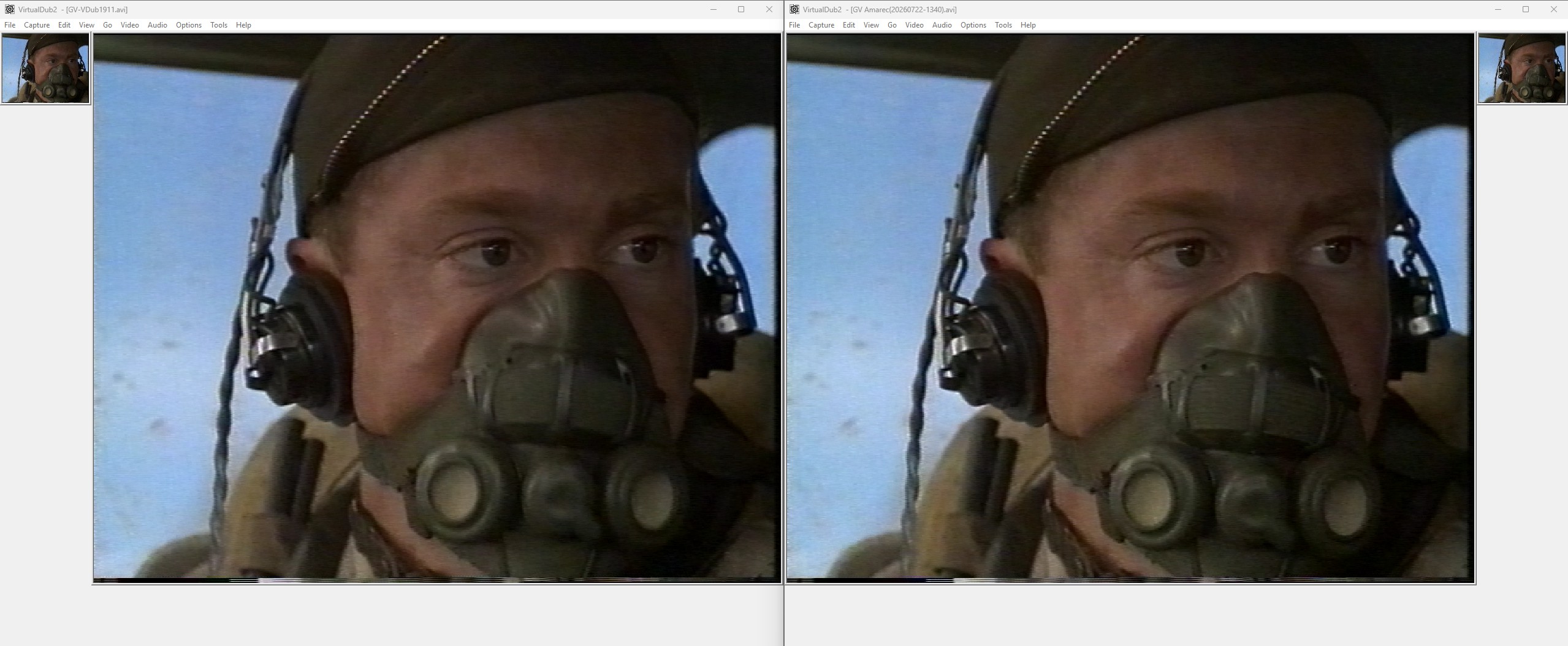

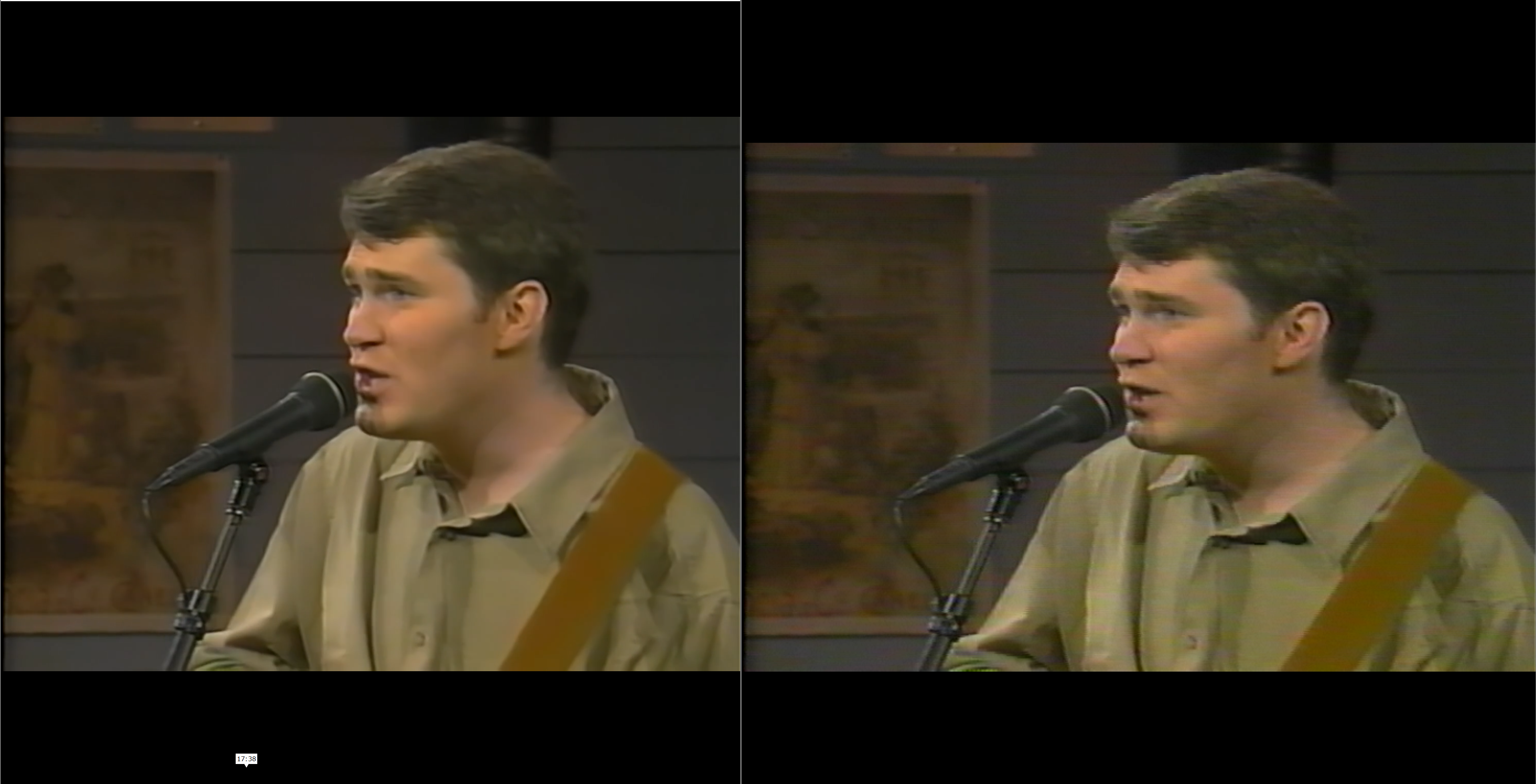

    This is my first time trying to do VHS capture, so please bear with me if I've overlooked something. I'm trying to digitize some rare and out of print folk music recordings for personal use, for some friends and others of interest. I have some modern video editing experience (DaVinci Resolve), but this type of work is all new.
    I initially did a capture with VirtualDub2, but ran into audio issues, so I tried VirtualDub 1.9 where I was able to capture, but was still experience audio sync drift that was not consistent throughout the video. I then tried AmaRec which captured with no sync issues. I've been running all captures through StaxRip for QTGMC deinterlacing, scaling etc, but I verified that the saturation/contrast difference is present in the raw captures as shown in the pic.
    Both sets of software had contrast and saturation at 128 with all other settings at 0.
    Any ideas?
    [Attachment 93152 - Click to enlarge]
    [Attachment 93153 - Click to enlarge]

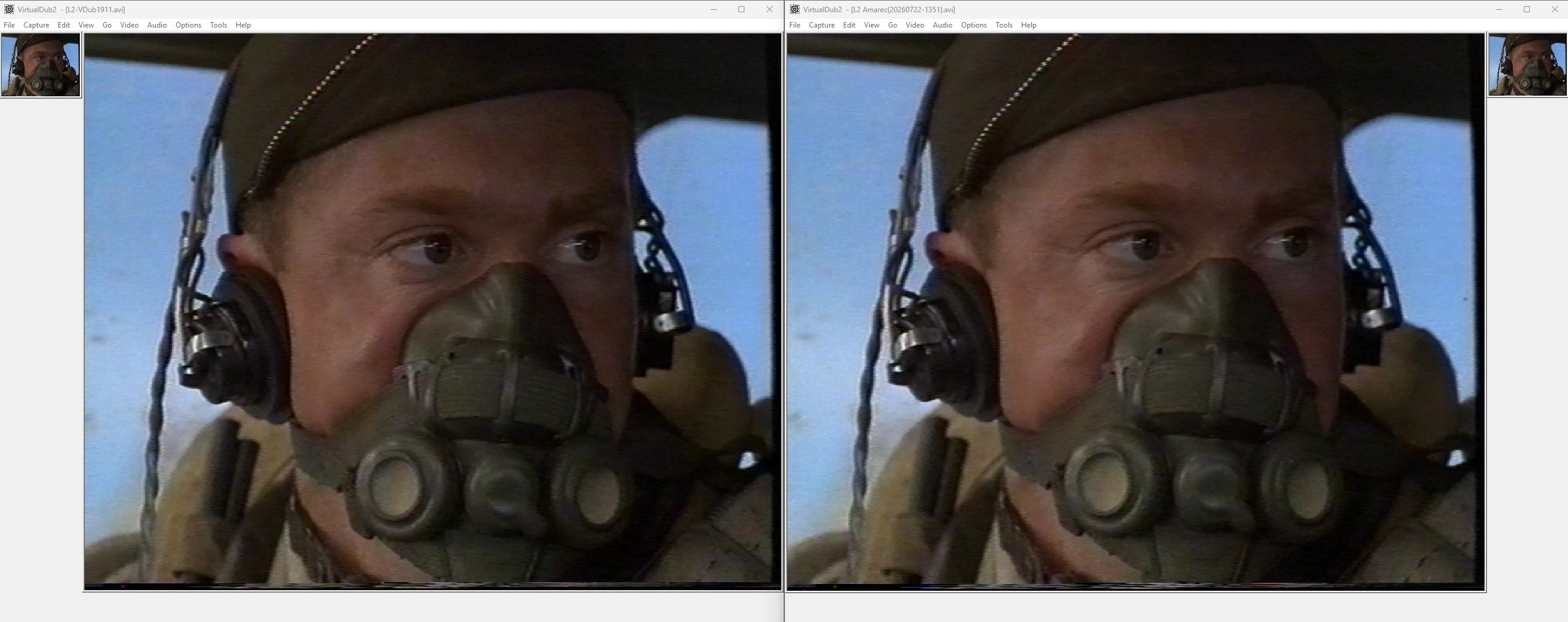

    That's a big difference in levels. I don't know why; I've done some quick tests with an IOData GV-USB2 and a Hauppauge USBLive 2 and both come out with very similar levels (both with "default" brightness and contrast):
    GV-USB2, VDub1911 on the left, Amarec on the right:
    [Attachment 93156 - Click to enlarge]
    Live2: VDub 1911 on the left, Amarec on the right:
    [Attachment 93157 - Click to enlarge]
    Perhaps the drivers of your digitiser are a bit dodgy.
    If you don't nut it out, you can pretty accurately adjust the Brightness and Contrast levels using the histogram in VDub, then use those values in AmarecTV. I have a blurb on this on my site here.
  3. Originally Posted by BullBuchanan View Post
    Any ideas?
    Looks to me like the luma levels got offset (fooled) by the black borders for either case (see attachment). The dark level is actually too high in both cases (especially for the washed out case), lowering the contrast. Can be fixed in post though, or adjusted with proc amp settings for the capturing process.
    When evaluating a histogram one should crop off any black borders as these bias the histogram.
    Upload snippets (few seconds) of your captures so someone may take a look.

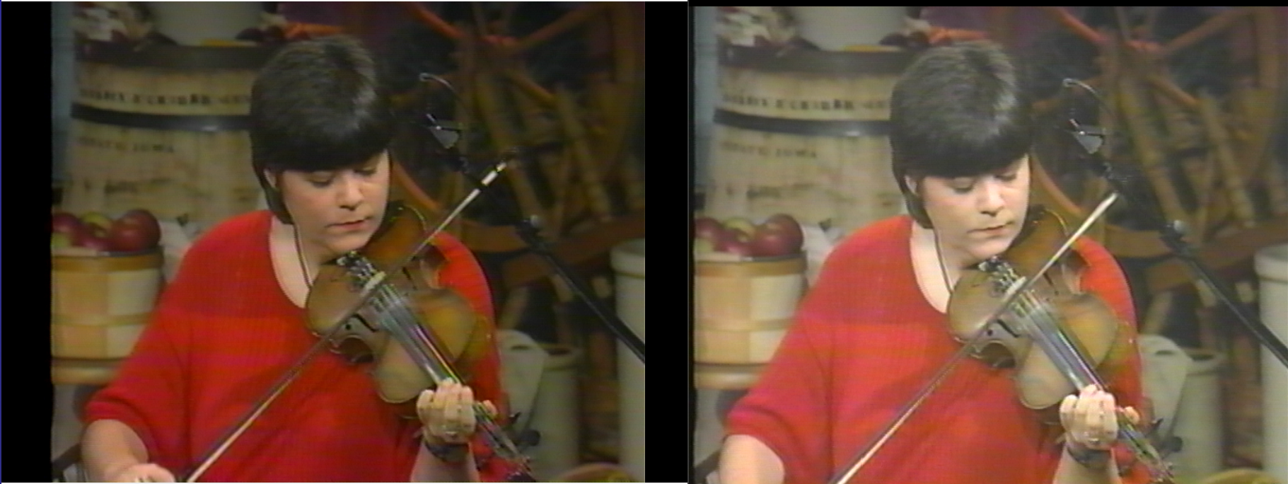

  9. After re-capturing a few times due to some errors, I finally got a good capture with AmaRec. I tried re-capturing with VirtualDub, but still had audio sync issues I couldn't resolve.
    Color looks correct.

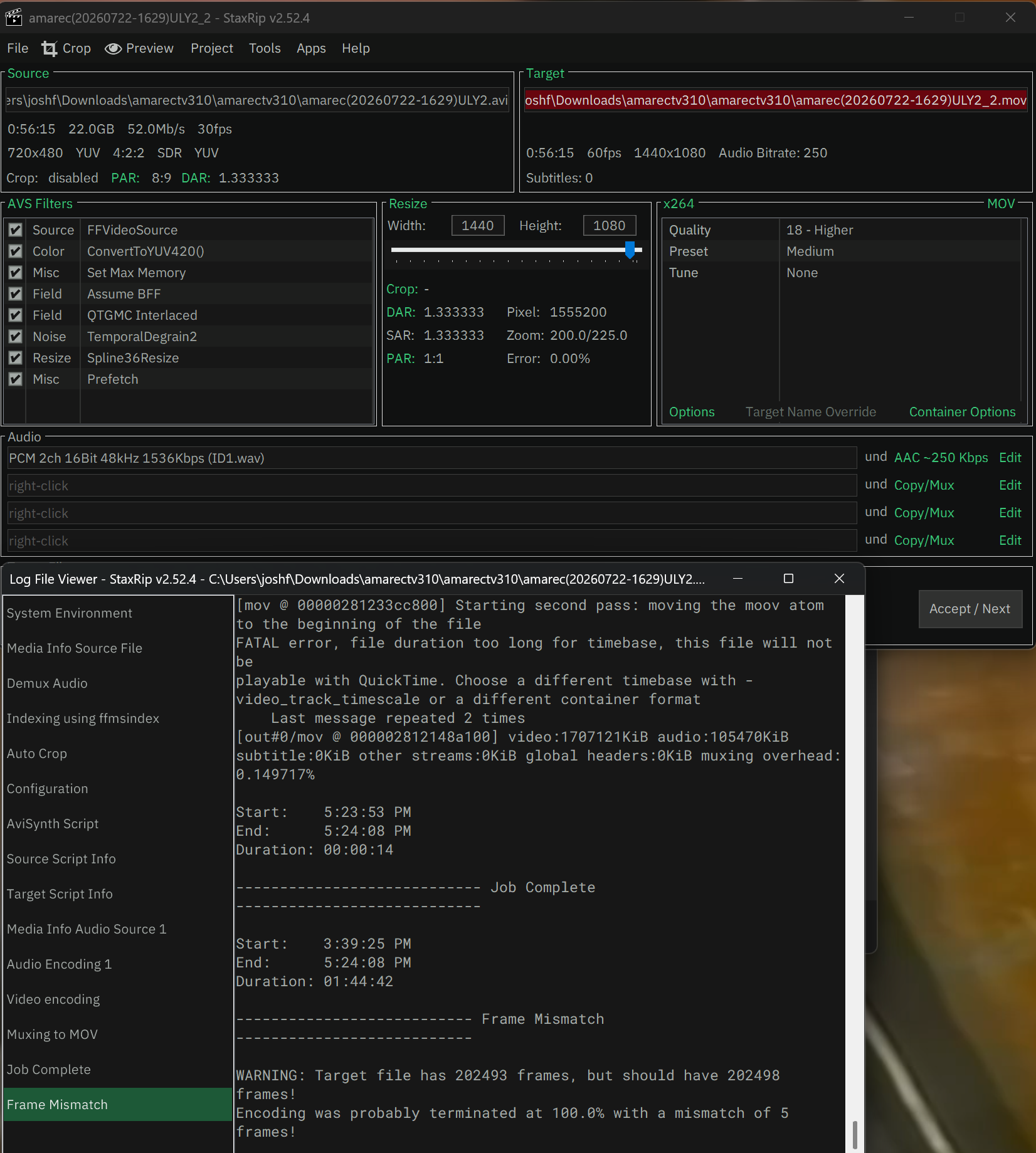

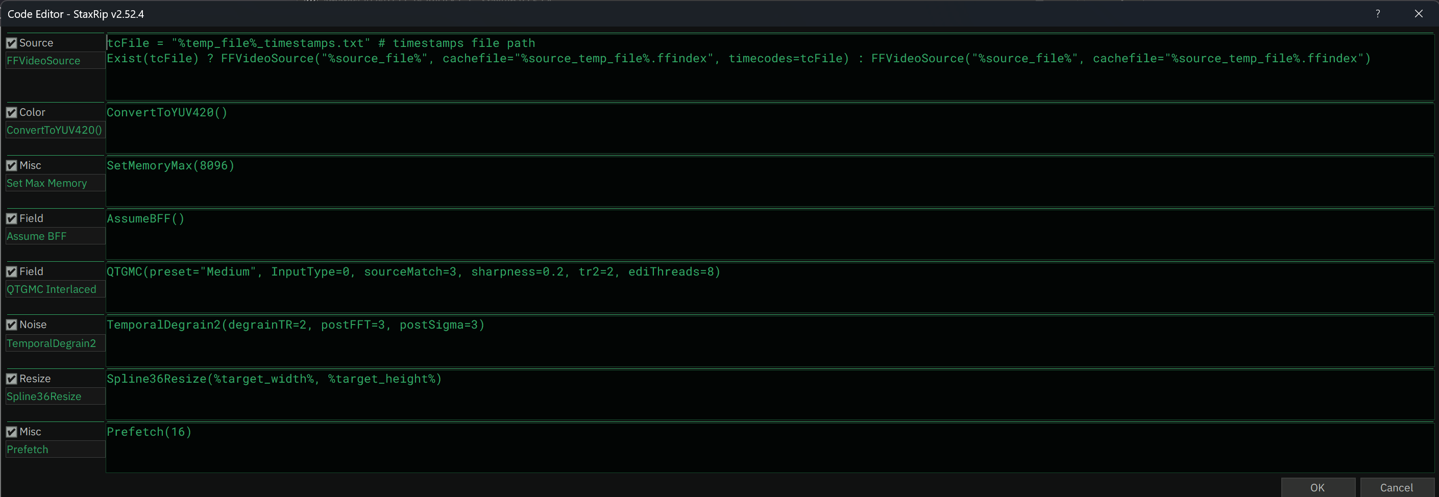

  18. So I got this one processed, though I have run into a couple of new issues. The first one seems to be a 5 frame mismatch that wasn't showing up when I was processing these to uncompressed .mov, but do seem to be showing up now. I ran it twice, disabling the "abort" flag from the menu as recommended elsewhere on the forum. The file plays and doesn't seem to have any issues, it this anything to be worried about?
    Settings and error here
    [Attachment 93171 - Click to enlarge]
    [Attachment 93174 - Click to enlarge]

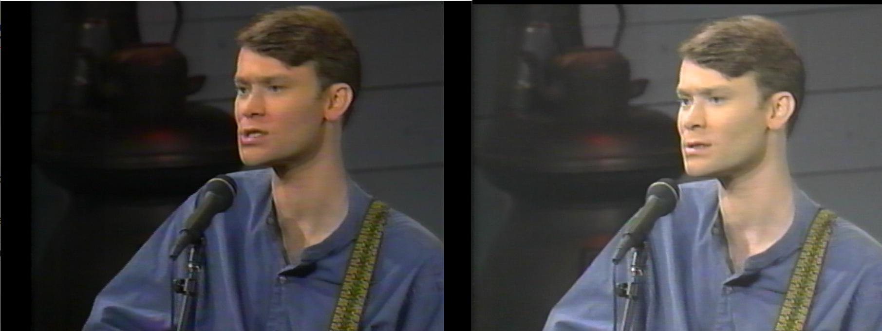

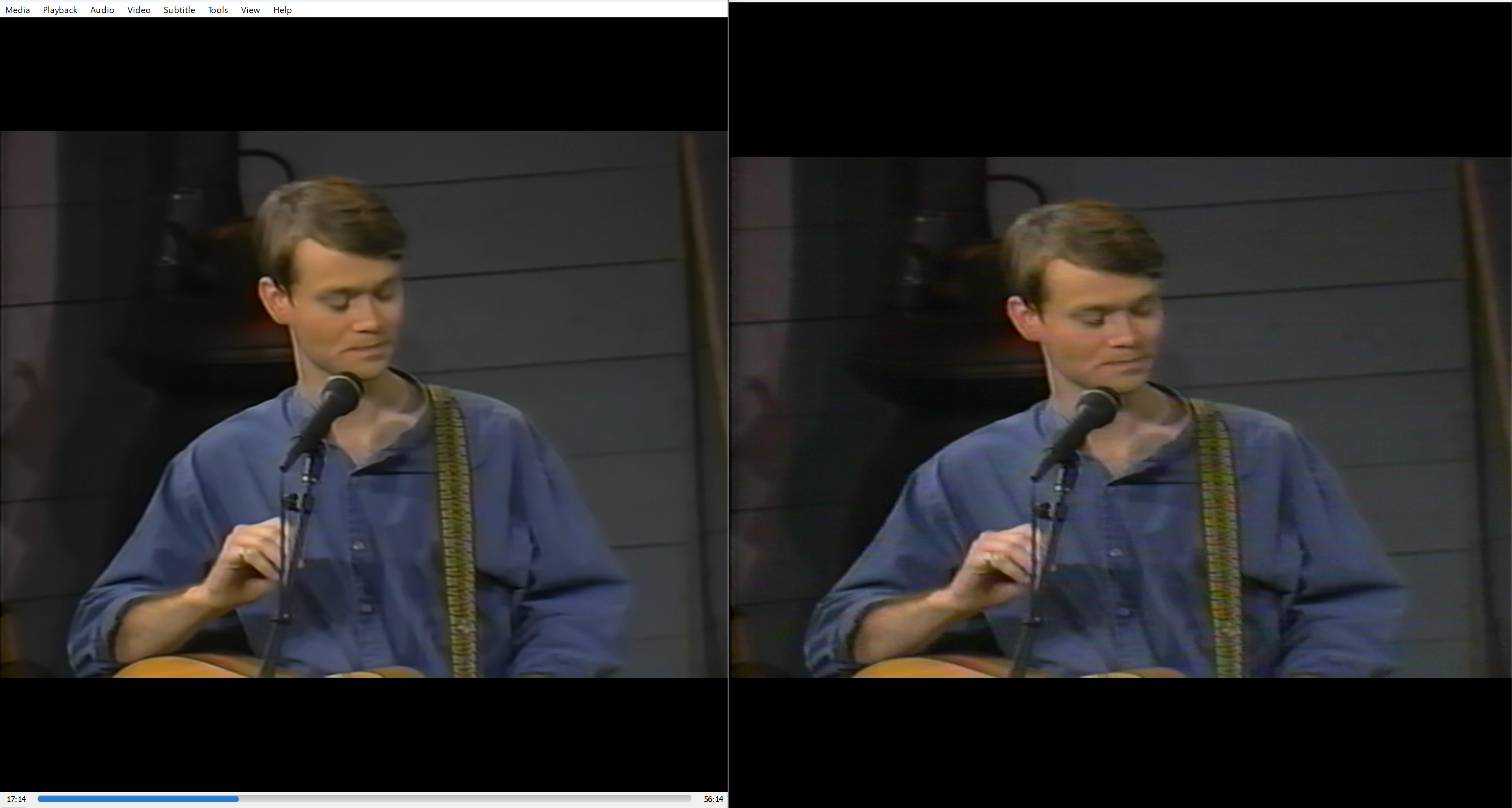

    What's a little more annoying is that my "upscale" and "denoise" process seems to have degraded the image quality pretty noticeably. Note, both of these screenshots were taken on a 42" 4k OLED monitor, so anything but pristine images/video looks pretty awful. The original ULY2 AVI is on the left of both images, while the x264 .MOV is on the right.
    The first image shows a lot more noise on the grey-blue background, the guitar strap and around the singer's face.
    [Attachment 93172 - Click to enlarge]
    On the second screenshot there's more noise throughout the entirety of the singer's silhouette. Is there enough information to say if this is compression related or a result of the denoise/scaling filters?
    Are you sure you've got the left and right right? For the guy in the blue shirt, the left image is miles better: it's the correct aspect ratio, there's no chroma noise (compare the shirts) and it looks quite nice (eyeballing it, the levels are a bit washed out, methinks).
    Re awful on big TVs, I find SD video generally looks better because you are, relatively, much further away than your 27" monitor 2 ft in front of your face.
  20. Originally Posted by Alwyn View Post
    Uh, you're totally right. I have no idea how I mixed them up. I guess all is good then. Thanks.
  21. Originally Posted by BullBuchanan View Post
    Uh, you're totally right. I have no idea how I mixed them up. I guess all is good then.....
    Yep, basically. As a possible improvement you may want to add some chroma shift and chroma sharpening to your processing. Maybe StaxRip offers such options, I don't know.
    Left: your current version. Right: same with chroma shifted 8 pixels to the right (means better aligned to the luma) and chroma sharpened.

  27. Originally Posted by Sharc View Post
    Thanks! How did you calculate it needed to be 8 pixels to the right?

    There is no calculation to do, just experiment with the numbers and find the best outcomes. PAL generally has intrinsic 2 pixels shift (which adds for every copy-generation); it can be more.
  29. Originally Posted by BullBuchanan View Post
    As @lollo said it is basically found by trial and error. To start with something look at the discolored area between the guy's skin and the hair (marked with a circle). From this you can guess that the shift is probably somewhere around 10 pixels. I used Avisynth and AvsPmod as convenient tools.
    1. ConvertToYUV420 <-- Use this at the very end. Filtering should be done to maintain quality on the source material, which is probably YUV422. Preferably still at 10 or 16 bits.
    2. Resize ✓ Misc Spline36 Resize <-- Think about whether you need upscaling. This usually does not improve quality, especially basic ones. So - NEVER UPSCALE SD.
    Besides, I advise against AmarecTV - it loses frames.
