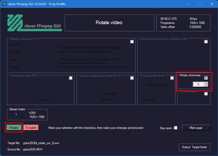

    You can remove the rotation flag without re-encoding using clever FFmpeg-GUI.
    Launch the program, drag your MOV file into it, click “Lossless Changes,” check “Rotate Clockwise,” select 0, and click “Rotate.”
    [Attachment 92991 - Click to enlarge]
    The newly created video no longer has a rotation flag and will play correctly on your Walmart DVR.
    If you want to set the rotation flag again, repeat the procedure and select 180 instead of 0.

    click Lossless Changes,” check “Rotate Clockwise,” select 0, and click “Rotate
    congratulations: this yields upside down in (my windows 7 32bit computer) vlc, MPC-HC, windows Media Player and Walmart dvr
    selecting 180 (instead of 0) yields ok vlc and MPC-HC, upside down on Windows Media Player and Walmart dvr. This result is the same as the original file in my first post
