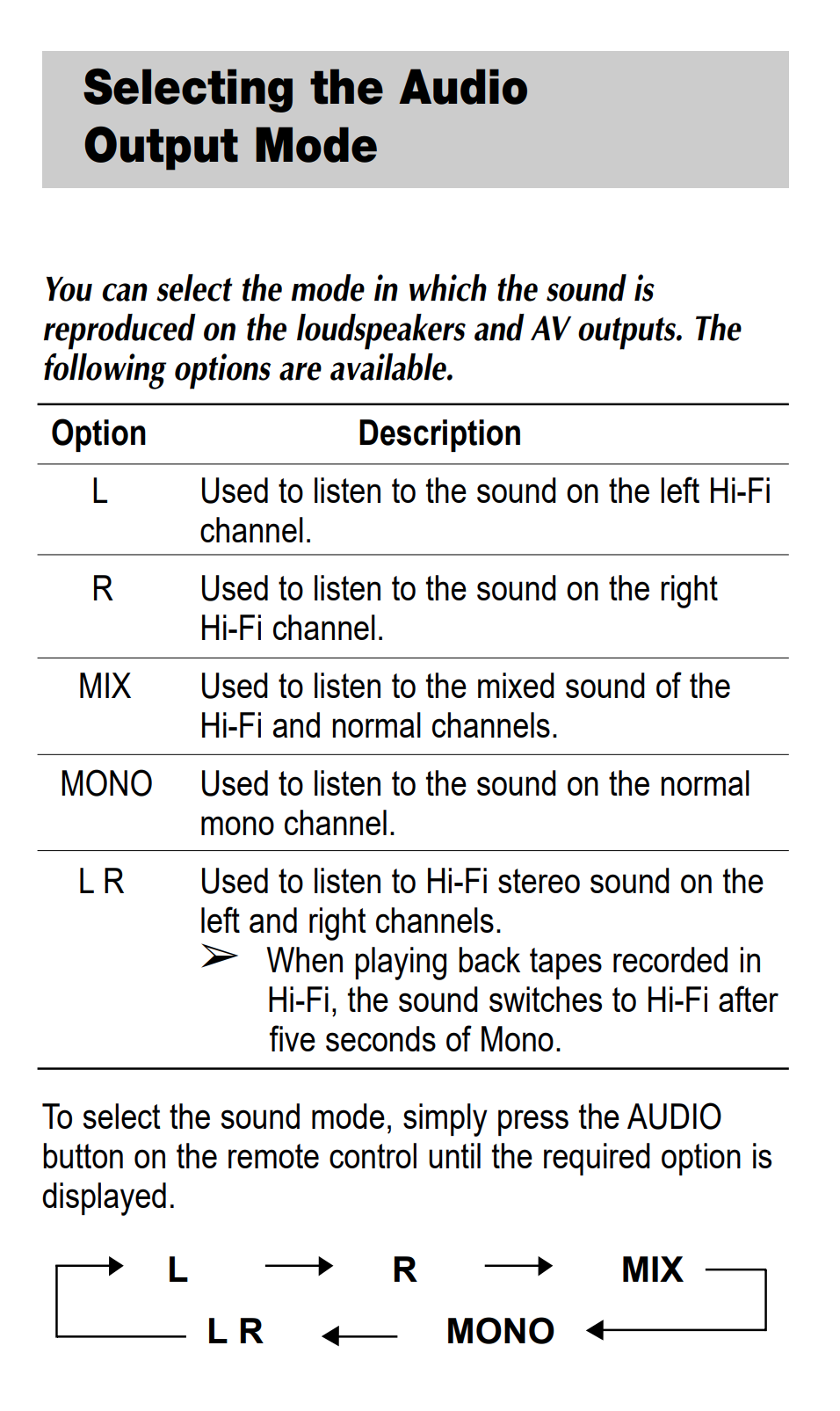

    They are different because one is HiFi stereo, the second one is linear mono. Select HiFi stereo with the remote control.
  4. Just for the record, I have a Samsung SV-DVD545, and nowhere on the remote does it allow you to select Hi-Fi Stereo, unless I'm missing something?
    Would it be worth getting a replacement of the same VCR/DVD deck?
    Jan 2016
    Check the user manual, there should be a menu item somewhere. VCRs default to the linear audio track when the HiFi track is not been picked up, so the video drum could still be dirty.
    Edit:
    Google search:
    [Attachment 91013 - Click to enlarge]
