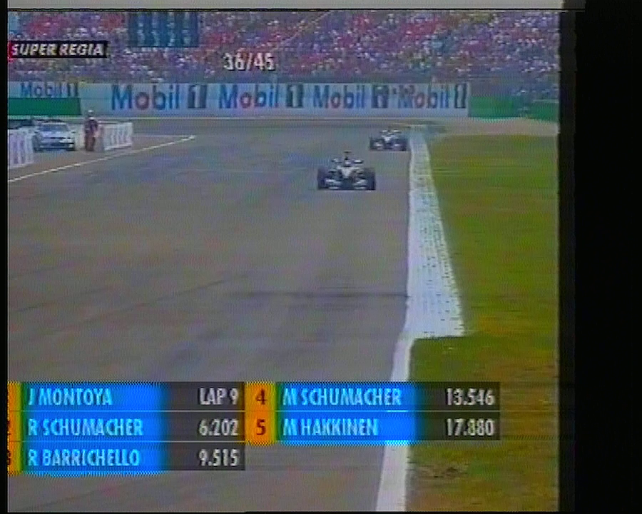

    I'm trying to digitize some VHS tapes, and the video capture quality is poor when I connect the VCR directly to the Video grabber (MyGica EZ Grabber2). Even adjusting the contrast and brightness levels doesn't improve the situation much. [img 1]

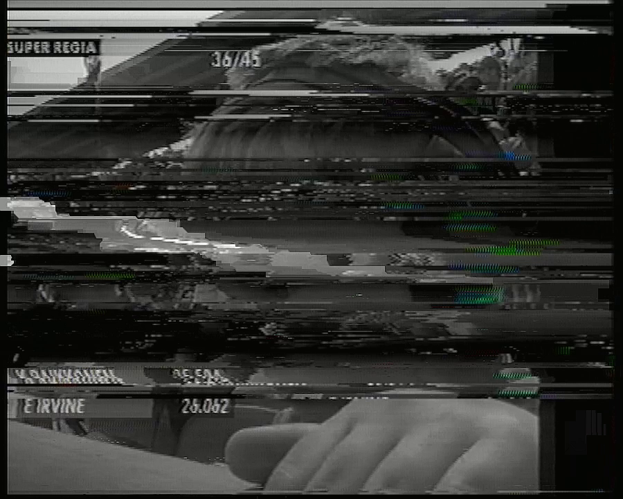

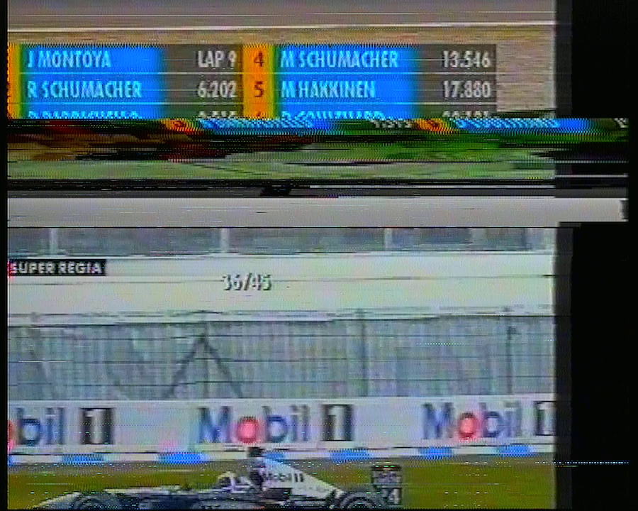

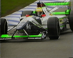

    However, if I connect the VCR to the DVD recorder and then to the Video grabber, the video quality seems much better, but the images are shifted to the left and highly unstable. Please see the screenshots. [img 2, 3, 4]
    Also, consider that if I connect the VCR directly to a CRT TV, the video quality is superior to that on the Video grabber.
    When I connect the VCR to the DVD recorder and then to the CRT TV the image remains unstable, exactly like on the Video grabber.
    Does anyone have any idea what the issue might be?

    [Attachment 74652 - Click to enlarge]
    VCR/VHS --> DVD recorder --> PC
    [Attachment 74653 - Click to enlarge]
    [Attachment 74654 - Click to enlarge]

    Get a real capture device, those 13 dollars capture devices are made to make money not capture video.

  5. What model of dvd-recorder? Even a not so great one shouldn't normally be acting like that.
    Mygica ezgrabber may based on the same conexant chip as Diamond VC500, hauppauge usb-live2 etc. If it's like those, it's fine with stable input so fine if you have a dvd-recorder for stabilizing inbetween, but doesn't handle signal directly from vcrs particularly well.

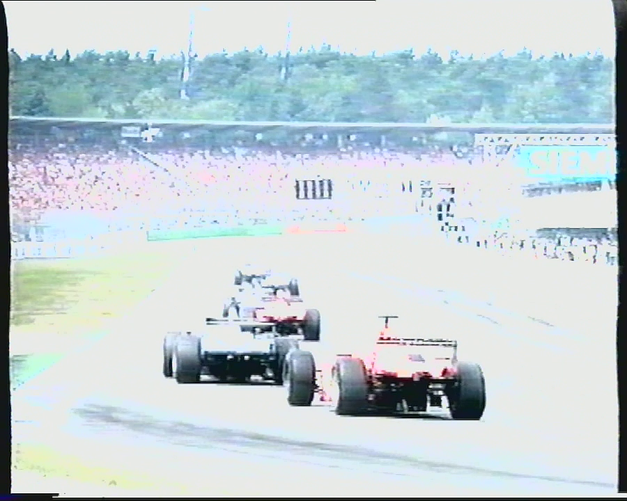

  7. Those white flashes are because the AUTO GAIN CONTROL (AGC) is likely activated in your card. This is one of the many downsides using Win10/11(starting with Win7). You can't disable it unless your card is XP compatible, then use XP..
    https://files.videohelp.com/u/126559/AGC.jpg

    However, I was referring to those dark flickerings (?). They give me also the impression of triggering the deactivation of the capture software's signal at some point and the screen turns blue (a sort of protection?). I don't know if this makes sense.
    [Attachment 74670 - Click to enlarge]
    Edit: An important detail I think is that if I connect the VCR to the CRT TV, that flickering is not happening.
    Timing errors that appear similar to anti-copy/Macrovision errors.

  11. All dvd-recorders (or at least any that I've tried) will digitize and turn the signal back to analog on the outputs though only some have chipsets that do a good job at stabilizing video VCRs so not all are all that great for using for this. Since you are in europe the most common options that work well are panasonic dvd-recorders from 2005 or newer (possibly with the exception of the DMR-ES20 where at least the NTSC variant uses a different chipset, not sure when it comes to the european variant.) Most Pioneers from 2005 and on and Sonys from 2007 on (standalone models only, not ones with integrated VHS) are also an alternative with a bit less robust on very bad tapes but are a bit more adjustable. If you go this route using the mygica capture card you got may be fine.
    The LG dvd-recorder you got seems to be a funai-made one different from most LG dvd-recorders actually does have a chipset that has decent video stabilization capabilities though afaik those are a bit prone to flickering. So, not sure why it's acting so weird. The behaviour is seems odd on the bluescreen and image more than one would expect from just normal vhs instability though so there is a slight possiblity here that there could be some issue with either the dvd-recorder or vcr. Since it acts up on just the bluescreen it doesn't seem to be just an oddball tape either.
