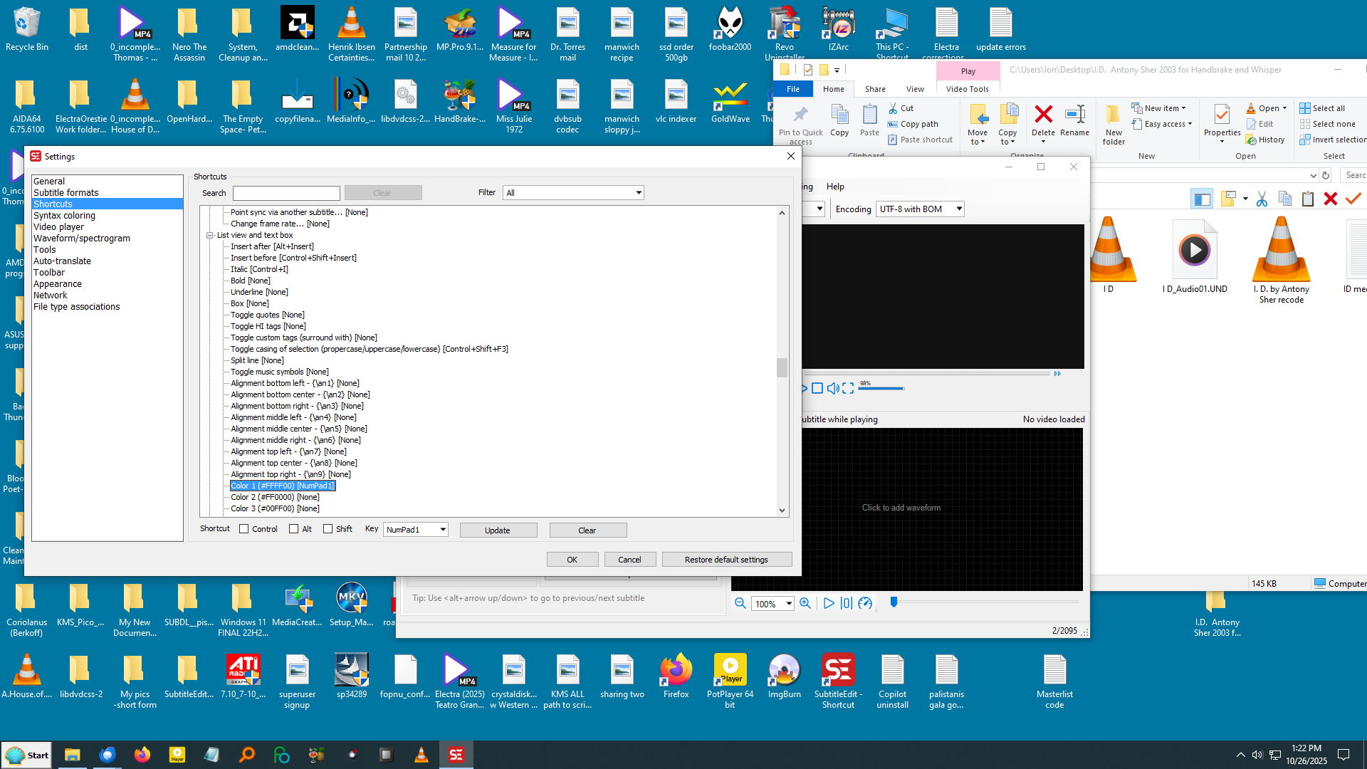

Since my question SE informed me yes there are are some shortcuts for color in earlier releases of SE. Those look like the screen shot at the path SE > Options > Shortcuts > scroll down to List and text.
I was not successful in getting it to work because no guidance on it.

Go > Subtitle Edit > Options > General > Shortcuts > scroll down to 'List view and Text Box' > scroll down to 'color' >
select that, then set the hot key.
To set the hotkey where color 4 is selected I checked Control Box (bottom) + Alt Box and finally at the word KEY, open that and select a keyboard key. I found it best to stick with the F-keys such as F12 because many other key combinations are in use for active SE shortcut combinations.
So in the example to get your color, type Cntl-Alt-F12 while using the SE text box in an active SRT editing.

Since last time I practiced using the optional codes in SE at the Options > Shortcuts > list location. What I'm showing here is a few of those with color tags so one would know which color is accessed by which F-key combination I ser up. It appears that cntl+alt and an Fkey selection works the best.
Also on this post I show some other codes for experimentation: purple, olive etc. But going crazy with colors is not something I would do and perhaps not at all. The phrase (a long silence) was simply a line I chose to practice with from an srt loaded into Subtitle Edit.
<font color="#FFA500">( a long silence)</font> orange cntl+alt+F6
<font color="#FFC0CB">( a long silence)</font> White cntl+alt+F5
<font color="#FFFF00">(a long silence)</font> yellow cntl+alt+F11
<font color="#00FFFF">(a long silence)</font> light blue cntl+alt+F9
<font color="#00FF00">(a long silence)</font> med. green cntl+alt+F10
<font color="#FF0000">(a long silence)</font> red/magenta cnt+alt+F12
