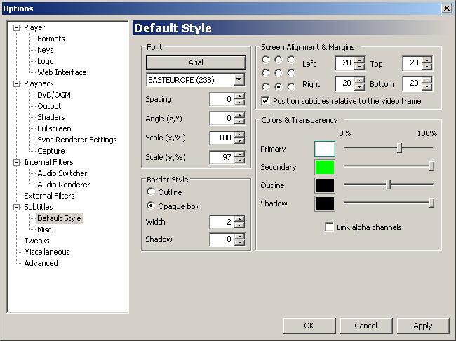

  1. I need some help with the subtitles option in Media Player Classic Homecinema.
    Under "Options -> Subtitles -> Default Style -> Colors & Transparency" I can see and set the "Primary" and "Secondary" colors. The subtitles that are displayed are always white for me, meaning they use the "Primary" color. The question I have is: when does the "Secondary" color come into play? How can I get subtitles to display in that green color?
    Thank's in advance for clarification.

  3. The font is white because I have the "Primary" color set to white. I can change that color and the subtitles will then be a different color. The "Outline" and "Shadow" colors will also reflect on the subtitles (after a program restart). So these three I can change and see the effect on the subtitles, no problem. But I can never get that "Secondary" (green) color to show up in any subtitle. That's why I would like to know what it is for; when does it take effect on a subtitle?

    It is used in karaoke effects in .ass subtitles.
    \k: Before highlight, the syllable is filled with the secondary color and alpha. When the syllable starts, the fill is instantly changed to use primary color and alpha.
