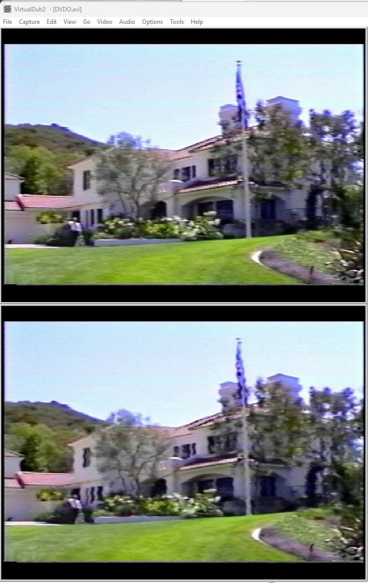

    First impression only:
    - The DVDO is poorly deinterlaced and has wrong aspect ratio. Forget it.
    - The iodata is basically better but the capture SW has probably been set with the wrong framerate (AmarecTV setting issue?)

    Agree with Sharc, that DVDO video is BAD. Even though it appears to be interlaced, trying to deinterlace it creates a mess:
    [Attachment 88251 - Click to enlarge]
