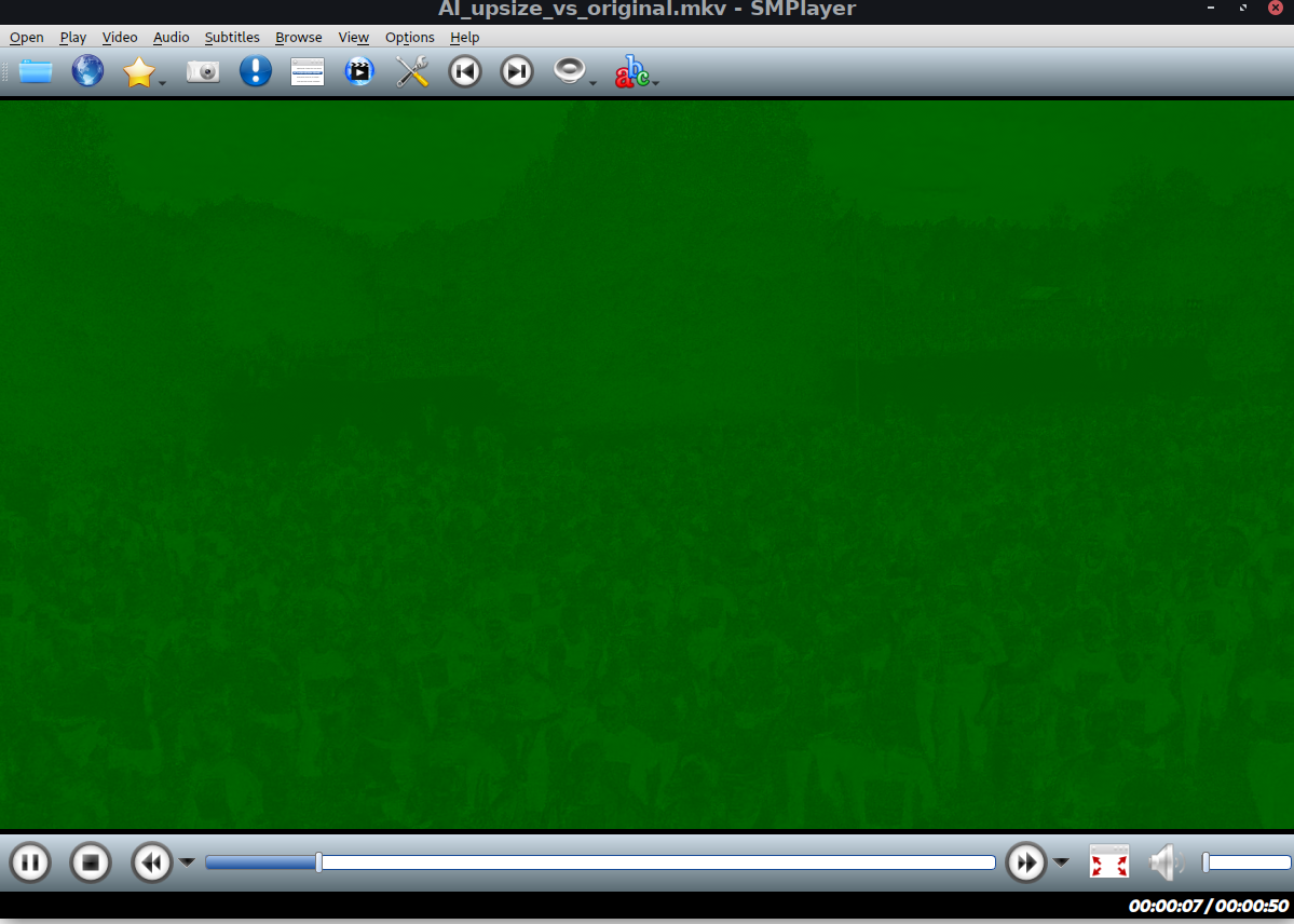

    What do you mean by "green mess"? Do you mean you each frame is predominantly green with barely visible remnants of a scene, like the attached screenshot?
    [Attachment 78549 - Click to enlarge]
    If this is what you are seeing then this is correct, the ffmpeg blend filter with difference subtracts the similarities and leaves the differences.
    If two videos are exactly alike all you will see is green with nothing else. the more dissimilar the files are the more of what appears to be a scene you will see.
