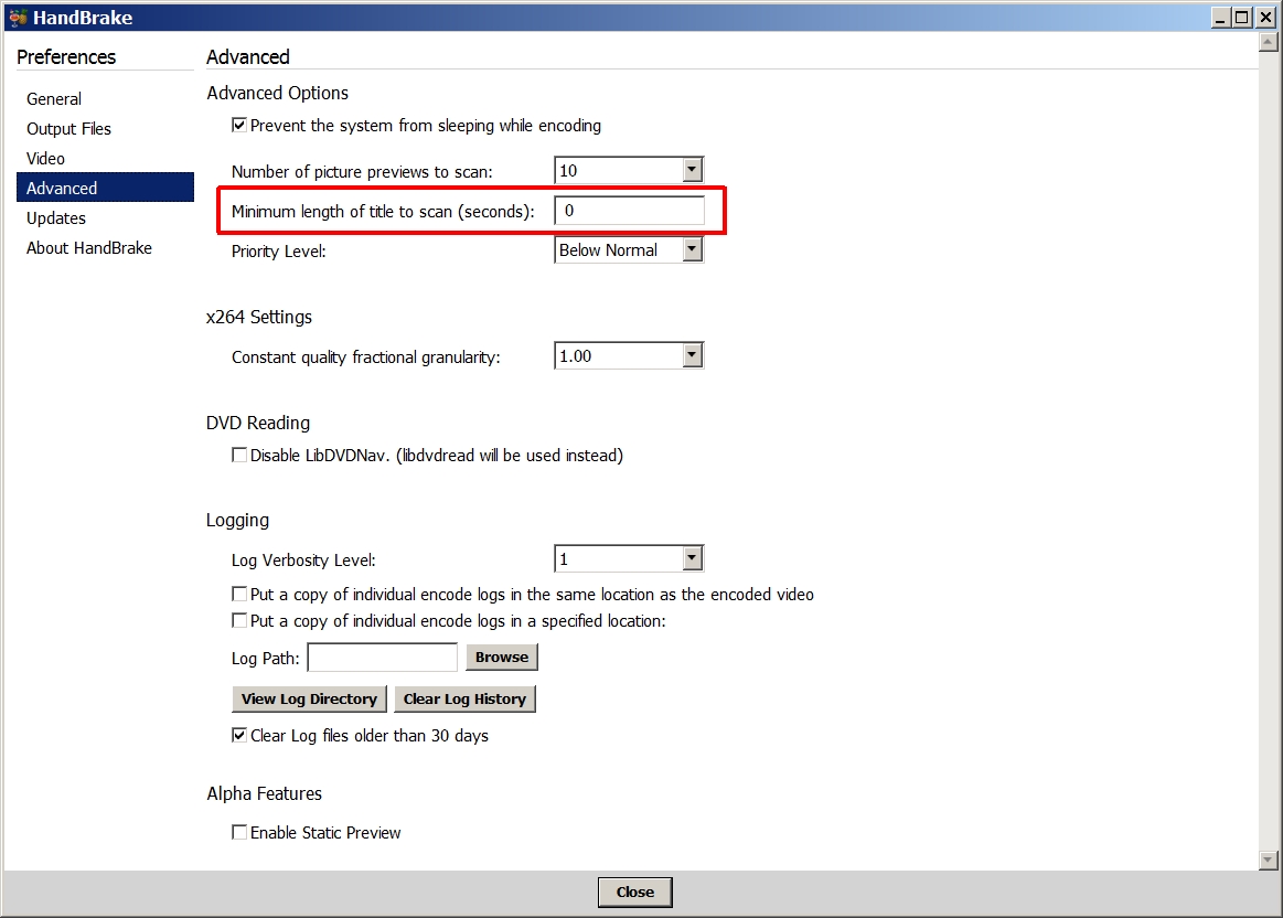

  5. Handbrake does have a setting that should allow a very small file size.
    Tools/Options/Advanced/Minimum length of title to scan (seconds):
    Set to 0(zero)

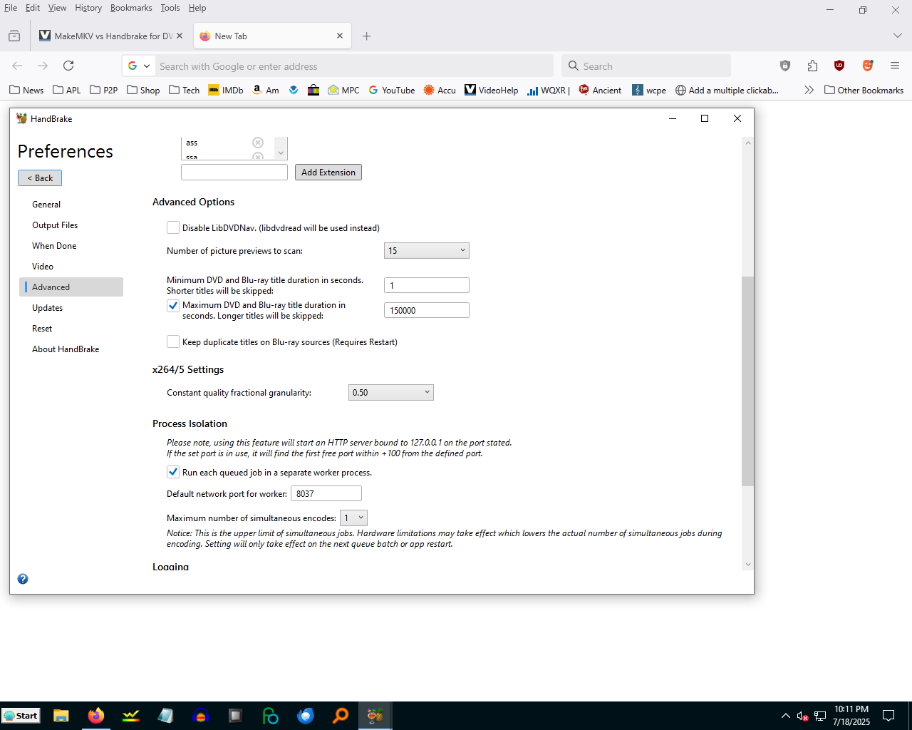

    I'm not seeing any change in the error message. Please post a screen shot of some sample settings in the right
    locations in Handbrake Advanced. I may have read it incorrectly, but here's my changes in my screen shot...
    There might be multiple issues and the problem is elsewhere but, like Jagabo said, there's been no change in DVDs in years.
    I'll give MakeMkv another spin...
Name:	handbrake advances.png
  10. My OS is Windows 7 32-bit & AFAIK i'm using the last working version of Handbrake for this OS.
    So it is possible the settings have changed.
    The setting in the red square is the one I suggested trying.
    If it is in your Handbrake settings.
    [Attachment 87864 - Click to enlarge]

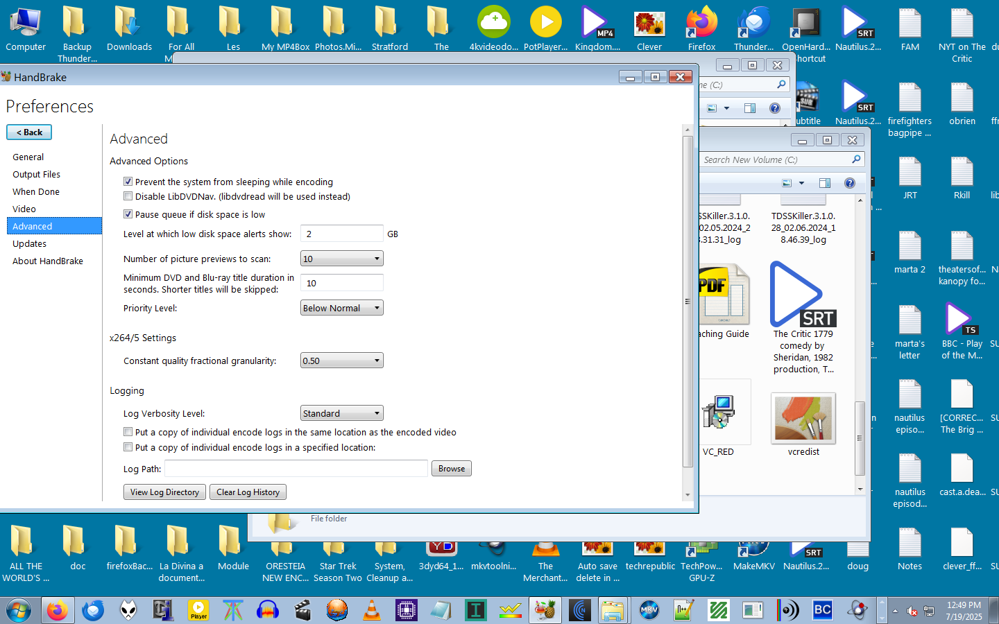

    I loaded a disc from the same group (a tv series) of DVDs in Win7 and it loaded fine. The DVDs are the factory ones.
    The screen shot shows my settings (untouched ever) from that HD.
    I think this is worth reporting as a bug to Handbrake.

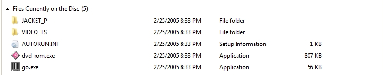

    @davexnet,
    This commercial DVD has just one standard vobset in the VIDEO_TS folder.
    Then the other normal files like previews & warnings.
    These are the extra files outside the VIDEO_TS folder:
    The AUTORUN.INF just opens the dvd-rom.exe.
    It has some images & a link to Sony web site.
    I couldn't get the go.exe to do anything.

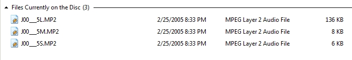

    The Jacket_P folder has .mp2 files that say audio but are just images.
    [Attachment 87878 - Click to enlarge]
    I do not believe they are the type files jagabo posted about.
