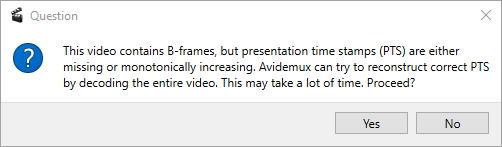

    Question, -fflags +genpts doesn't seem to do anything when enacted in FFMPEG, however if I open a remuxed .mp4 file in Avidemux, I get the following prompt:
    [Attachment 85384 - Click to enlarge]
    And it...works? Doesn't take long at all either.
    Is there a way to get FFMPEG to do this?

    I ended up just using Avidemux to do the entire process including appending multiple videos, which worked perfectly as long as I configured the .mp4 container to force DAR, and also is the perfect tool for trimming video without reencoding.
