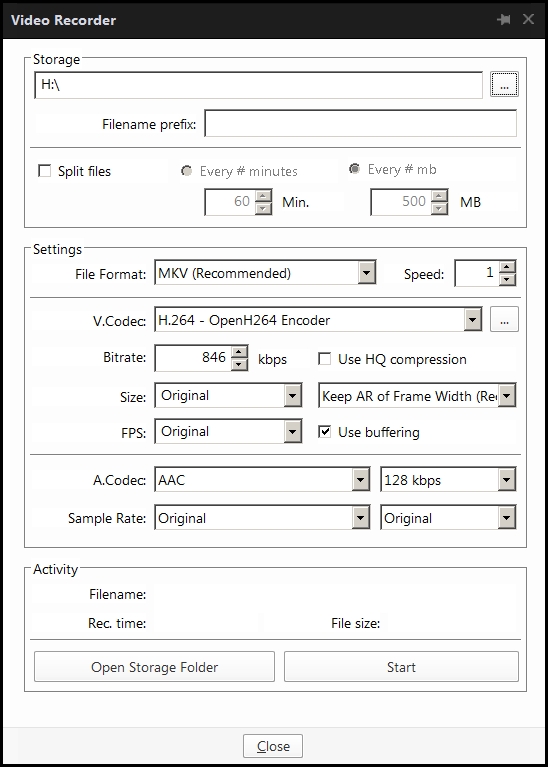

  18. Originally Posted by kusuku View Post
    Originally Posted by cholla View Post
    Pot Player Video Record mode will also convert this .rm.
    Real Media Player convert will also convert this .rm.
    How?
    Select the Pot Player pulldown in the upper left corner.
    Select option as in picture.
    Make the settings for the file you want to convert to.
    You have to let PotPlayer play the video as it does the conversion.

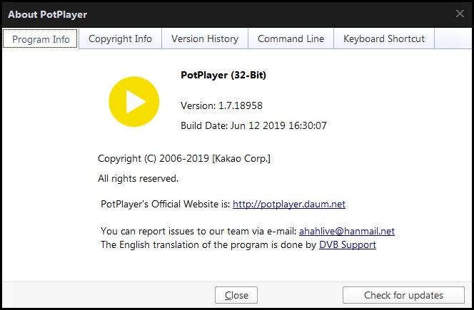

    I'm using Windows 7 32-bit & this is the version of PotPlayer I use:
    [Attachment 93900 - Click to enlarge]
    This is where the setting is:
    [Attachment 93901 - Click to enlarge]
    [Attachment 93902 - Click to enlarge]
