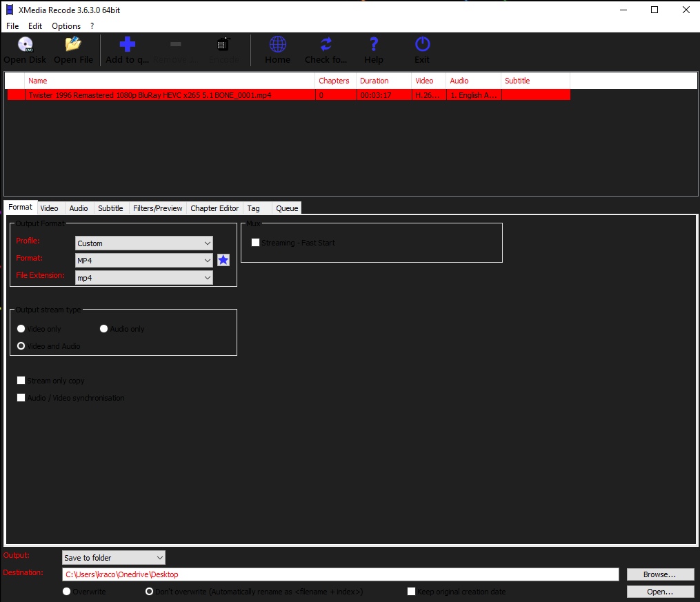

    if you set the format tab like this, does ac3 (dolby digital) show up on the audio tab "codec"

    I set XMR to Matroska.

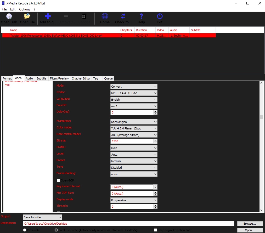

    Provide a sample video that shows this problem and some screen shots showing the settings from the
    format, video and audio tabs from XMR

  19. I have tried 5.1 and stereo and both result in distortion
    Windows 10, MPC-BE

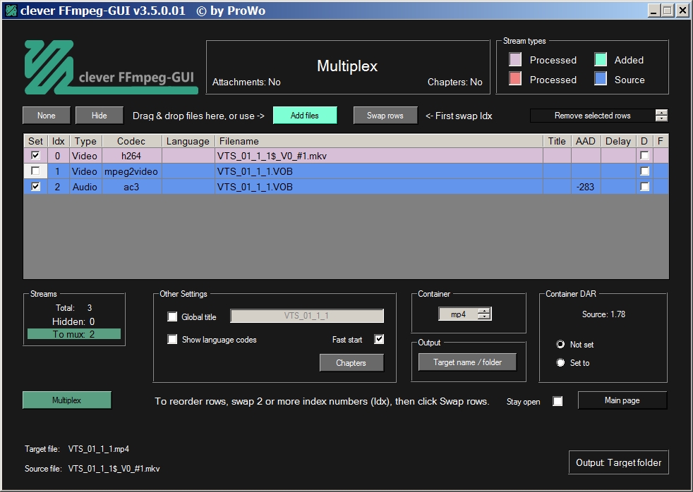

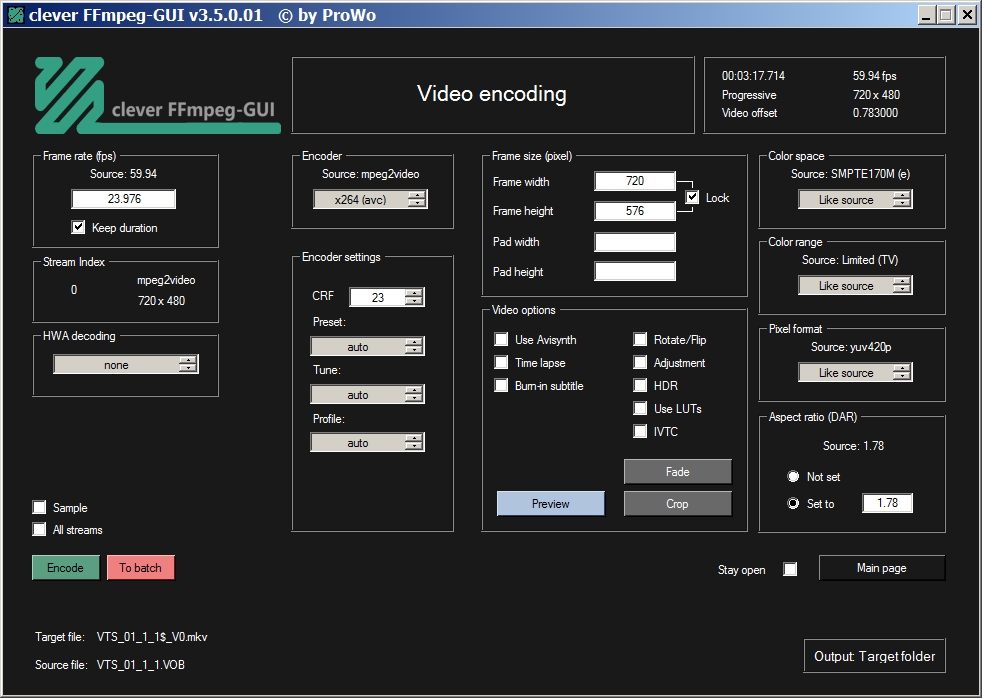

  26. This is a simple conversion from NTSC DVD to Pal DVD dimensions with Clever.
    Step-by-Step Instructions for Clever
    Load Your Video: Open the program, click the main window, and select the video file you want to resize.
    Access Video Encoding: Click the Encoding button on the main interface and choose Video.
    Set the Frame Size: Find the Frame Size section.You can manually enter both the width and height.
    Encoding: Choose your preferred video codec (such as H.264) and set the quality/bitrate settings on the right panel.
    Select Encode button. I used Lanczos then OK.
    Then select Multiplex Set the format. I used .mp4 for this file.
    Uncheck the old video.
    Use the new video.
    I used the same audio.
    I used the resolution for PAL DVD for this sample.
    [Attachment 92588 - Click to enlarge]
    [Attachment 92589 - Click to enlarge]
    This is the resulting video:
  27. okay my issue is that the multiplex doesn't seem to hardcode/burn in the subtitles. I assume that's the only way to add subtitles. If it's softcode only, then Clever isn't an option for me.
    Windows 10, MPC-BE
  28. In post# 58 the "Video Encoding" picture.
    The "Video Options" square>
    Select "Burn in subtitle".
    A window will open & you can either open the subtitle file or drop & drag it.
    Then hit the Encode button.
    Let it encode .
    Then "Main page".
    Select "Multiplex" button.
    Uncheck the original video.
    Check the new video & the audio.
    Select the "Multiplex" button there.
    You should now have a file with hard coded subtitles.
