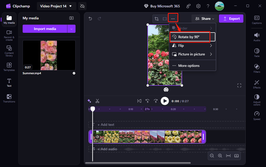

  5. There are free video editors available that can rotate the video. Windows 11 has a built-n one called ClipChamp. I have not used it and there are others on the software tab of the VideoHelp site. IE: OpenShot and VideoPad
    https://windowsforum.com/threads/clipchamp-windows-11s-built-in-ai-video-editor-youll-...ly-use.401356/
