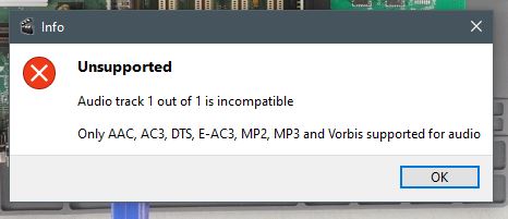

    Avidemux doesn't seem to like the sound track - it's PCM
    LosslessCut does work - with Resolve as well! (though it's also complaining about the sound track) But LosslessCut uses ffmpeg, so there must be a way to use ffmpeg directly as well!
    I'll explore LosslessCut though, thanks for now!
