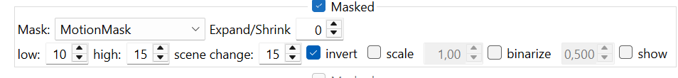

  20. Hi sorry for my delay. I have used mClean denoiser. Can anyone say if the effect is ok? Thanks.
  21. Yes, this is what mClean is expected to do.
    Kust as an idea, personally I would probably try using HQDN3D with an inverted motion mask and try tweaking the settings to a. remove noise, but b. keep the ball
    (script: https://pastebin.com/cbSZF6RJ)
    => it mainly is up to you to decide how much filtering it too much or too little
    Cu Selur
  22. Thanks for the script. For me it’s hard to translate it’s language to the hybrid gui. What settings should be in HQDN3D and how to set inverted motion mask and how to remain smooth motion of the ball?
  23. What setting to use, should be decided by you, yourself since it often is a question of what personal preferences.
    # denoising using HQDN3D

    To use masking you need to enable "Filtering->Vapoursynth->Misc->UI->Show 'Masked'-controls'. This allows to set masking settings next to the filters.
    I attached a screenshot of what:
    clipMask = core.motionmask.MotionMask(clip=clipMask, th1=10, th2=15, tht=15)
    looks like in the UI.
