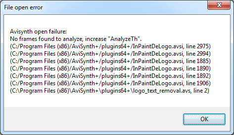

    Tried running this script with Automask:
    WLibAvVideoSource("G:\Test_Video_2.mp4")
    InpaintDelogo(mask="G:\mask.bmp", Automask=1, Loc="88,860,-870,-56")
    but got an error message when the script was run:
    [Attachment 74157 - Click to enlarge]
    So, try manually creating mask instead? When creating masks for InPaintDeLogo manually, how exactly is this done? So for this test video clip here, how to you create the appropriate mask to remove both the BBC logo and the text "Antiques Roadshow (1999)"?
    Thank you.

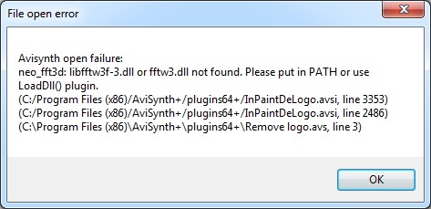

  6. Thank you very much for the comments, revised script, and the mask!
    I'm beginning to understand how this all works now.
    However, on running the revised script I'm getting an error message regarding "neo_fft3d".
    [Attachment 74181 - Click to enlarge]
    I have downloaded the file neo_FFT3D_r11.7z which contains both the 64 bit and 32 bit versions of the file neo-fft3d.dll.
    The 64 bit version of neo-fft3d.dll was copied to the AviSynth plugin directory - C:\Program Files (x86)\AviSynth+\plugins64+, and also copied to the system directory - C:\Windows\System32.
    The 32 bit version of neo-fft3d.dll was copied to the system directory - C:\Windows\SysWOW64.
    The error message mentions loading the dll file using LoadDLL(), but I get error message that this isn't a valid AviSynth command? This command doesn't seem to work anyway.
    This is the full script for running InPaintDeLogo -
    LWLibavVideoSource("G:Test_Video_2.mp4")
    InpaintDelogo( mask="G:\Testmmm.png", Loc="0,0,-0,-0", Turbo=-1, Inflate=2, Optimize1=0 )
    What is wrong here? Why can't AviSynth find the dll file?
    EDIT: Never mind. I got the script to run in the end by downloading both 32 bit and 64 bit versions of the file libfftw3f-3.dll. The 32 bit version was installed within - C:\Windows\SysWOW64 directory. And the 64 bit version was installed within - C:\Windows\System32 directory.
    The modified script now includes displaying the input and output videos side by side for easy comparison -
    A=last
    B=last
    StackHorizontal(A, B)
    Last edited by meeshu; 5th Oct 2023 at 04:42. Reason: Correct dll files installed, and script runs as intended

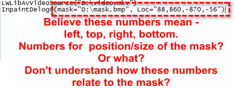

  7. I'm still studying and experimenting with the sample scripts and with other test videos.
    But I'm having difficulty in understanding the numbers contained within the LOC() parameter for the original script for InPaintDeLogo.
    [Attachment 74239 - Click to enlarge]
    What do these numbers mean? Dimensions of the mask? Location of the mask? Or what?
    I don't have a copy of the original "mask.bmp" for study.
    Would someone please clarify the meaning of these numbers, and how it relates to the mask and to the location/position of the logo and text to be removed form the original test_video_2.mp4 clip?
    Thank you.
    Location of a logo. Doesn't relate to a mask.
    Loc is similar to Crop().
  9. Thanks for the reply! This has cleared up some issues.
    However, assuming the Loc numbers are for left, top, right, bottom, then plotting lines at these offset number locations on a screenshot of the test_video_2, results in an area near the bottom of the screenshot, well away from the logo and text near the top of the screen!?
    This is obviously not correct as the logo and text are not contained within the area defined by the offset numbers.
    So, how do you interpret the numbers 88, 860, -870, -56 then?
    Thank you.
    Those numbers are just random example you asked, not related to any video.
    Loc="0,0,-0,-0" is from real script.
