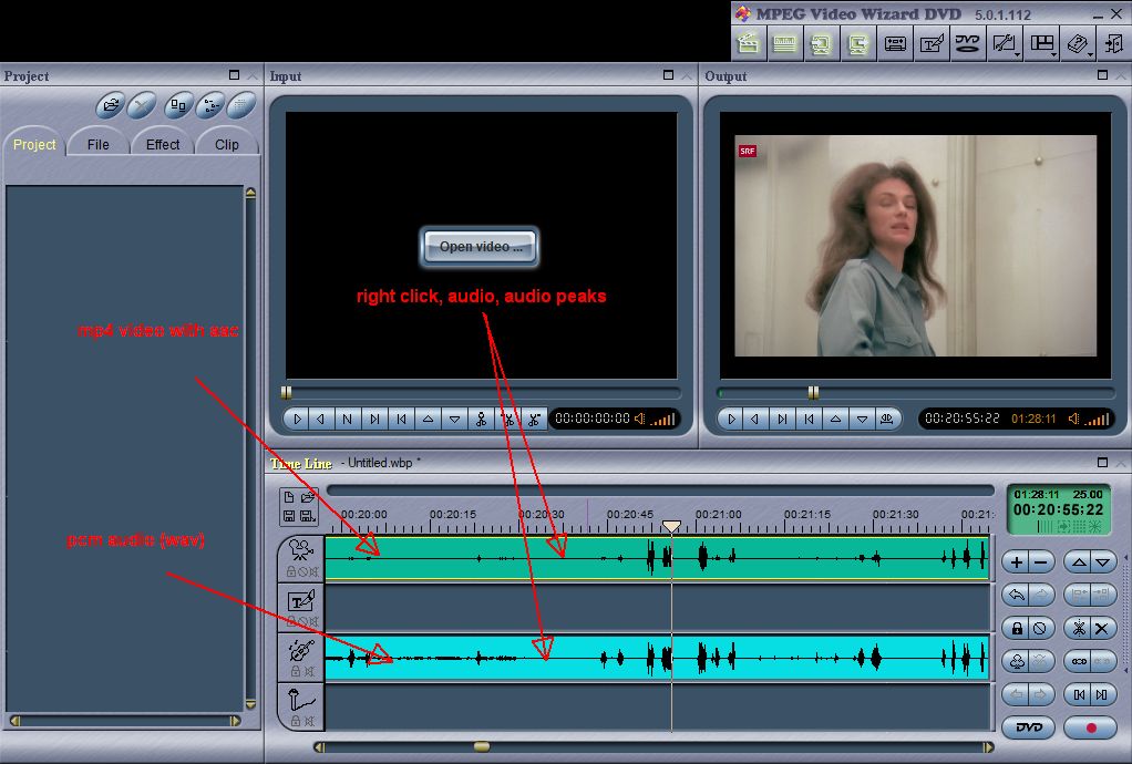

  6. Load both audiostreams in an audio editor (audacity) and compare the peaks.

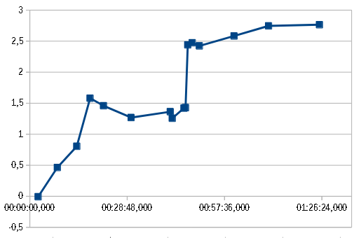

  7. OK, I did that manually (not very funny) for some prominent audio events (precision abt. 0.01s);
    y = delta between audios; see attachment.
    That's a strange progression...
    up to 50min a steep constant incline, then less slope for some time, then no incline.
    Each uniform incline could be repaired be squeezing.
    (Delta > 0.1s would be noticeable).
    But can all this be right?

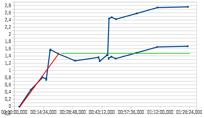

  13. I did more refinements on the delta graph (see attachment).
    Then did 2 corrections:
    - linear squeezing of the first 46 min
    - cutting 1s at the end of that sequence.
    When using that audio stream for the movie I encounter the expected effects:
    Linear squeezing leaves up to 1s desync (at abt. 24 min).
    Not-repaired sync at the second part (> 46 min) leaves noticeable desync (abt. 0.2 s) there.
    All this seem to point that there must be something wrong in the idea...
    "Non-linear desync"... what does it come from?
    Maybe there is a connection with the containers/ video codecs?

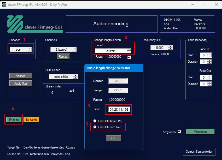

  16. I agree with jagabo.
    Most likely, the MP4 file has problems with the timestamps.
    I recommend converting the AAC file to AC3, but not from the extracted AAC file, but from the MP4 file.

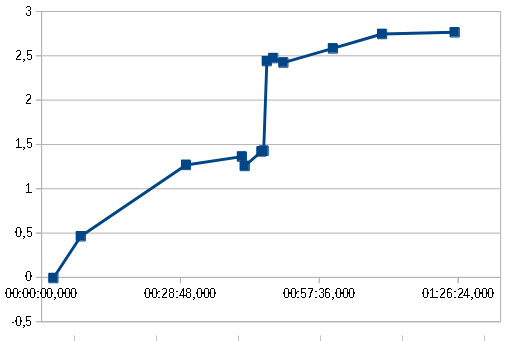

  17. Finally... I managed to create a (nearly) satisfying result (max. desync < 250 ms).
    To be sure I refined the difference graph some more (see attachment).
    Then I removed the 1s gap (step in difference graph) @ abt. 46 min.
    Next I squeeze linearly from beginning to point 5 (steep incline).
    That squeezing removes a difference of 1.5s (@ point 5) for the rest of the audio.
    This 1.5s offset is just about the average of audio > point 5, i.e. done!
    I wrote "nearly" satisfying.
    That's not only because of the unperfect desync max. of 250 ms.
    (That should be less than 100 ms at least).
    But most of all I would like to know what's the cause of all this.
    (Actually it's not the first time I came to this problem...).
    I can well image variable frame rate of a video might cause it (???);
    but both are cfr in this case.
    Moreover I had the idea that maybe the association of video/ audio
    in the container (time points etc.) might cause it (???).
    Knowing the cause it might be possible to restore audio perfectly and automatically?
    Doing a manual workaround is very cumbersome:
    First identify matching points in the two audios.
    Then having a look at the graph (I provided a libreoffice calc for that (see attachment)).
    If (!) the graph may be approximated by few piecewise straight lines (or steps),
    the desync may be lessened by using the lines for squeezing/ stretching.
    If in some cases there is really no better way than approximating,
    it would be nice to have a tool that builds the graph automatically from the two audios.
    Maybe even do the correction...

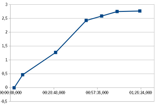

  25. My conclusion (hopeful for anyone's benefit):
    If the desync of two audios is very irregular (as in this case),
    desyncing precisely is very cumbersome "by hand".
    (Maybe it's possible with propriety and costy Adobe Audition or DaVinci Resolve).
    If the desync-pattern consist of nearly linear intervals and steps
    (see my graphics and the libreoffice calc file in the zip above),
    it might be acceptable to linearize (squeeze/ stretch) the intervals
    and to remove the steps.
    In my case I was kind of successful:
    [Attachment 89183 - Click to enlarge]
    2nd audio's start was matched before.

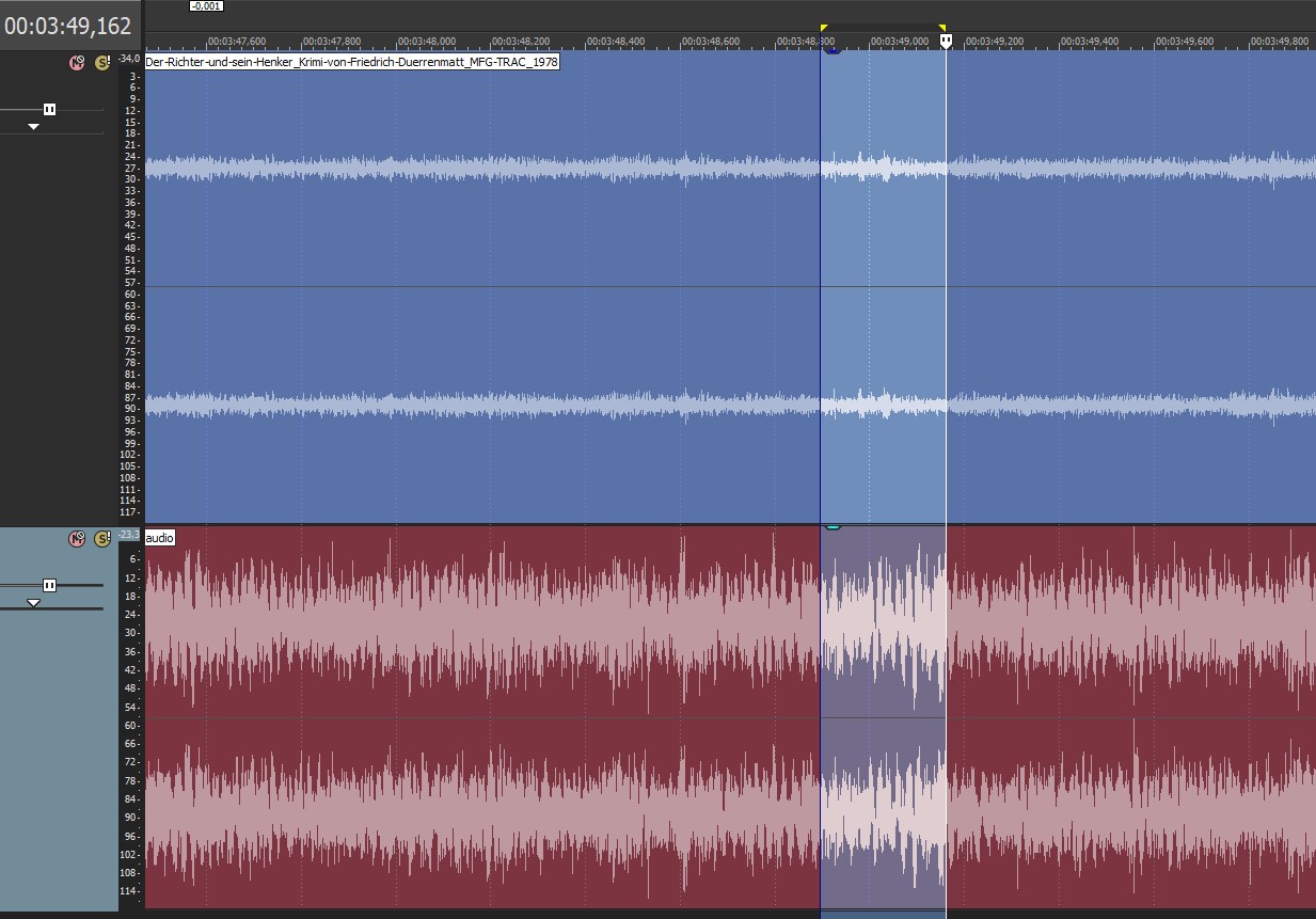

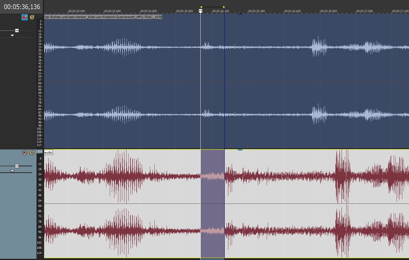

    This case was very complex.
    I used two tools:
    1) - clever FFmpeg-GUI
    2) - MPEG Video Wizard DVD 5.0
    The first step is to insert the mp4 video into 2). Then right-click on the inserted video, audio, audio peaks. The program remains open.
    Then I used 1) to convert the ac3 file losslessly into a pcm (wav) file, adjusting the length, and inserted the new wav file into 2).
    Right-click on this inserted wav, audio, audio peaks.
    Compare the peaks at the beginning and end and, if necessary, create a new modified wav file.
    Repeat this procedure until the peaks at the beginning and end match.
    The rest is fine-tuning in 2).
