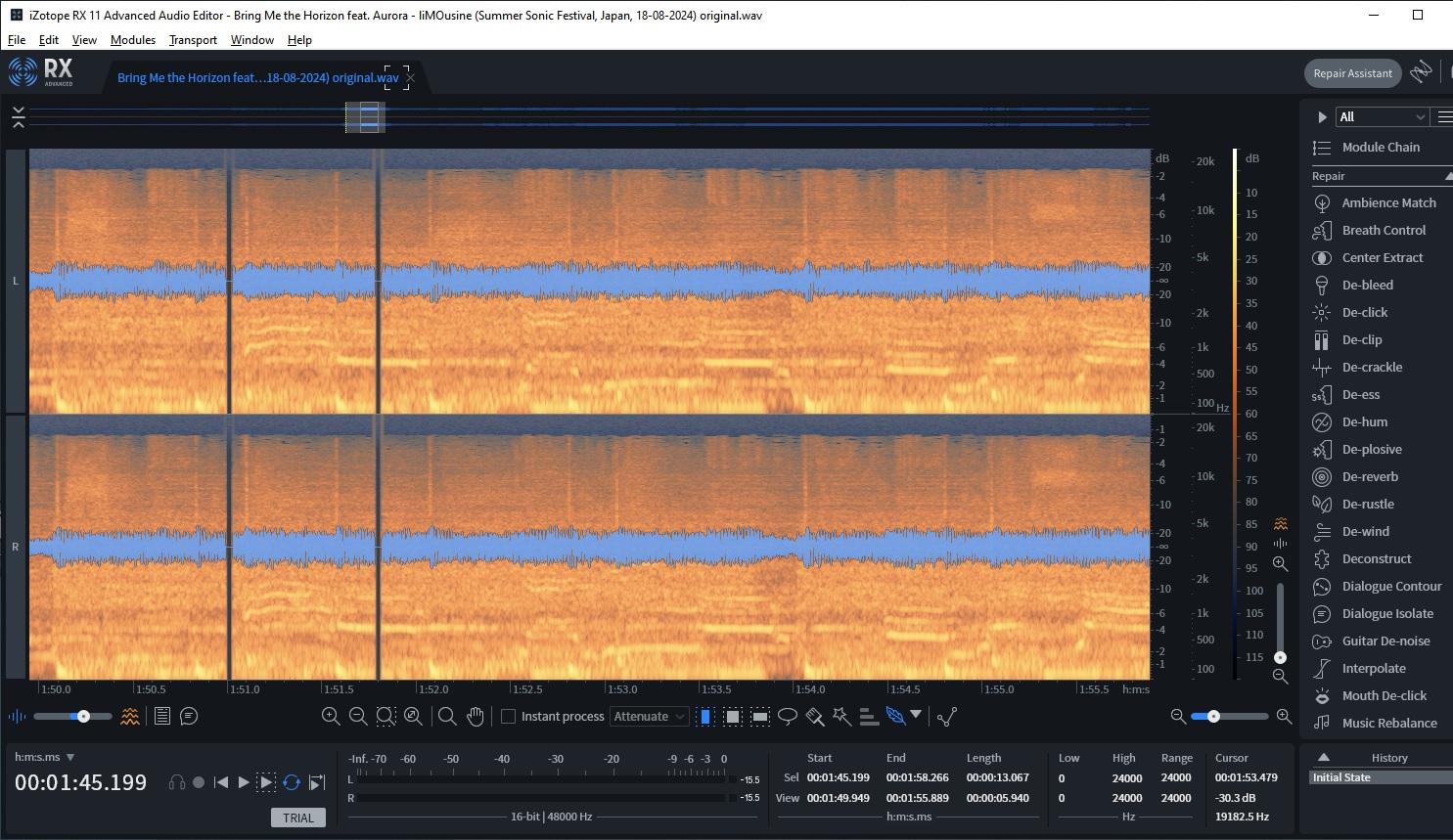

    I encoded a new file from Avidemux (using wav/pcm audio into MKV) and the resulting file is normal,
    no sync problems start to finish.
    The original audio in your source does have some drop outs (approx 35 milliseconds) that are audible
    but they do not affect the length
    Thanks. Perhaps those drop outs (the gaps that I mentioned when I imported the file in DaVinci Resolve) cause the audio to have a shorter duration when exporting with other programs. Is there a way to automatically fill in those gaps? Maybe with the app from your screenshot (iZotope RX).

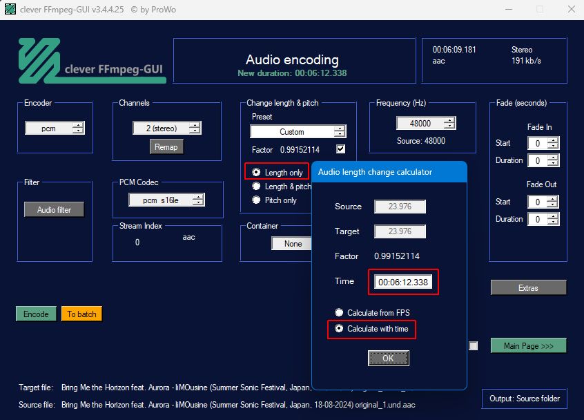

  11. You can use clever FFmpeg-GUI to create a correct (in length) PCM audio file.
    1) Load your mp4 from post #1, click main page, click extract streams, set the aac audiostream and click extract.
    2) Go back to source and drag the extracted aac into the window.
    Click main page, click encode audio stream, select pcm as encoder, set length only (at change length & pitch), select preset custom, set all like in the pic, click OK and click encode. Done.
    [Attachment 88352 - Click to enlarge]
    3) If you want to check the result, you can mux it with the videostream.
    To do so, click multiplex, drag your mp4 into the window, on the left deselect all streams, then select only the videostream and the new created wav (pcm) audiostream, set your output container and click multiplex. Done.
