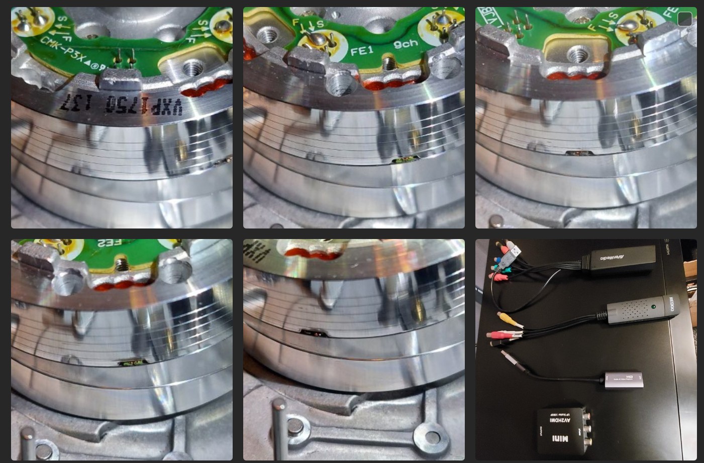

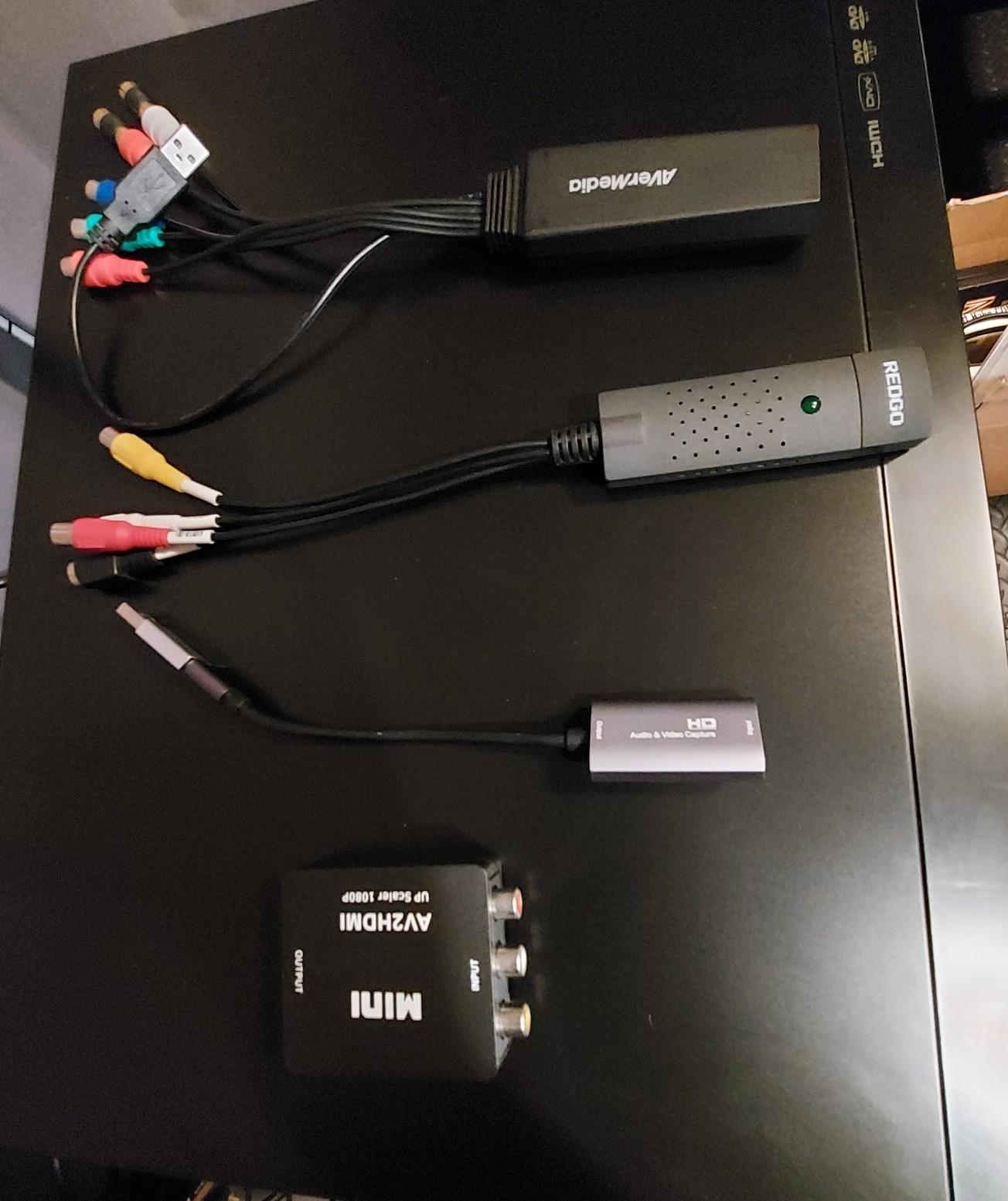

    I've been reading forums here and DF for years and finally took the leap and purchased a sought after S-VHS player and an inexpensive alt via a Vhs/DVD Recorder. With the combination of usb dongles, usb capture devices, a folder full of software, and scores of youtube videos; I'm having trouble etching out a workflow. I just want to make sure that I'm taking the right steps with the right stuff on day 1.
    First of all, I should start with my ultimate goal. My intent is to archive old VHS videos, rare commercials, and other findings primarily to youtube. Is there something else i should get, like an affordable elgato or avermedia capture hub? Do i need both the VCR and VCR/DVD Recorder?
    VHS Equiptment:
    Panasonic AG-1980 Desktop Editor VHS Recorder
    Panasonic DMR-EZ48V VHS/DVD Recorder
    Capture Devices:
    Mini- AV2HDMI RCA Upscaler 1080P
    Avermedia ET113 Dongle Component (YPbPr) to HDMI
    Guermok HD AudioVideo Capture HDMI
    Redyo S-video/RCA to USB Capture
    Software:
    OBS
    VirtualDub2
    StaxRip
    MPC-BE
    Brovicon
    I've noticed that the VCR/DVD Recorder via HDMI output is a better quality than the SVHS Player, and i understand that i should want to do post-processing on the pc instead of the Recorder doing it. I'm including pics of my VHS player's video heads, i worried they might need to be replaced.
    Any help and/or guidance would be appreciated! Hearing so many different takes on Youtube and the forums has me a bit overwhelmed.
  2. I think you're probably getting better results from the 48V via HDMI is because the digitizing cards you are using are generally considered poor, and the other thing is IF your AG1980 hasn't been refurbished yet (heavy recapping and mechanism rebuild), then I wouldn't expect it to perform well. I do full refurbs for $750 and it usually takes around 8 hours solid at a minimum even having done 50+ of them before. PM me if interested.
    You do also have a lot of dirt buildup right above the heads which is easily visible on your photos. That can be cleaned with the alcohol and paper method with 90%+ isopropyl alcohol. You can't really tell head wear from pictures though. I will say it's relatively uncommon for AG1980 heads to wear out as I think they used harder material than the JVCs did, even though most AG1980's have probably seen significantly more hours of use as they were used in more professional environments.
    My general experience is that the 48V produces a significantly softer picture than the AG1980, but if softer/more smoothed out image is your preferred "look" for the final capture, you may be ok with that.
    If you're curious what the difference would actually be for a different capture card and one of the tapes you've captured with your machines vs one of my refurbished AG1980's and the capture setup I'd normally use, you can send me a tape or two that you've already captured along with a flash drive containing your capture and I can capture a portion and send it back with my capture to see if you think it's worth changing/upgrading your setup or not. I'd do it for just the cost of return shipping.

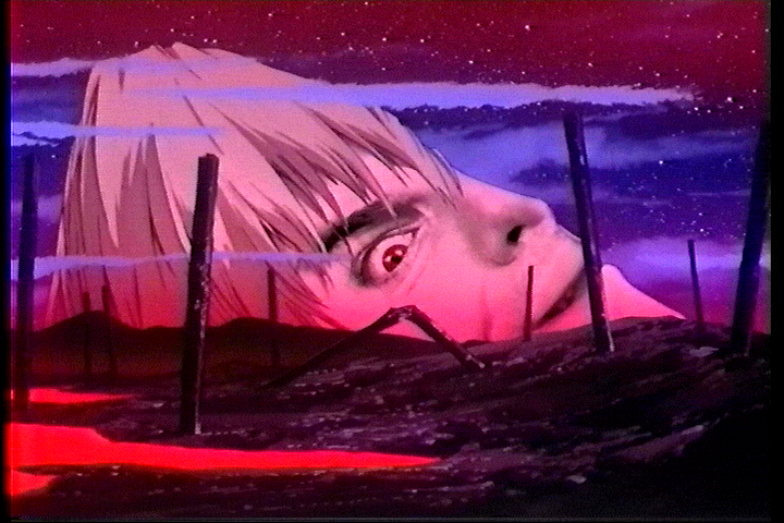

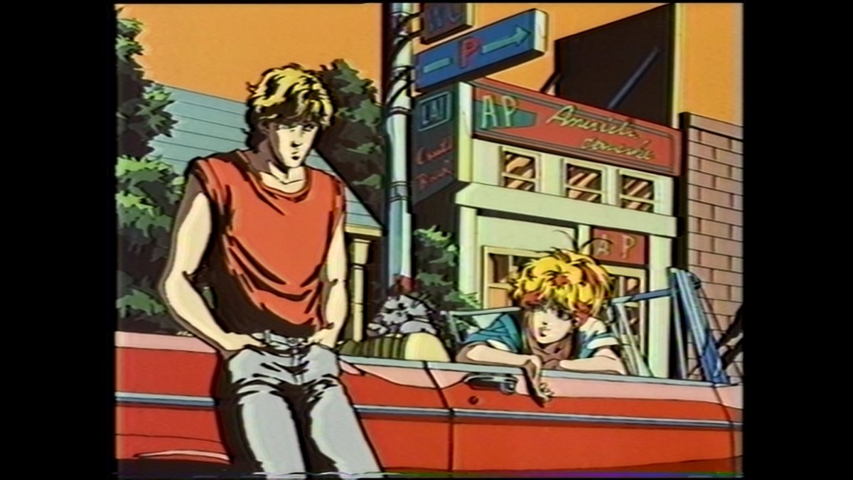

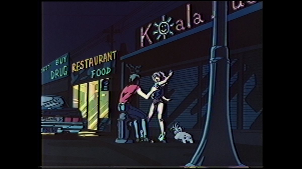

  13. New Guy On The Block The 14th Doctor's Avatar
    Feb 2025
    U.S.A
    [Attachment 88491 - Click to enlarge]
    [Attachment 88492 - Click to enlarge]
    Even with Twitter image compression you can see the ringing/ghosting around objects, it is subtle yes, but it is there. I can recover details in the shadows too just by adjusting the proc amp of my capture card so the blacks and whites are being captured within legal values, both images have the contrast boosted to 200% just to demonstrate.
    [Attachment 88493 - Click to enlarge]
    [Attachment 88494 - Click to enlarge]
    https://x.com/AndySaysHiBTW/status/1954081674842542155
    This Andy guy knows the right way around here, good for him!
    From my experience with LD-decode, decoding 100 minutes of lds on my Ryzen 7950x took about 3 hours, not good but not too bad.
    Well from my experience it took me an hour and 45 minutes to decode just 5 minutes and 40 seconds of a tape that somebody else archived because I couldn't be bother to keep it decoding the rest of the tape, and this was on a Lenovo Thinkpad P15v Gen 3 (AMD) Mobile Workstation Laptop running a AMD Ryzen™ 7 PRO 6850H.
    Also LaserDisc decode is wildly different from VHS decode, that has way more of a success rate and is the proper way to archive LaserDiscs, there is no argument on that front at the very least from what I've seen.

    Well those screenshots still show ringing/ghosting, it is more noticeable when it is up against a solid white object, like the eye or Yu-Gi-Oh card. That and these captures have a lot of ugly rainbowing. Same deal as when Slushy compared a Decode and traditional capture using his own Panasonic 1980.
    And yeah you are right, but what about captures that might have ringing baked into it (IE a copy)? Well I bet decode would amplify the already baked in ringing and/or halos, therefore making it even worse. Then you get results like this where it's double ringing.
    This is peak example of the phrase "Now that I see it, I can't unsee it"
