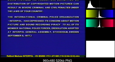

    Some more analysis.
    Levels are ok for both captures
    ATI USB 600:

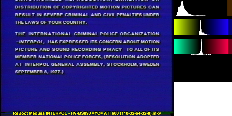

    VHS-Decode:

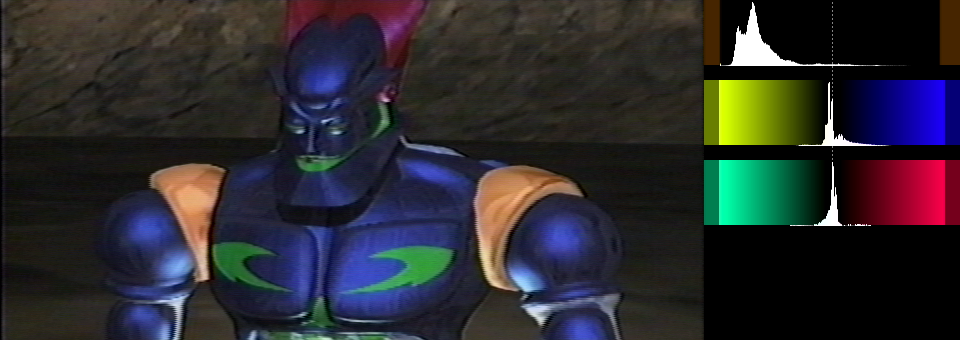

    As noticed yesterday, on the text portion of the video ATI USB 600 capture is better: https://imgsli.com/MzUwNjYx
    on the CGI part of the video VHS-Decode seems more defined, unless I confuse details with artifacts: https://imgsli.com/MzUwNjYz
    After applying some lite sharpening on the ATI USB 600 capture: https://imgsli.com/MzUwNjY0
    the text portion of the video ATI USB 600 capture is (obviously) even better: https://imgsli.com/MzUwNjY2
    while on the CGI part of the video I still see a more detailed image on VHS-Decode capture, in the background wall and in the tecture of the character, unless I confuse details with artifacts: https://imgsli.com/MzUwNjY3
    And finally, applying some sharpening on the VHS-Decode (not much improvement here, strange, I have to investigate): https://imgsli.com/MzUwNjc1
    the capture is still not able to make it comparable with ATI USB 600 capture for the text portion: https://imgsli.com/MzUwNjc3
    while on the CGI portion the improvement is not evident: https://imgsli.com/MzUwNjc4
    I see both samples have the same sharpness, The VHS-Decode (or tape-decode as they call it now since it captures different formats not just VHS) has an extra layer of noise which makes it look sharper but the actual video details are not.

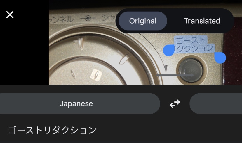

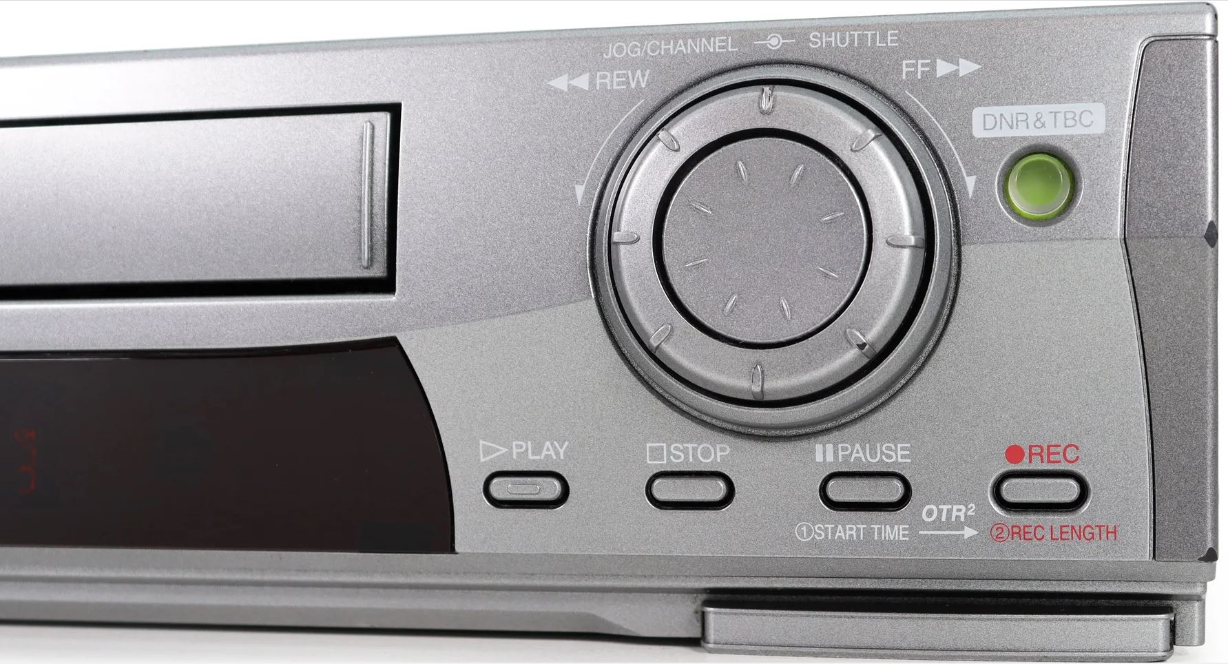

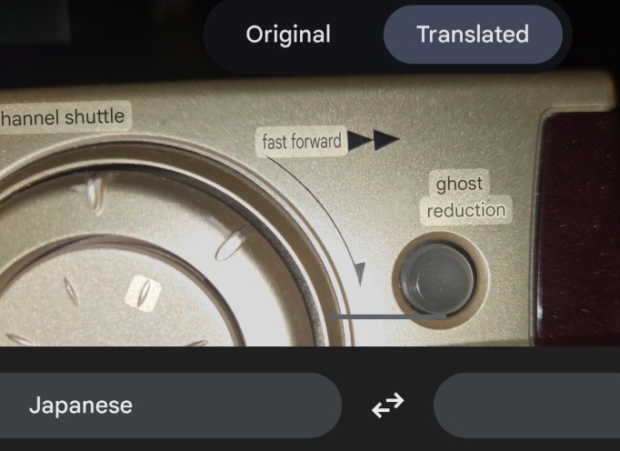

    That's another caveat, So the 629TBC is the main TBC? I was under the impression that it's an extra feature enabled by menu in addition to the regular TBC ON/OFF button on the front Panel, that's what I meant by not all VCRs have it, the VCRs with normal TBC. Appologies for not knowing how that VCR works.
  20. Formerly 'vaporeon800' Brad's Avatar
    Apr 2001
    Vancouver, Canada
    Oh, I see. No apology necessary, sir.
    Yes, it is the only TBC in this VCR. I previously showed its front panel button. It's not where you might expect.
    On the HS-HD2000U, the light-up green button on the right enables "DigiPure-style" DNR&TBC. On the HV-BS890, that same button is dedicated to the Ghost Reduction Tuner function.
    ゴースト
    リダクション = gōsuto ridakushon
