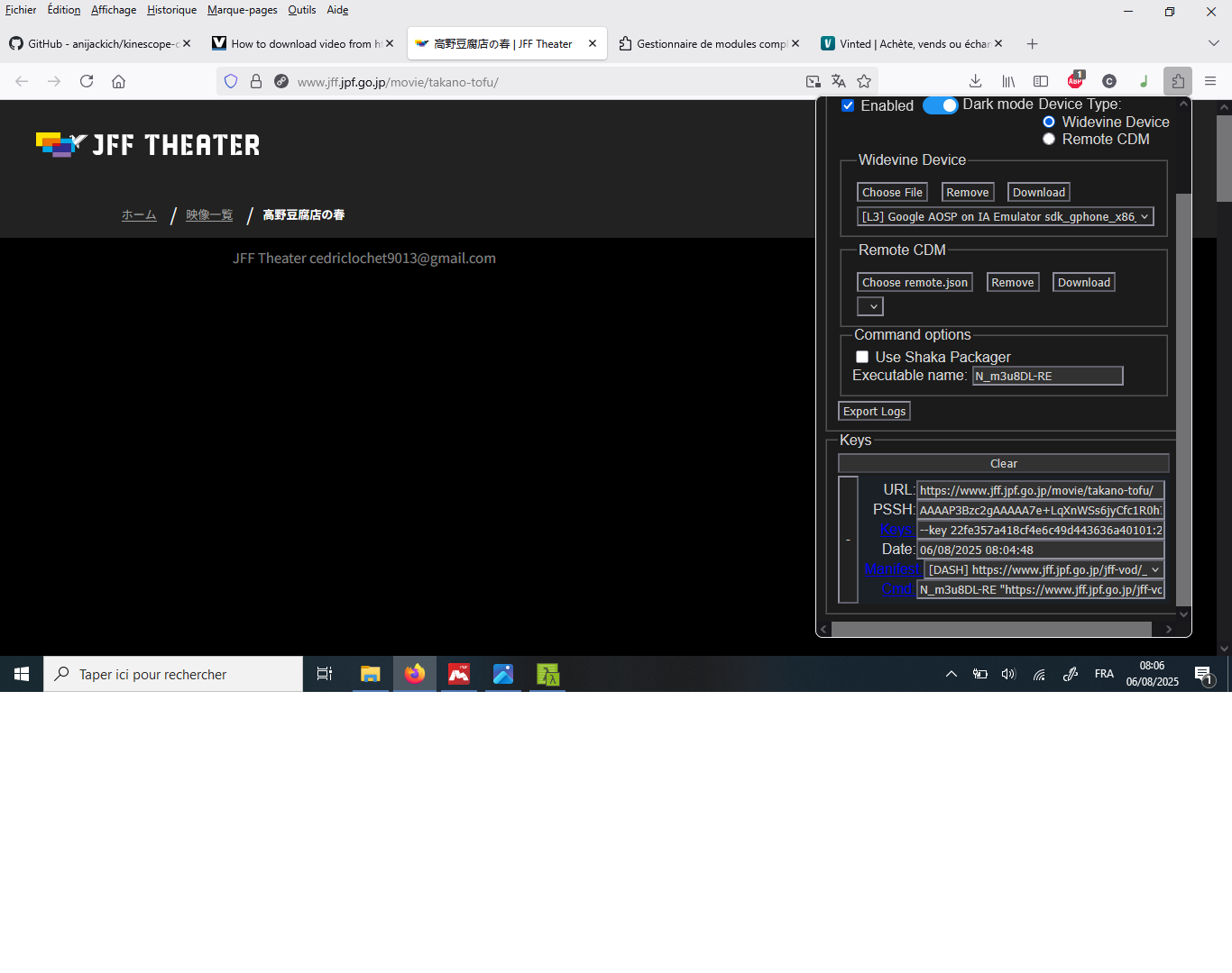

  2. WidevineProxy2 works for your site
    [Attachment 88157 - Click to enlarge]
    your key.
    --key 22fe357a418cf4e6c49d443636a40101:2ef33c172e1cfe967c716a210c6475a6
    Command to download
    N_m3u8DL-RE "https://www.jff.jpf.go.jp/jff-vod/_definst_/smil:D-bIPelz9z8G/Spring-at-Takano-Tofu-Shop.smil/manifest.mpd" --key 22fe357a418cf4e6c49d443636a40101:2ef33c1172e1cfe967c716a210c6475a6 -M format=mkv

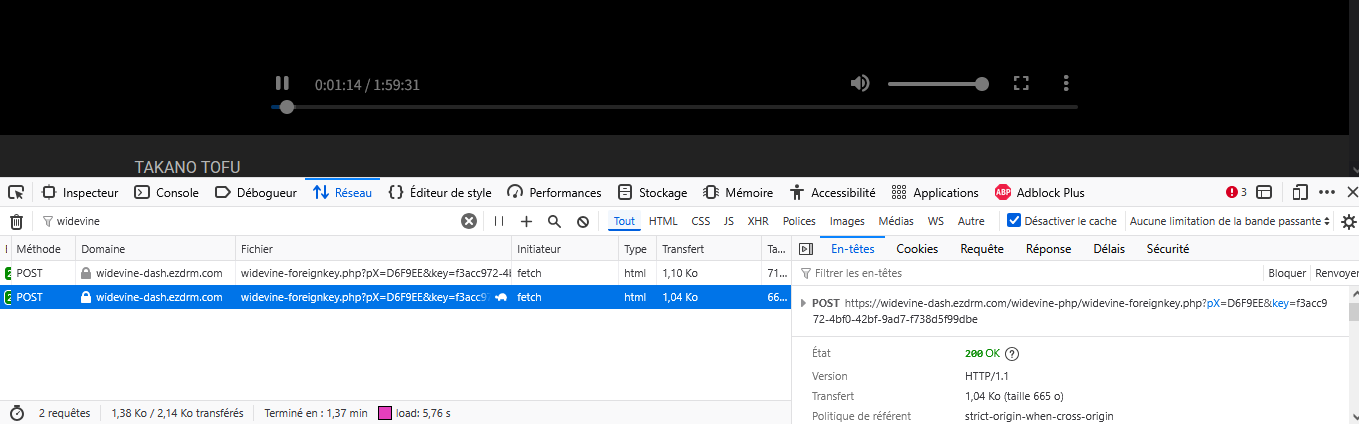

  3. maybe widevine proxy2 more suit for you.
    if you still want to find the license url, you can try to filter lic or cenc or wv
    never download from this site, but i remember the license url should similar with fod and hulu jp.
    like this:
    https://cenc.webstream.ne.jp/drmapi/wv/xxxxxxxxxxxxxxxxxxxxxxxxxxxx

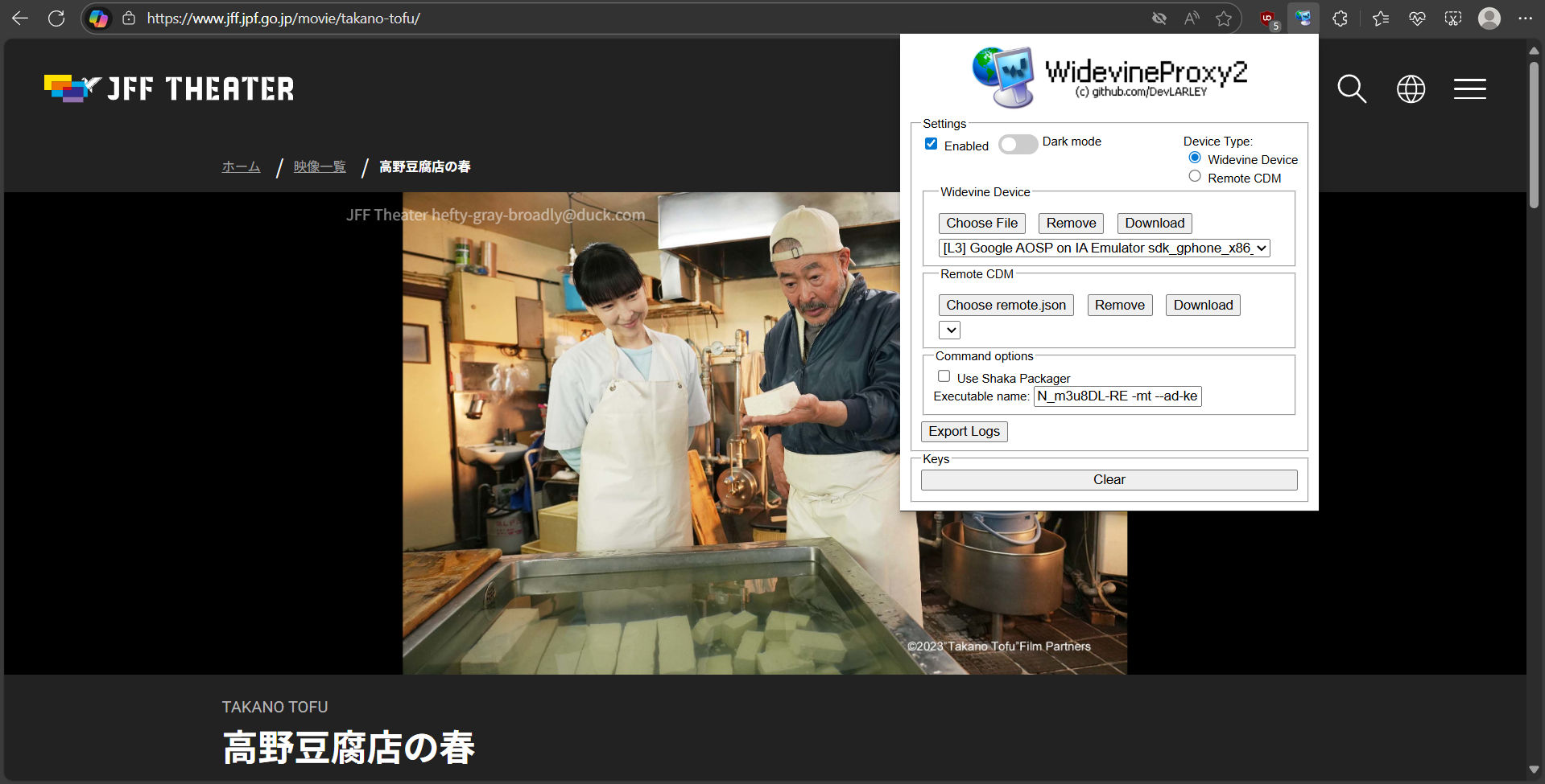

    I was also trying Edge+WidevineProxy2, but when I press the play button, playback does not start and nothing is displayed in WidevineProxy2's Keys.
    Edge+WidevineProxy2 works on other sites, so I don't think there is anything wrong with the settings, but do you have any advice?
    [Attachment 88161 - Click to enlarge]
    @shellcmd
    I can't find a URL that works with lic or cenc or wv.
  5. even if the video doesn't start, try several times...it works with Firefox.
    your licence
    [Attachment 88162 - Click to enlarge]
