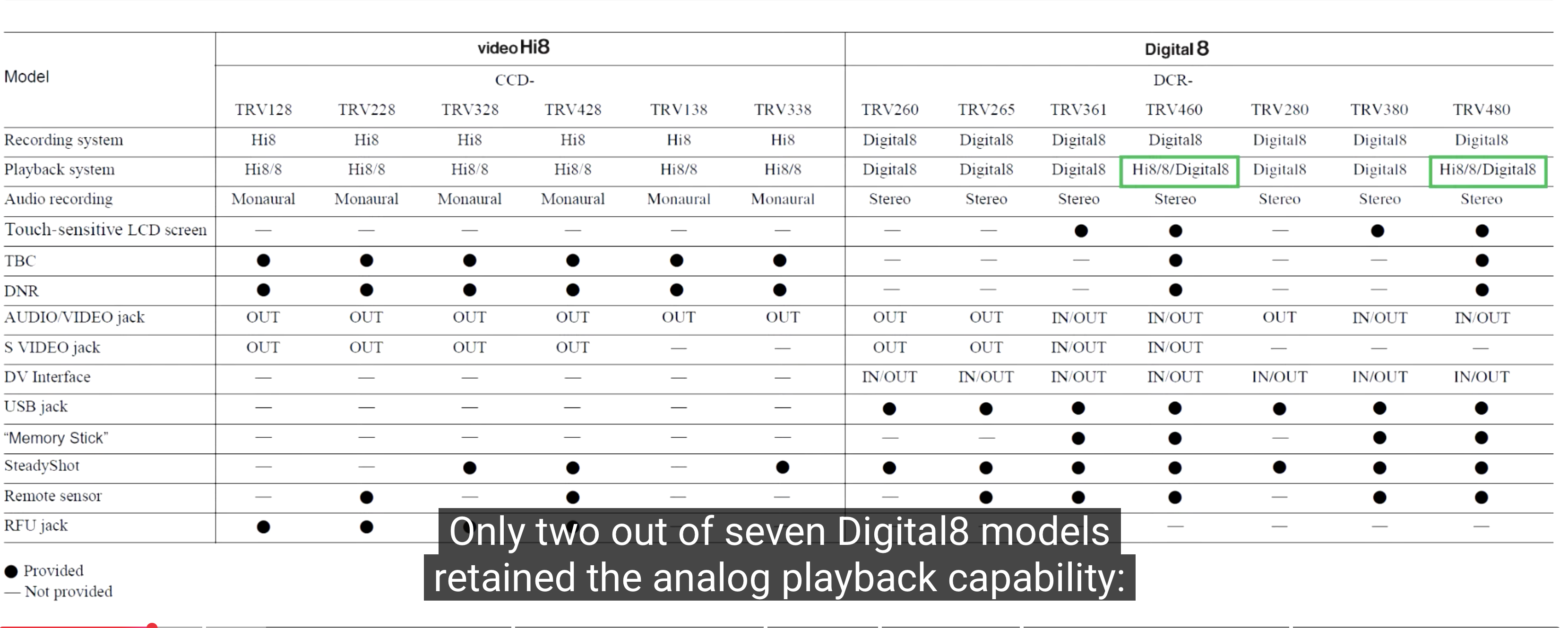

    [Attachment 87880 - Click to enlarge]
  25. Yes, only certain models are suitable for your purpose. You may also want to take a look here and consult the manual in case of doubt.

    There are a number of D8s that play V8 and Hi8 tapes:
    https://en.wikipedia.org/wiki/Digital8#Analog_recordings
    Less common are those with Analogue>Digital passthru and TBC.
    To that wiki list you can add/amend the TRV330E (PAL) and 340E (PAL): both have TBC, DNR and passthrough.

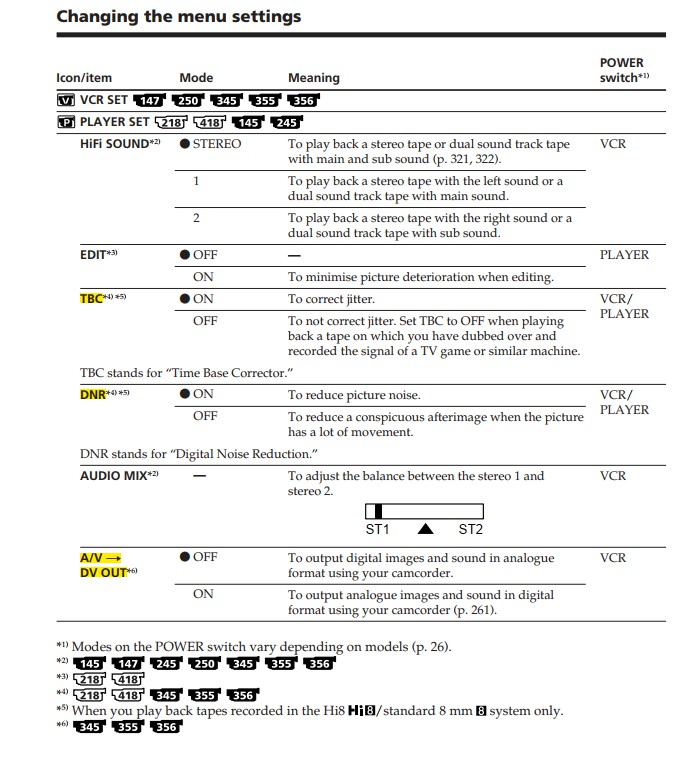

    The TBC/DNR and Passthru feature set for the 345E are described on this page:
    [Attachment 87894 - Click to enlarge]
    Most of the Sony manuals are similar so you can do a search for "TBC" or "DV OUT" and you should be able to work out fairly quickly if a particular model has the feature.
